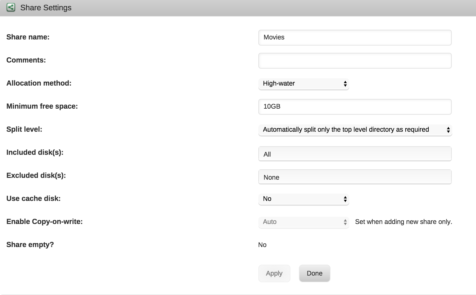

Then maybe a screenshot of how the share is set up.
OK thanks, i'll migrate some data to free up space tonight. I guess something must be configured incorrectly in order for me to have completely filled disk1, and have disk2 with 100's GB free. Will also post up share settings.

Screenshot attached as requested. If my understanding is correct, disk1 may fill again. I've free'd up some space on it, moved data back to the Movies share and its eaten straight into disk1.

From what I see you have the wrong split level. You have it set to only the top level, which means that only the Movies share will go to other disks. Other folders/files under will not be split. I guess the Split experts will correct me if I'm wrong. So try changing the split level to split the top two levels automatically.
You also have to be sure that the minimum free space is set to a size larger than the largest file you will copy to the share. I see you have 10GB and if you copy a file that is 12GB you will end up with a full disk.
Thanks for your input saarg. I read into split levels a few days ago. I think I've grasped it, and agree with your suggestion to split at top two levels. I'll give it a whirl tonight. Fingers crossed.
Hmm, probably a good opportunity to bump up that minimum free space a bit. Thanks again.
