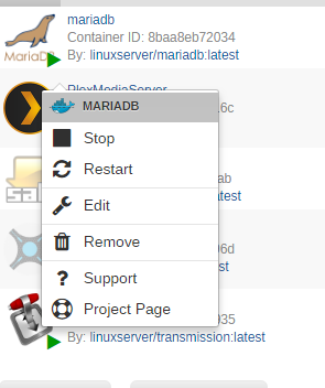

38 minutes ago, finchyboyz said:
when i setup Mariadb look for the console i dont seem to have the option, any points guys,seen this before?
That feature wasn't added until a later version of unRAID (you're on 6.1.6 accoring to your sig), I don't think the web console was even available in your version.
However, you can still bash into docker by using SSH into unRAID (via putty etc), then type:
docker exec -it mariadb sh
This is the same command you can see in the popup window title in spaceinvaderone's video when the web console is launched, from there you should be able to follow the rest of the video.
Edited by tjb_altf4
