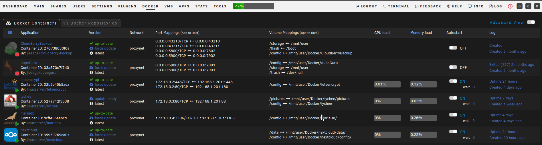

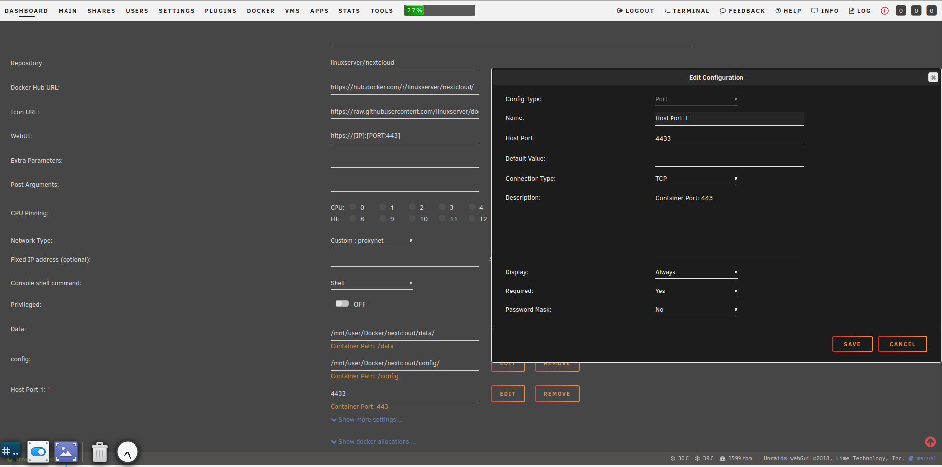

Can someone help me out with the configs for setting it up with a subfolder with the letsencrypt docker? I have tried spaceinvaders video but his only focuses on subdomains  and the proxy conf examples iv tried using but just pulling my hair out trying to get it to work.
Share this post
Link to post
Did you check the instructions in the nextcloud config sample?  Do you have a custom network interface defined?  (docker network create forletsencrypt0).  Is nextcoud using that network interface in the container definition?
Share this post
Link to post
no I do not have a custom network interface defined. I have used the default with all my other services which are working fine in nginx.. mainly bridge mode. I havenlooked at all examples.
Sent from my ONEPLUS A3000 using Tapatalk
Share this post
Link to post
It can work without the custom interface but you'll have to modify the template, give it your server IP.
Please start by reading the template, all the info is in there as to what you need to modify to get it working.  If you can't figure out how to put your server's IP in there, I can help.
Share this post
Link to post
thanks I apreciate your offer to help. I just wanted to make sure, do you mean the let's encrypt template?
Share this post
Link to post
Posted (edited)
So I have looked at the template and doing some more research I came up with this but when trying it in an incognito window I get a refused to connect error.
https://hastebin.com/ozefovuriv.php
Edited by mkono87
Share this post
Link to post
config.php looks good.  I'm not sure 'trusted_proxies' => ['letsencrypt'] is essential, it was missing from mine :P
for the site-config, change
proxy_pass https://$upstream_nextcloud:443;
to
proxy_pass https://192.168.0.50:446;
and you can remove: set $upstream_nextcloud nextcloud;  That's the bit that needs the custom network interface.
Share this post
Link to post
to
Changed but I get this error
Internal Server Error
The server encountered an internal error and was unable to complete your request.
Please contact the server administrator if this error reappears multiple times, please include the technical details below in your report.
More details can be found in the webserver log.
I checked the logs and server is ready   I do get a warning about increasing the max buffer hash size.  I dont think that would cause it to not run though
Share this post
Link to post
I wouldn't be too worried about the hash size.  Do you get the same behavior if you try to connect with https://192.168.0.50:446 ?
Do you see the connection go through in the letsencrypt access log?
Share this post
Link to post
Yes it still the same after changing it. In the activity log is shows
 [10/Jan/2019:11:43:19 -0500] "GET / HTTP/1.1" 500 304 "-" "Mozilla/5.0 (Windows NT 10.0; Win64; x64) AppleWebKit/537.36 (KHTML, like Gecko) Chrome/71.0.3578.98 Safari/537.36"
IM guessing its a problem with nextcloud config?   I was trying with a subdomain too but was getting the same error
Share this post
Link to post
I got it working!!   There was a missing $ infront of CONFIG in nextcloud php. Such a small error but finally fixed. Now that I know it works. Im going to try to work on using my actual real domain.

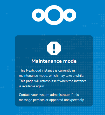

Hi Everyone,
hope to get some help here.
I tried to do an online update in the nextcloud container from version 15.0.0 to 15.0.1. I think that was a bad idea, because my nextcloud gets stucked and it shows the following page only:
Hope someone can help me with that.
Thx for your help!
Edited by b0rgi85
Share this post
Link to post
10 hours ago, b0rgi85 said:
Hi Everyone,
Thx for your help!
I'm new to Nextcloud, but you will likely need to manually remove it from Maintenance mode, you can do that from the console (select docker drop down down, then console).  Would be something like this from the /config/www/nextcloud folder.
sudo -u abc php occ maintenance:mode --off
or from any path
sudo -u abc php /config/www/nextcloud/occ maintenance:mode -off
Then restart docker and troubleshoot from there I suppose.  Did you backup before upgrading?
