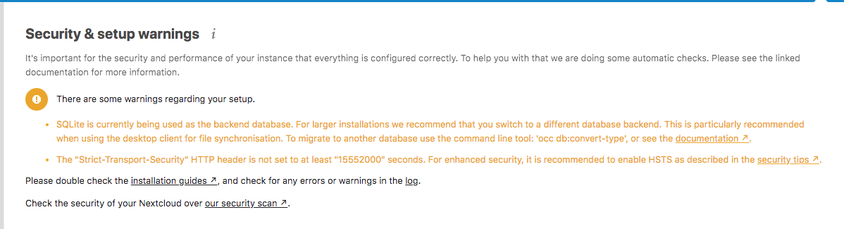

Hi, I have an issue with warnings and I'm stuck with one of them, I read back a few pages and found the fixes and ran some database comands all good. Added trusted proxies to config.php and deleted default file. rebooted and had the following warnings.
729054621_ScreenShot2019-11-21at16_34_13.thumb.png.83223b5b42c1c6dc92987b42ca08cfc5.png
So I edited the default file to add:
add_header Strict-Transport-Security "max-age=15768000; includeSubDomains; preload;";
And then the webpage won't load, I get 502 bad gateway?
My default file:
default.txt
Hopefully I done something daft?
My default file:
Also I still have a big problem when people download files from the server with the docker image growing to 100%! It kills some of my other dockers!
Cheers,
Tim
For the warnings then delete the `default` file and it will be recreated on container restart.  Alternatively take a look at the version on Github.

1 hour ago, MothyTim said:
Yes did that?
How are you reverse proxying it?

1 minute ago, MothyTim said:
Letsencrypt docker.
OK, so identical to me, so things that might be worth looking at that could potentially be different.
config.php
nextcloud reverse proxy conf
Nextcloud version (I'm on 17)
Default file
If you post I'll check, but I need a bit more to go on.

6 minutes ago, j0nnymoe said:
502 usually means it can't communicate with the container. Is the nextcloud container still on the same custom bridge network as your letsencrypt container?
Hi, yes the Nextcloud container is on the same custom network as Letsencrypt container.
Share this post
Ok, well looking at your default file, you've added a ton of stuff that isn't need. Confused why you've done that and used the subdomain proxy config aswell. You need to use the supplied default file, you've removed the bit that tell's nginx to use the proxy-conf.
Ok, well now I'm confused, because I haven't added anything except the line that seems to break it!? I deleted it as per instructions and it re-created itself, I then added
to try and fix the warning message?
Share this post
Link to post
Wait, penny just dropped, I've been looking at the default file for letsencrypt, not nextcloud itself.
Get into the container of letsencrypt and see if you can `ping nextcloud`.
Share this post
Link to post
umm now even more confused because its working!!! And the warning has gone! I did reboot the server earlier, so maybe that did it!? Thanks anyway for all you help!
