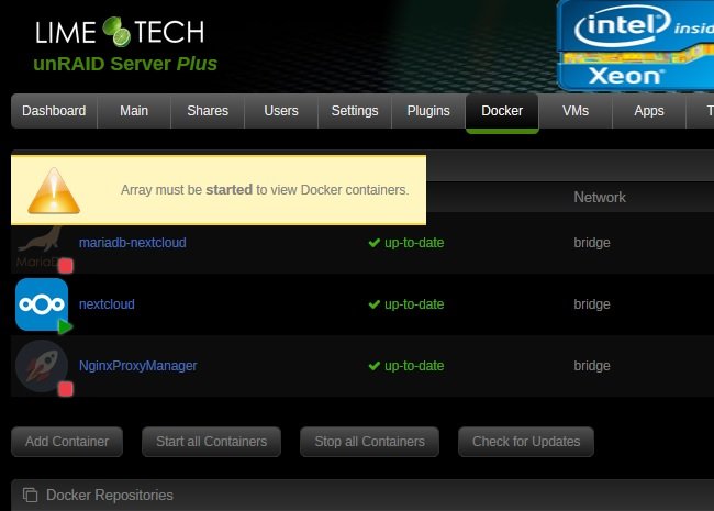

Hi all...
My Nextcloud docker keeps freezing and is completely unresponsive. When I try to access the WebGUI it is not accessible at all and when I try to shut it down it never stops.
I tried "docker kill nextcloud" which didn't help.
So far the only way I have managed to shut it down is to close all my VMs and other dockers... then stop the array (which even when stopped still shows Nextcloud as running)... then to power off the server - which always fails, possibly because the unresponsive Nextcloud docker is hanging it... so I have to force a shut down which means a parity check is invoked every time I reboot.
I am running UnRAID 6.5.0 as whenever I have upgraded past here I lose remote control of the machine and as its in a datacenter its 120 mile round trip to pop in and fix it!
Any thoughts on where to start looking would be appreciated before I build a Linux VM to host it ;-)
