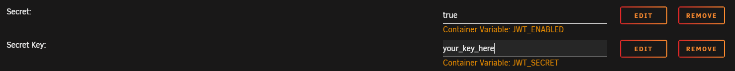

On 2/16/2020 at 4:09 PM, alturismo said:
when i used the external official onlyoffice doc server docker with lsio nextcloud i added those 2 variables from the readme
THANK YOU!!!!
This was bothering me for a while. i couldnt figure out how to link the password with the secret.  i resorted to putting http authentication on the reverse proxy config for onlyoffice. I like this option better because i dont have to enter in a second password anymore.
Link to comment
