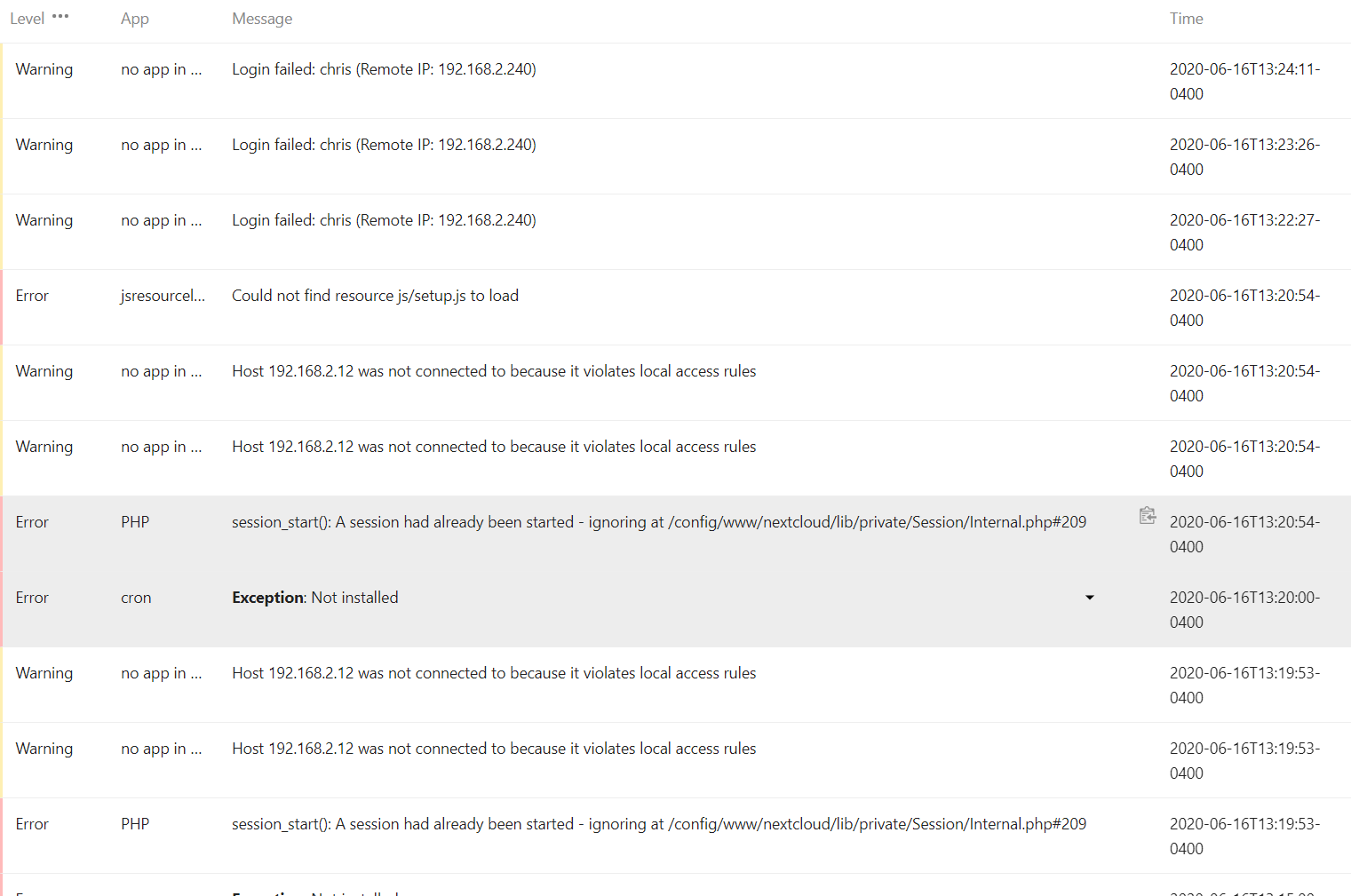

OK this is driving me nuts, I cannot figure out why Nextcloud is so slow.  It takes about 30+ seconds to load each page, accessing it from inside my own network.
To try and solve this: I wiped my entire nextcloud installation, including all folders and appdata, even the database in MariaDB.
I then created a DB and installed the container fresh.  It completed setup, but it's still slow as molasses.  The CPU/Memory do not even blip and all other containers function fine, so I know it's not a performance issue.
The Container log is fine - no errors.  The only errors I see in Nextcloud's "logging" tab in Setttings are:
I tried googling and the only thing I came across is bruteforce protection, but I checked the DB table and it's empty, so that's not it.
Can anyone help me figure out what the issue is? I've seen a few other posts that mention this without a resolution.

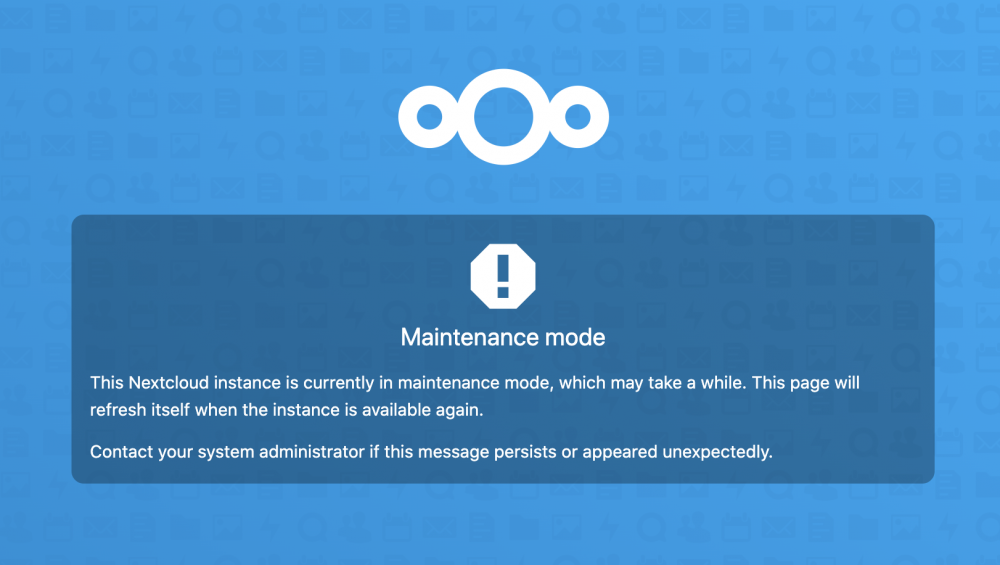

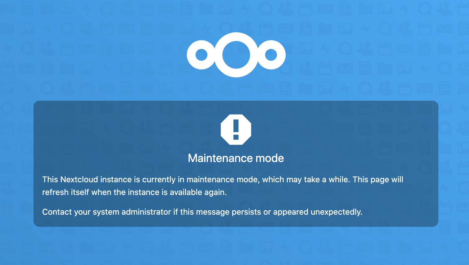

31 minutes ago, damnshaneisthatu said:
Attempted to update some apps, it errored out, and now I can't get into Nextcloud. Nothing sticks out in the logs.
733349607_ScreenShot2020-06-17at9_10_48AM.thumb.png.dd08f6bf3bf706112a3b8a1d595bfc00.png
Look at some of the previous comments about how to get out on maintenance mode. I had helped someone not to long ago on this issue.
