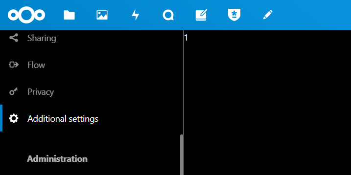

Secondary issue I'm having is the Additionaly Settings page is missing under Settings. Prints a '1' on the page.
This is not the Additional Settings that is under Administration.

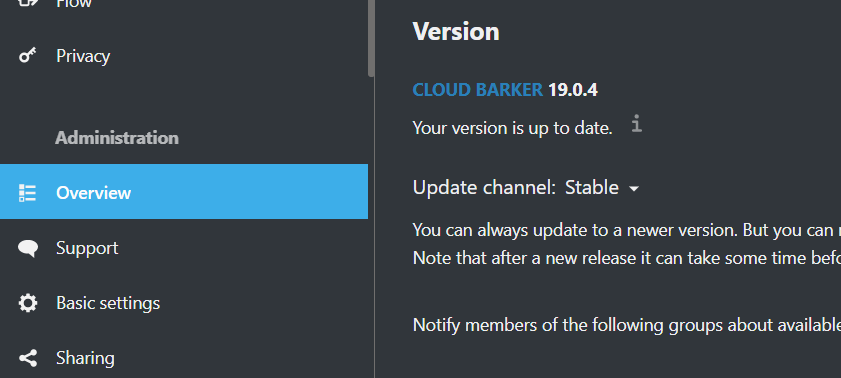

From within the NextCloud Settings > Administration > Overview page, does it have any option to update present? I was stuck on 17.0.1 as well, but I had to install the Upgrade to version 18.x, then 19.x (Current Stable Release Available). If you don't see any option to upgrade, can you post a screenshot of what you can see?
I'm not the same person but I came here to ask the same. This is what I see:
I think it may be that you have the standard update channel selected. When you place it into Beta, do you see anything different?

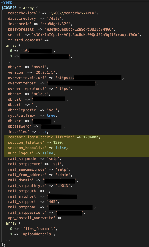

I am moving data from my Qnap to Nextcloud.  Very large transfers keep generating: "Error when assembling chunks, status code 504"
I have spent a day investigating, changing conf files and I still get the error code.  I am unclear if the issue is size or limit of browser time session.
Using Big Sure OS.
Chrome Browser to log into nextcloud and transfer files from both local drive and Qnap.
UnRaid Server:
AMD Ryzen 7 8 core
16GB Memory
Dockers all installed 11/16 - latest:
miriadb
nextcloud
swag
I changed:
appdata>nextcloud>www>nectcloud>config>config.php - the highlighted code I added:
1448229423_ScreenShot2020-11-19at10_21_35AM.thumb.png.67f7da39dc89e9bae8f7b2cc78929955.png
I can provide log files if needed.

Using Big Sure OS.
UnRaid Server:
AMD Ryzen 7 8 core
16GB Memory
miriadb
nextcloud
swag
I changed:
