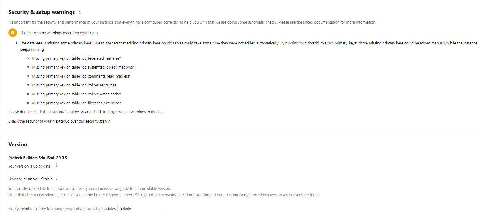

Updating to 2.0.3 wasn't really smooth though. There were errors throughout the updater process but I manage to install it. However, how do I solve the warning given by Nextcloud? Hopefully I am not the one seeing this only.
The command is in the first line of the warning...
occ db:add-missing-primary-keys
Also this have nothing to do with the updater errors you got on the updater.
On this version NC made some changes in the database, and need to add some primary keys :)
Edited by skois
Thanks for the quick reply, you guys are awesome. I am still quite bad at terminal command. I just copy and pasted the command line just now, it stated command not found. Could you list down all the command line I should execute? Thanks.
You probably tried to execute the command on the unraid's terminal.
This command is to be runned bu the nextcloud container. So,
click on the NC docker and click console. Run the mentioned command there
Your feedback solved my problem. Yeah I was running on the Unraid terminal instead of the docker console. Thanks for the helps!!!
