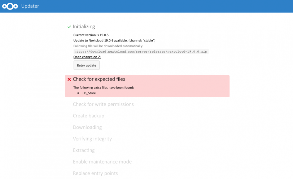

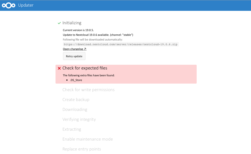

Hi There thank you for all the work you have done with this Nextcloud Docker. I am trying to do the update like I have done previously through the updater and I keep running into this issue can anybody help and advise what I am doing wrong.
Cheers
    Martin
Cheers
    Martin
You must be using macs in your network?
Go to your nextcloud data folder and delete all the .DS_Store files you find.
Its temp files created by macs, safe to delete.
Here is a script that will do it for you
Hi Thanks for your help found it hidden in the program files doing the update now
