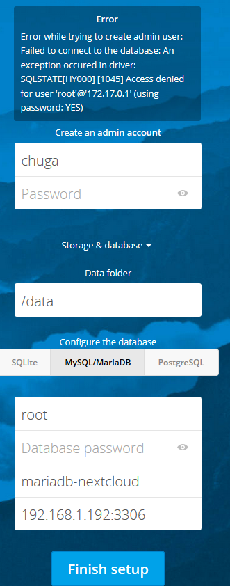

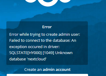

Hi - just installing nextcloud for the first time, using the guide in the original post
I get all the way to configuring nextcloud via the webgui and get this error when clicking "finish"  (see attached screenshot).
both dockers seem to be installed correctly- not sure on how to troubleshoot this.
thanks

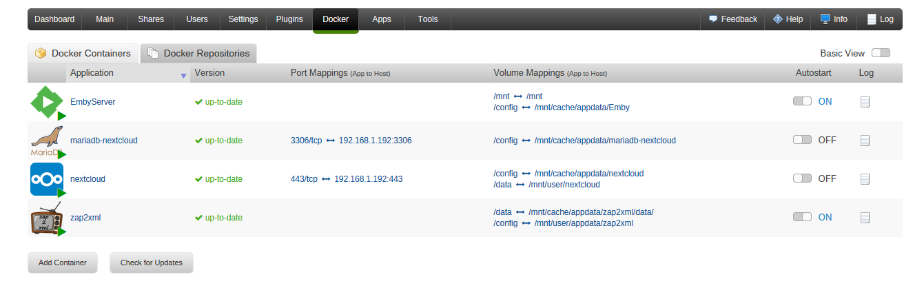

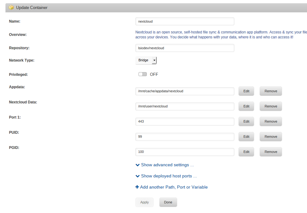

Be helpful if you showed us the rest of that screen
see attached for whole screenshot
for database name I have tried "mariadb-nextcloud" which is the name in the mariadb docker, and and just "nextcloud" which is used in the install guide.
thanks
thanks

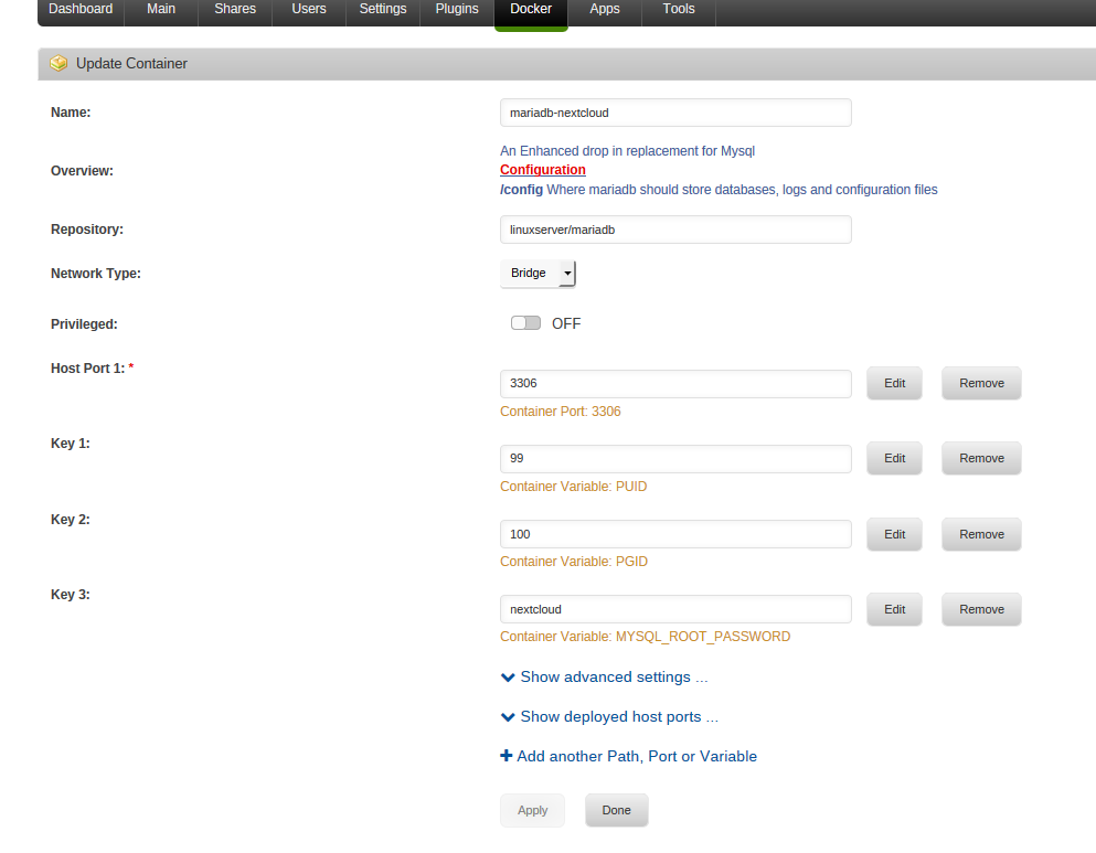

The name of the database can be anything you want it to be.  You sure you're putting the correct root password in?  Should be the one in the docker template for Mariadb

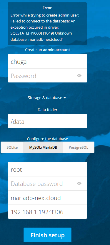

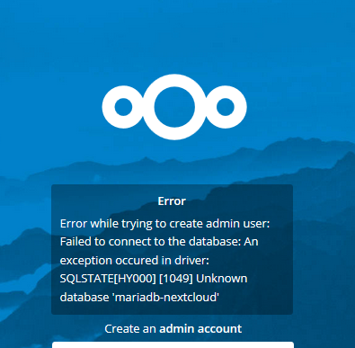

Hi - just tried a new password in mariadb docker and then the nextcloud webgui again - it did not work but the error is slightly different
(see attachment)
thanks
and nextcloud docker image attached - previous post ran out of image room.
I think Nextcloud has changed the setup a little bit from when I last tried.
Remove the container & image for nextcloud and mariadb, wipe you nextcloud appdata and wipe your mariadb appdata (assuming this is solely being used for nextcloud) and pull it again.  Gonna have to get down and dirty with the terminal I'm afraid.
Edit custom.cnf and do two thing.  Change line 118 to read
binlog_format=mixed
and change line 124 to read
bind-address=0.0.0.0
Then in a terminal in your /config folder
chmod 644 custom.cnf
Then
docker exec -it mariadb-nextcloud bash
mysql -uroot -p
Enter your root password for MariaDB
CREATE DATABASE IF NOT EXISTS nextcloud;
GRANT ALL PRIVILEGES ON nextcloud.* TO 'root'@'localhost' IDENTIFIED BY '$MARIADB-ROOT-PASSWORD';
quit
Restart the MariaDB container.
Then pull the nextcloud image and at the setup screen use
root
$UNRAID-IP:PORT
Database name will be nextcloud.
to connect to it.

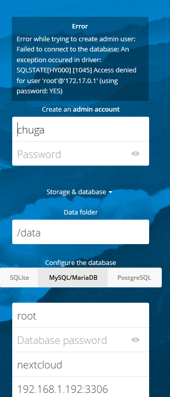

I think I got through it ok - however still an error when configuring nextcloud (see attached)
not sure if I made a mistake configuring mariadb or something else.
thanks

Nah, sorry, it's my fault, trying to do several things at once and db management isn't my forte I'm afraid.  I've updated the instructions above.  Try from the beginning.  I've just tested it and it works (I think....)  ???
still no luck :)
see attached for error...
thanks

Post your mariadb log...
see attached-  copy pasted from the docker log file (let me know if this is not correct log, not sure where to find it)
mariadb_log.txt
I've just tested the instructions I posted, they definitely work.  I used clean nextcloud appdata and clean mariadb appdata and up and running within a couple of minutes.
