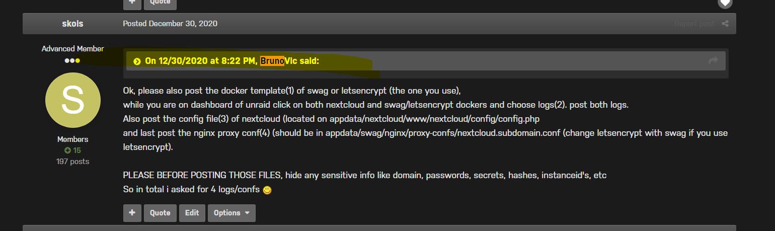

you may should consider the art you ask for help, starting with help NOW ... we are here mostly for fun and a helping each other as users ...
about your logs

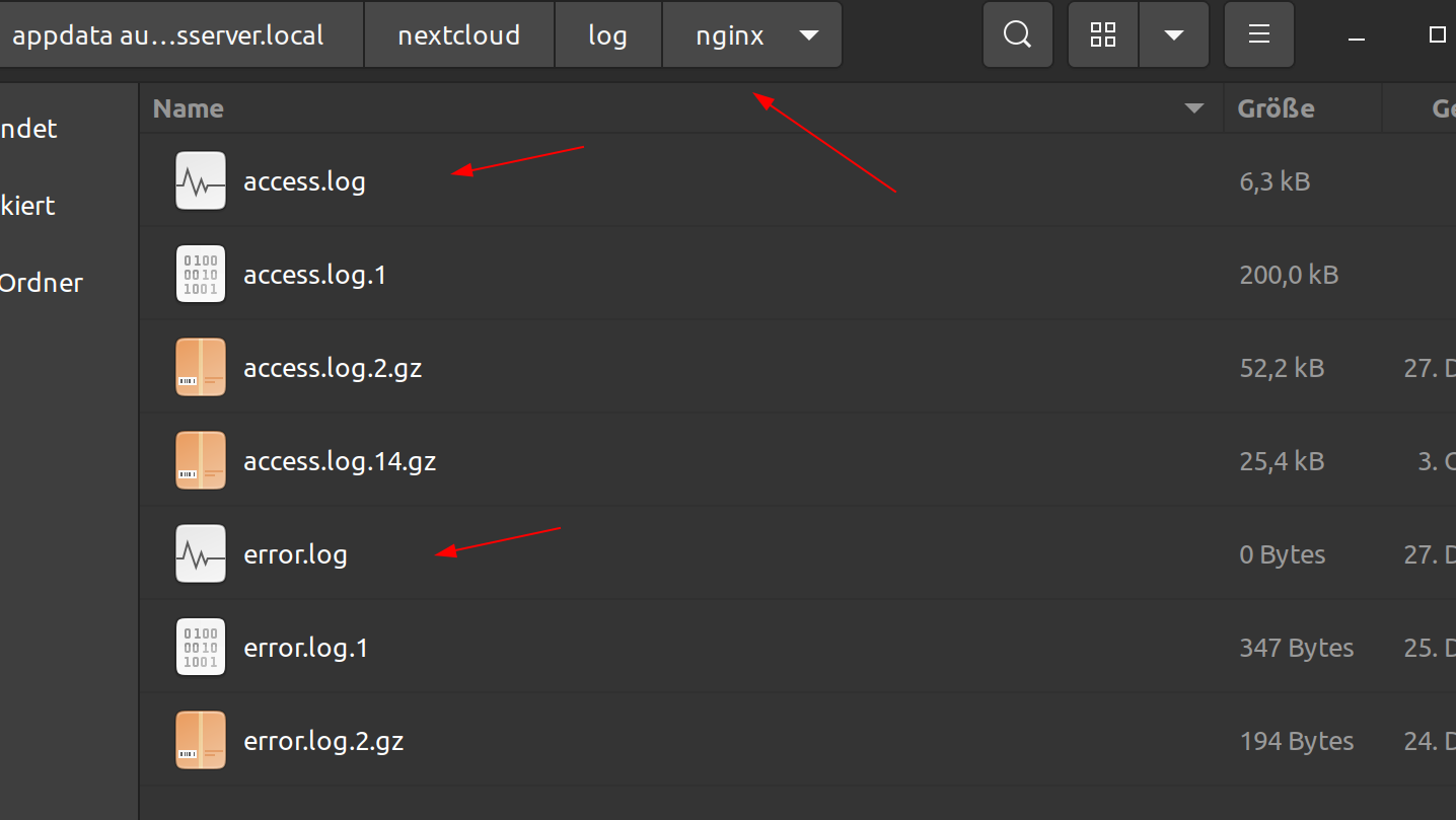

- click on the docker symbol, click LOG ... a window appear with the current running docker logs
- about nextcloud nginx logs, take a look at your appdata folder, log, nginx ...
these are startpoints where to look, as nextcloud usually is running behind a reverse proxy, thats why there was the question about the reverse proxy logs, but you should find them yourself, and thats about it from me to help with this kinda attitude.

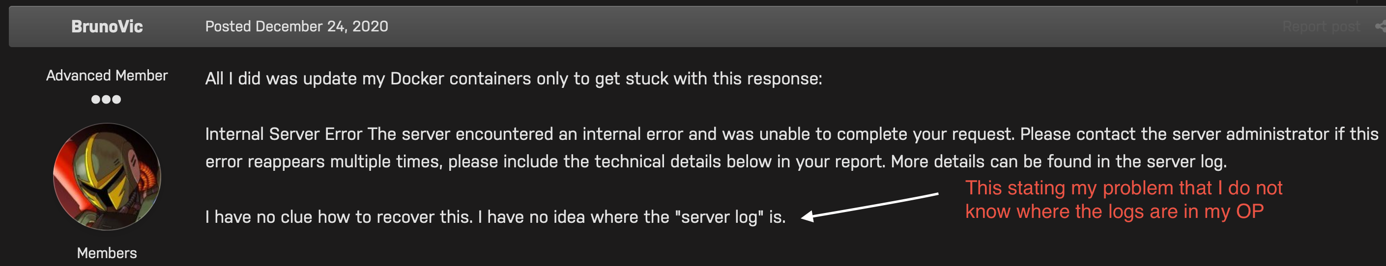

THANK YOU. Finally someone who has answered my questions!
P.S. I didn't just ask help now. It's been three weeks of downtime. At the time I needed an important file for a job I was applying to and after a docker update it just stopped working. Hence my sense of urgency. I've managed to recover the file due to someone else's assistance. But you have to empathize with me that I have been asking the same question over and over again and being told to provide the things I keep asking how to do. You would be angry too if you asked "How do you get the logs" and the response is "Please provide the logs". Then you go into this circular loop of never ending questions that seem to repeat themselves. I am supposed to be happy about that?

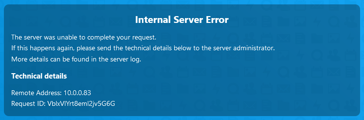

Experiencing an "Internal Server Error" following SpaceInvaderone's YT instructions as well as Linuxserver.io's. Have not installed Letsencrypt.
Been searching through this thread, but I haven't found that solution yet. Can someone give me a hand? If I'm missing a log file, let me know!
Nextcloud_config.php 610 B · 0 downloads Nextcloud_Log.txt 2.02 kB · 0 downloads Mariadb_Log.txt 5.54 kB · 0 downloads
If we assume your lan pc is on the same subnet and your subnet is 10.0.0.0/24, then on your config.php on nc add this on the trusted domains.
It should work now
  'trusted_domains' =>
  array (
    0 => '10.0.0.72:444',
    1 => '10.0.0.*',
It should work now
  array (
    1 => '10.0.0.*',
Thanks for your help! Gave this a shot but no go. I stopped the nc docker, updated the config.php file using krusader and confirmed that I had the changes saved. Then started up the nc container which brought me back to the initial set up page. I entered all the details as before and ended up back at the Internal server error page. Looking at the config.php file I see that my entry has been removed and it's back the way it was now.
Should I be using nano or a command line based editor instead? I've attached a new log file and the config.php as it was edited, before being reset.
Thank your for your time skois! I'm sure you're very busy and I appreciate your help.
Edit: I've got wireguard installed, is that causing a problem?
nextcloud.log config.php
Edited by blakeslade
nextcloud.log 160.03 kB · 0 downloads config.php 653 B · 0 downloads
The Answer is yes use nano or
this worked on my system
open up the shell for nexcloud
cd /config/www/nextcloud
pwd
should show ":/config/www/nextcloud#"
copy and paste
occ config:system:set trusted_domains 1 --value=192.168.1.*
change your ip to the one you need ... Did this from memory hope it works and helps you out

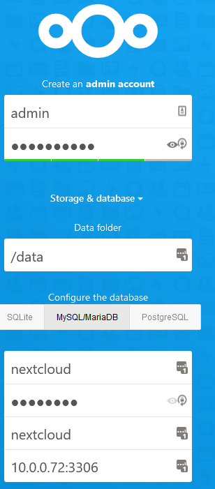

So nextcloud is still stuck in the inital setup phase. It's stuck there. Every time I open the WebGUI it's asking me for an admin user and pw along with db options.
When I open a shell to "/config/www/nextcloud" this is what I get:
occ config:system:set trusted_domains 1 --value=10.0.0.*
Nextcloud is not installed - only a limited number of commands are available
There are no commands defined in the "config:system" namespace.
At this point I've tried a few times and am running out of user names since it seems to save the ones I've tried in the past (lots of admin variations)?
Thanks again!
Thanks again!
If this is a new installation and you don't have any data, i would suggest delete appdata from both database and nextcloud and force update both dockers (open advanced view on docker tab). and start fresh.
That means you have to recreate the databases (check spaceinvaders video for the commands).
Something wasn't completed correctly on the 1st install and now it seems to fail every time.
Also before starting the initial setup (after wiping appdata and forcing update the dockers)
Add the trusted domain.
  array (
    1 => '10.0.0.*',
  array (
    1 => '10.0.0.*',
Thanks ton skois, I'll give that a go this afternoon.
I'm not currently using a cache drive, so my appdata is located at: /mnt/user/appdata
That's the only place I need to delete the data?
Correct!
Actually /mnt/user contains both data cache and array, depending on the share configuration
