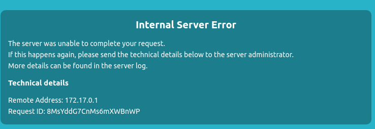

All,
Just upgraded to the latest Nextcloud and now I can’t get into the docker. Latest ver 20.
Running R710 Dell Server, 48 Gb ram, 30Tb space on Unraid.
Docker container is linuxserver.
See attached file.
Here is the text in case you can’t see it:
Internal Server Error
The server was unable to complete your request.
If this happens again, please send the technical details below to the server administrator.
More details can be found in the server log.
Technical details
Remote Address: 192.168.1.29
Request ID: VuYu7IeO7IvoqC2iKHZl
I’m stumped - I haven’t had any problems for over a year.
I have checked all the usual culprits maintenance mode off, checked the files etc using occ.
Looking for a direction to head in to solve this…
I suspect its probably something dumb I did - these things usually are…
Thanks in advance
Toolmanz
Edited by toolmanz
1 hour ago, toolmanz said:
All,
See attached file.
Technical details
Thanks in advance
Toolmanz
See my post above. Good luck trying to find the cause. I just nuked the Docker image , deleted the app dir and reinstalled from the Unraid Docker template. I was up and running in <15 min (although I spent an hour or two trying to "fix" it before that). My set up isn't fancy so I don't really know what all you may loose.

Well a little more information on the problem .....
The docker is running and except for the webui seems to be functioning as expected.
I did all of the maintenance as I would normally do with files and indices through OCC ..... not a problem.
I checked the PHP version and it is up to date (Jan 7-2021) [php -v in terminal]
"PHP 7.4.14 (cli) (built: Jan  7 2021 11:46:25) ( NTS )
Copyright (c) The PHP Group
Zend Engine v3.4.0, Copyright (c) Zend Technologies
    with Zend OPcache v7.4.14, Copyright (c), by Zend Technologies"
So thats not it .... I have had that problem before and fixed it with an update.
I can still access most of my files through the Nextcloud sync client in Windows so not a complete loss.
It's got to be with the webui only.... but can't think what that would be since nothing else changed.
I use reverse proxy for remote access but get the same error when I access locally - so that's not it....
I get the same error in Linux Mint when I try to use the webui ...at least its consistent🙄
Well I'll bump along and noodle on this some more....perhaps there are others that run into the same problem and will wake up the NC folks to the problem.
I left the same post on the NC support forum.
Ill post back if I find a solution ....🤔
Thanks for the responses .... we will figure this out .....
Cheers
Toolmanz

You'll want to be checking your logs. nginx logs within the `/config` mount and also the nextcloud log itself in the root of your `/data` mount. That should give some sort of insight to what's happening.
