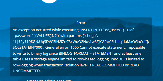

making some progress I think, the nextcloud folder was created.
however I still get an error on the nextcloud webgui config, see attached (it is different error this time)
yes I missed the semicolons!
also I missed the " ' " on the 'root'@'localhost'  lines....

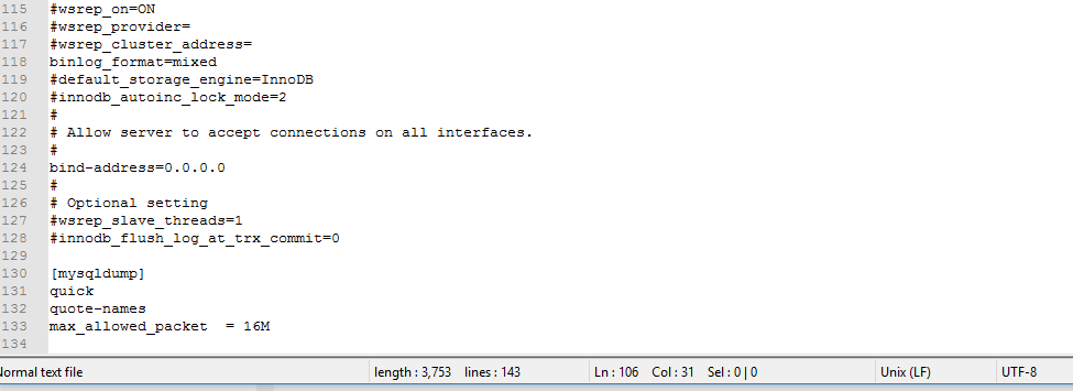

Dunno, I know I went through the instructions posted three times now and they work.  After that I'm lost.  Is that from a fresh install?  Looks like binlogging isn't enabled.  Sure you uncommented it?  (Removed the #)
yes, from a fresh install
agree it looks like the binlog not uncommented (but it is - see screenshot)
I used the mc editor to do it. just checked using notepad++ and it says 'unix' at the bottom, that was other thought was wrong format file.
also did the chown 644.
thanks
got it working!  not sure how.  stopped dockers, reopened the config file using notepad++, resaved, reapplied chown, restarted dockers and ran the webgui
thanks again for all of the help today
thanks

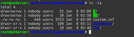

Just run this in terminal and post the results.
cd /mnt/cache/appdata/mariadb
ls -la
Should look like this
root@server:/mnt/cache/.appdata/mariadb-nextcloud# ls -la
total 12
drwxrwxrwx  4 nobody users   65 Dec 11 22:42 ./
drwxrwxrwx 34 nobody users 4096 Dec 24 20:13 ../
-rw-r--r--  1 nobody users 3754 Dec 11 22:34 custom.cnf
drwxr-xr-x  6 nobody users 4096 Dec 24 21:09 databases/
drwxr-xr-x  3 nobody users   18 Dec 11 22:42 log/

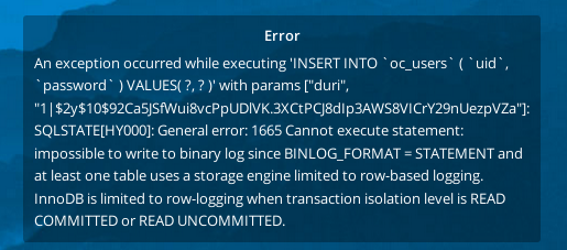

Hello guys,
I tryied to install nextcloud with mariadb as it stands here: https://www.linuxserver.io/2016/07/28/installing-nextcloud-on-unraid/
Just when I try to create an admin user and link the database I get following error:
Error while trying to create admin user: Failed to connect to the database: An exception occured in driver: SQLSTATE[HY000] [1049] Unknown database 'nextcloud'
Can someone please help me with this?
Thanks!
Hello guys,
Thanks!
Thanks!

Thank you for your reply, I tried all I could but i stucked on the same error as chuga. I have restarted everything, tried to reedit mariand cfg save and reaply chown 644 but no succes
Here I am giving a picture of my appdata/mariadb
You need to change the binlog format to mixed.
Thank you for your fast reply, but this I have done already before and no help.
I followed all your steps from totaly clear install with no other docker installations and clear shares.

Thanks for fast reply, I figured it out. One more command I needed:
chmod 644 custom.cnf
this after chown, it worked!
