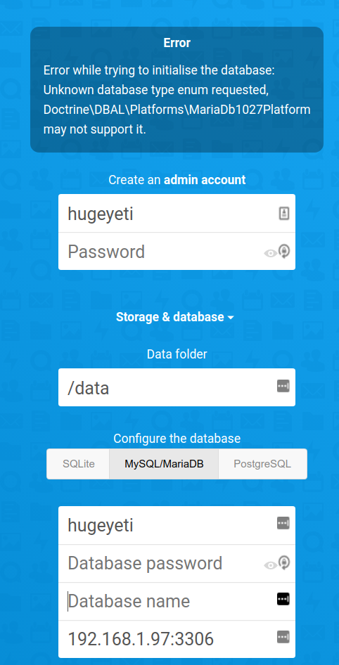

First time installing NextCloud w/ Mariadb and phphmyadmin.
I am able to install all the above and I configured passwords/users ok. However, I am getting ONE persistent error. If troubleshooting is extensive on this one, I can start from scratch and wipe out everything. This is a first time install.
Has anyone seen this error before and how to address it?
Link to comment
I see in nextcloud forum couple people with the same problem, but i see nextcloud have addressed it.
Try again from scratch following this video. If it doesn't work you could try in a couple of days again, maybe need some time for the patch to be included in the nextcloud image.
Link to comment
This worked perfect. Up and running and configuring. Thank you.
  • Like 1

How to I resolve this issue please?  I stopped the docker and now i get this issues.
