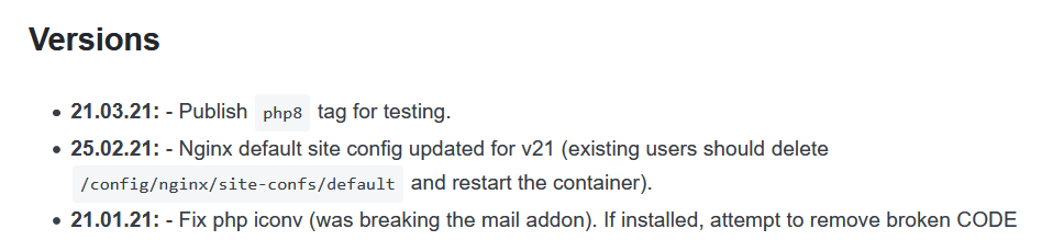

I thought I was a little blind, couldn't find this changelog.  But there it was:
25.02.21: - Nginx default site config updated for v21 (existing users should delete /config/nginx/site-confs/default and restart the container).
Perfectly recreated with the new entries - and nicely commented too!

@carnivorebrah @BVD Thanks! same time I found it myself be testing, I got a message for your answers 😅
By digging around and testing I also found the post with the changelog @BoxOfSnoo is refering to
https://docs.linuxserver.io/images/docker-nextcloud
Removing that file and recreate it was new for me. Never had any issues with my old config before. Last couple updates went fine until today.
Renaming the "default" file in "/config/nginx/site-confs" and restarting the docker at first wasn't the solution. Looks like Nextcloud is reading every file in that path when started up. Docker log showed the following and the web ui never came up.
So I removed the old default file from that path, restarted the docker and tada, Nextcloud was back and the errors are gone
BUT
with resetting the file, the  "Strict-Transport-Security“-HTTP-Header"  setting also was reset and had to be uncommented again. Same happened for "client_max_body_size" which i had configured to 10G before, by default it is set to 512M now. An upload with a 2GB testfile went trough. Weird 🤨

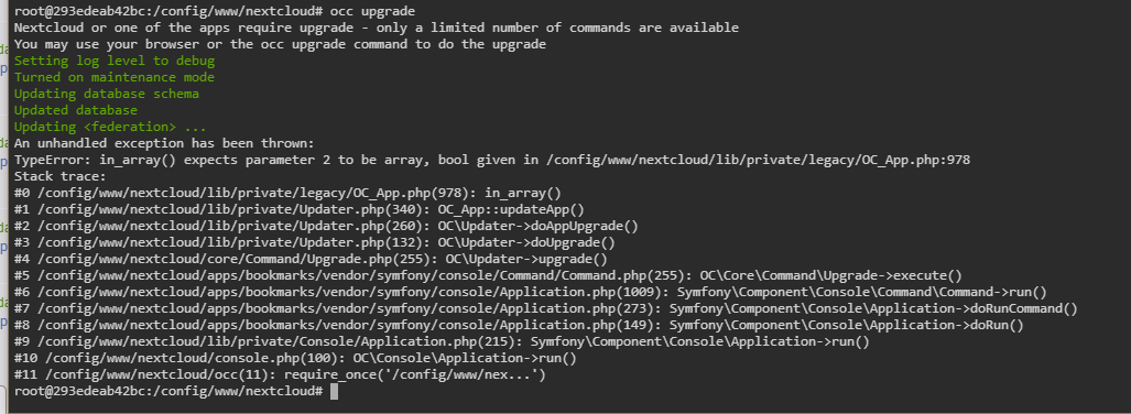

Hey all, I got myself in a quite a bit of a trouble..
I tried to update Nextcloud to the latest stable build through the UI, but it failed.
I was able to get everything fixed with the help of this:
and then manually moving the files from the Backup folder to their correct locations.
But! There was another update. I thought, surely this time it would work.
It didn't.
I tried to do the update through the terminal again, but this time around, I'm stuck in a "Internal server issue" page.
In the log, there is one particular error that keeps showing up:
It didn't.
I've battled with this for hours now, and it's getting late. I'm hoping I can get this fixed through the weekend, since my team is going to need to use Nextcloud again next week.
Any help would be greatly appreciated!
That's calling out the SMB PHP module, which I'd assume is an installed plugin - if you uninstall the plugin prior to your upgrade, do you still have issues?
