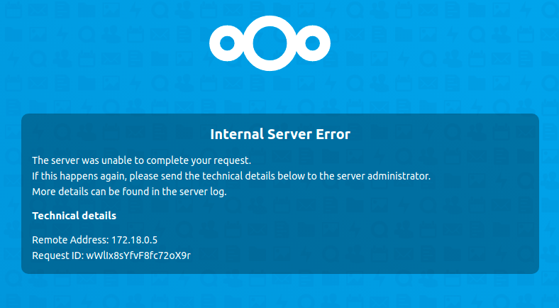

Updated to Nextcloud 21 yesterday through the terminal. Everything went fine and there are no errors in any of the log files. Regardless I get the following message:
I have checked the logs in on the Docker Icon and the following locations:
/mnt/appdata/nextcloud/log/nginx
/mnt/appdata/nextcloud/log/php
 The console still works fine and happily accepts commands.
Any ideas of what is wrong would be much appreciated.
Link to post
I got the same error when I updated to 21.0.1, and for me, it turned out to be the "external storage" application (which I'm using to get access to SMB shares in the Nextcloud app)
I got this fixed by simply removing the "files_external" folder found in:
\\YourServer\appdata\nextcloud\www\nextcloud\apps\
However, now I can't see the External Storages- application within the appstore of NC, so I'm trying to figure out how to re-install said app in order to access the SMB shares once again.

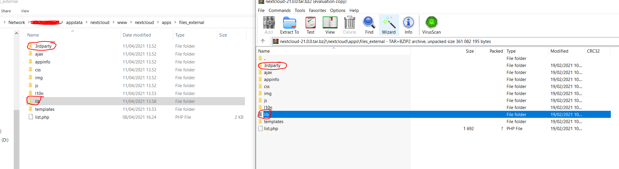

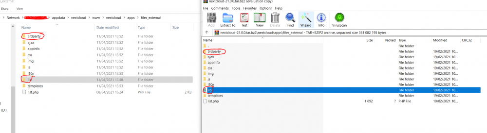

EDIT!
Haven't done a-lot of testing yet, but I think I got everything to work now!
Ok so, I downloaded the tar/zip file for NextCloud 21.0.0 from their website:
https://nextcloud.com/changelog/#latest20
I then manually moved two folders into the NextCloud installation folder.
So, in your Unraid server, navigate to:
\\YourServer\appdata\nextcloud\www\nextcloud\apps\files_external\
1. You see a folder named "lib" in there, remove it.
2. Open your tar/zip file you just downloaded, navigate to the same folder, and move the "lib" folder from the tar/zip file to replace your removed "lib" folder.
3. Do the same to the "3rdparty\icewind" folder.
And that seemed to do the trick for me!
Sorry for the bad explanation, I'm just getting a bit tired at this point, hah!
Edited by REllU
Link to post

Hi REIIU
Explanation was perfect. Worked for me ... once I realised you specifically need to use the 21.0.0 files you mentioned.
Thank you very much for sharing your solution.
Ntouchable
Link to post
