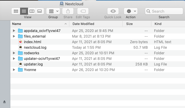

Posted (edited)
Can someone explain why this container is all the sudden constantly writing log files to my array data share /mnt/user/Nextcloud/ even though the share is set to "yes" use cache pool?  I have the container configured to use /mnt/user/appdata/nextcloud for everything config related, but I'm finding all kinds of appdata/config related files on the data share.
This has just started in the past few months (keeps my disk 9 and parity always spun up).
Edited by RodWorks
Link to post

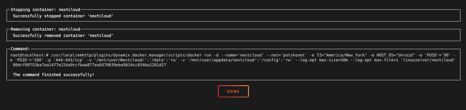

Even if you use cache: yes, the files will be moved to the array.
What exactly is it that is written in your /data mount that you mean should go in /config?
The more info you provide, the easier it is to help. And also post the docker run command.
Link to post
Posted (edited)
I realize this, but only when the mover runs correct? There's a nextcloud.log inside the data folder that's being written to constantly which seems to be the issue.
The finder screenshot is what's inside the data share of Nextcloud.  You can see the .log file there along with appdata files.
Edited by RodWorks
Link to post

17 hours ago, Aran said:
Looks like i have the same problem:
I deleted the nextcloud.log (+5MB) file yesterday and my disks went idle. Today a new log file popped up in the data share. The info inside the log-file is about 'mail, smtp settings error'. I forgot to copy before i deleted the file...
I just want to understand how Nextcloud can write directly to a share that is set to write to a cache drive first....
Link to post
New files will go to cache, not existing
Sent from my Mi 10 Pro using Tapatalk
Link to post
Posted (edited)
3 minutes ago, skois said:
Not on my Nextcloud data share, keeps one of my drives and parity spun up 24/7 even though mover only runs at 0200.  Nextcloud.log updates every minute.  If I stop the container the drives spin down normally.
Edited by RodWorks
Link to post
The nextcloud.log is existing file so after its moved one time in the array it stays there.
Updates on files don't move them to cache.
If you delete the file, the new one will be created automatically and will be on cache. Until mover is run again
Link to post
Ok, I guess that makes sense.  What's a solution to this issue?  Why doesn't Nextcloud write logs to the appdata share?
Link to post
Well, nextcloud is not aware if you run the docker in unraid or how you have setup your cache and disks.
Solution would be to have nextcloud share to prefer cache, that means files will stay in cache until is full.
With this you loose parity.
Or just fix the installation to not produce errors, not writing to log would be very rare.
Link to post
Ok, prefer is not an option..  I'll see if I can sort the errors out, otherwise it's gotta go.
Link to post
Posted (edited)
This is what's getting written to the log repeatedly.
,"message":"/appinfo/app.php is deprecated, use \\OCP\\AppFramework\\Bootstrap\\IBootstrap on the application class instead."
Edited by RodWorks
Link to post
You seem to have log level too high and it's logging too much info that is meant for debug.
On the link you can see how to change that. And there is also info on how to change the location of the log file.
But remember where you set it to be, because in the future if you have another problem and someone asks for the logs, you have to know where it is :)
https://docs.nextcloud.com/server/latest/admin_manual/configuration_server/logging_configuration.html

Link to post
I don't think you still have this problem anymore right?
I had the same problem about 3-4 weeks ago. There was a problem with nextcloud app store servers (IIRC). I haven't seen that error for some time now.
So if you don't have any problems now, you can ignore it
Link to post
Yes actually. Still having the same issue. The provided log is from today.
Link to post
Hey guys & gals im back lol with a few minor issues lol. I ended up deleting the nextcloud docker and mariandb and reinstalling everything. Solved my issues with updating and what not hopefully. Now my issue is downloading larger files. Once it reaches 367 mb of a file it says network error. Please help tia
Link to post
From a fast google search in github issues of nextcloud, they say that it should be fixed on the latests updates. If you are on latest update, try posting a bug report in their github.
Link to post
Probably this ->
https://www.reddit.com/r/NextCloud/comments/ayhlji/unable_to_download_files_larger_than_1gb/
Link to post
