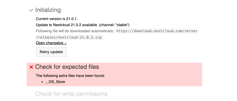

Tried to update to the latest version and below appeared. Anyone can help me fix this? Thanks.
Throw your Mac out of the window [emoji23]
Joking.
On your nextcloud appdata folder, delete all dsstore files.
It's just apples hidden file to store folder settings like what columns to show etc
Sent from my Mi 10 Pro using Tapatalk
Joking.
Stupic macOS, that worked like a charm! Thanks a bunch;)
