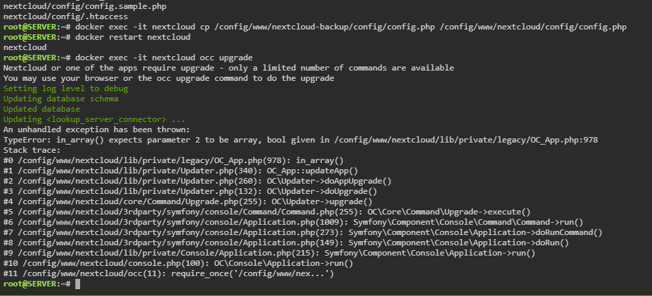

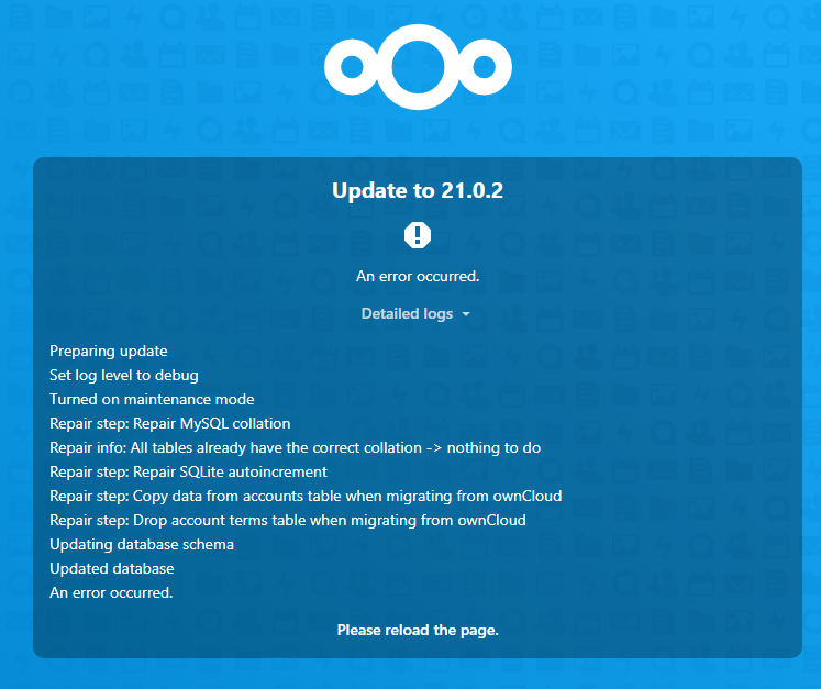

I have, for months, been trying to upgrade from NC20 to NC21.  Whenever I give it another go, I always get stumped here:
This is what I see in the WebUI after I restart NC:
Something about OC_App.php.  I've looked everywhere for a solution to no avail.  Anybody have a solution?  Thanks in advanced!!
I don't understand why you copy your backup config to current nextcloud .
maybe config was mentioned an older version and migration script runs wrong things?
Mention all steps please but tbh. this has nothing to do with the container and probably is better to ask for help in https://help.nextcloud.com/
I followed the instructions exactly as described in the first post of this thread.
Ok, without the rest of the steps didn't make any sense.
Anyway, nextcloud's forum might give more insight in this.
I updated also month ago from NC20 to NC21 without any problem.
Just to get it right, you followed the instructions of the first post of a thread which is 5 years old?
This is a long time and many things have changed and improved.
I made a backup of all files, configs and databases and made an inplace upgrade within the NC WebGUI. Logged in as admin and upgraded to the newest version without any issue.
After this i ran the suggested commands from NC to fix some DB warnings and done.
no console or anything else needed.
Edited by Harlequin42

Do you remember how you fixed this? I am trying to update and I'm experiencing the exact same.
On 5/20/2021 at 6:33 AM, Jessie said:
I presume you are talking about updating nextcloud itself vs updating the docker in unraid.
I'm also going to guess you are going to v21 from 20
In unraid open a console from the nextcloud icon
Then run these commands one at a time.
sudo -u abc php /config/www/nextcloud/occ db:add-missing-indices
sudo -u abc php /config/www/nextcloud/occ db:convert-filecache-bigint
sudo -u abc php /config/www/nextcloud/occ db:add-missing-columns
sudo -u abc php /config/www/nextcloud/occ db:add-missing-primary-keys
Then
sudo -u abc php /config/www/nextcloud/occ maintenance:repair
then
sudo -u abc php /config/www/nextcloud/occ upgrade
then
(again for good measure)
Then turn maintenance mode off
sudo -u abc php /config/www/nextcloud/occ maintenance:mode --off
Then see if you can get back to the logon screen
I'm having major issues getting Nextcloud to update. I tried to update through the GUI and eventually had to restore my appdata from a backup as Nextcloud became inoperable. Now I'm trying through the CLI. Option 2 from the first page of this forum results in:
Step 6 is currently in process. Please call this command later.
 So, I tried Option 3 (manual upgrade using occ) when I run the perform upgrade step, I am presented with:
Nextcloud or one of the apps require upgrade - only a limited number of commands are available
You may use your browser or the occ upgrade command to do the upgrade
Setting log level to debug
Turned on maintenance mode
Exception: Updates between multiple major versions and downgrades are unsupported.
Update failed
Maintenance mode is kept active
Resetting log level
Then I found your post and I tried the first command you mention and I get:
sudo: unknown user: abc
sudo: unable to initialize policy plugin
It seems way too complicated to update Nextcloud. Any idea what my options are now?
