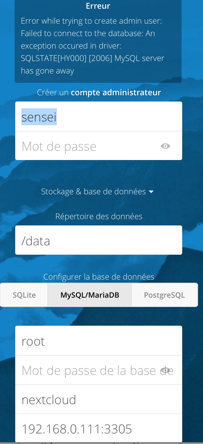

Hello there, and first for all, thank you all for your hard work.
I'm trying to setup nextcloud and before posting I've spend 2 days reading ALL the post about it.
But when I try to setup an admin account on nextcloud, I have this error : 2006 Mysql server has gone away....
I'm using mariadb in a docker with the setting posted in page #28. Thanks in advance for the help.

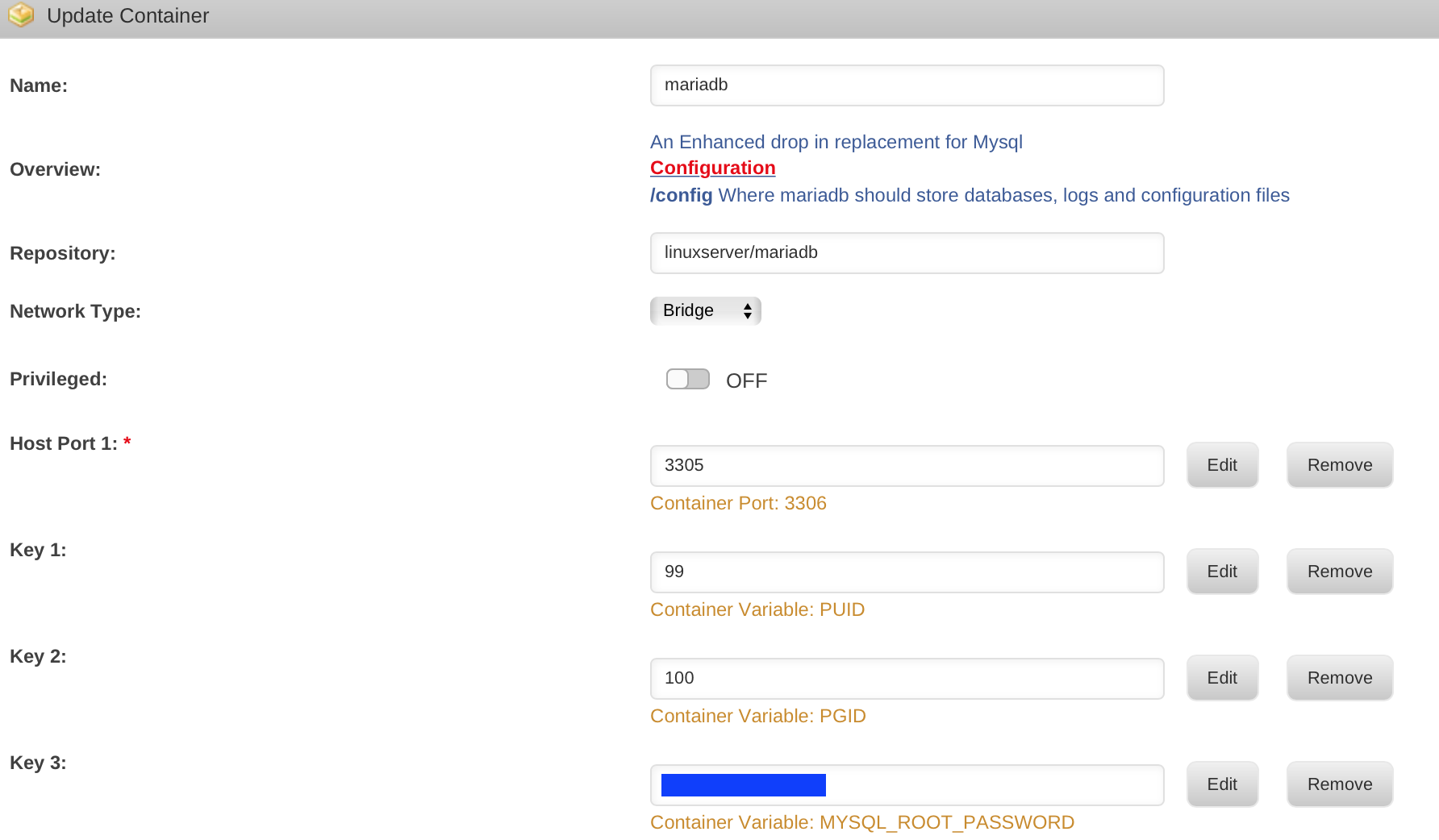

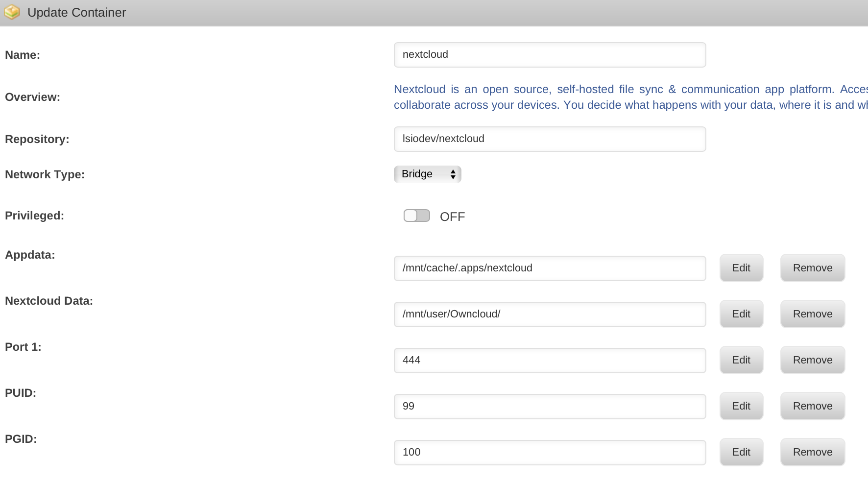

Can you actually post your info?  Both the docker run command for mariadb and nextcloud and I can take a look.
let me know if you need anythings else. All other parameters are by defaults (i've reinstalled the dockers and erased theirs confirmation directory in .apps)
58aad85093365_Capture_dcran_2017-01-28__12_06_26.png.e7ac931aefc3f1f14f4d776eee2d82a8.png
58aad8509b6a7_Capture_dcran_2017-01-28__12_06_47.png.4989c7cb26b38cf7af80ca66bd2e370d.png
OK that all looks good, so what can you post me a screenshot of the Nextcloud setup screen please?
here it is, If now on I'm not responding quickly it's because I'm going to work. Thanks
Hummm, I did try to setup with a wrong mysql password, and I've got the same error!!! Stange, I can connect to the db using docker exec....

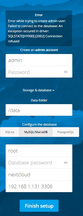

I am stuck a setting up NC. I followed the directions as outlined in #408, except for the last set of instructions, which I cannot figure how to execute:
root
$MARIADB-ROOT-PASSWORD
$UNRAID-IP:PORT
When creating the admin user, I get the error in the attachment. I am stuck at this point.

$MARIADBROOTPASSWORD is the root password you set
$UNRAID-IP:PORT is the Unraid IP port (For me that would be 192.168.0.1:3305)

When I initially setup MariaDB I set a simple password; however, when running
root
docker exec -it mariadb-nextcloud bash
mysql -uroot -p
That password was not accepted and only a blank response would lead to the next prompt.
So, when trying to add a NC admin account, I tried various combinations of the passwords, including just leaving it blank. None worked. Any chance on editing/setting a new MariaDB password so that I can use it during the NC setup.
root
$UNRAID-IP:PORT
Thank you,
Lev
Thank you.

Should look like this..
Yes, I went past this prompt; however, the original password used during the setup of Mariadb was not accessible. I had to leave the password blank and hit enter to get to this prompt.
