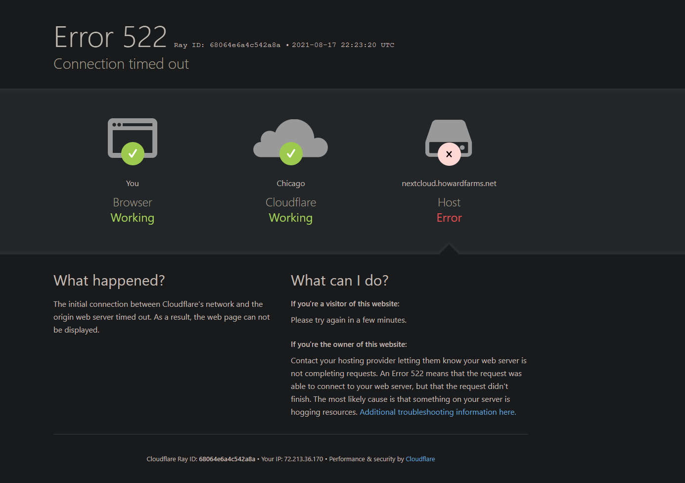

OK, I'm not sure where I went wrong, but it may have been when I stayed up way too late working on this.
I have MariaDB running for my NextCloud Container, that is front ended by SWAG (all from Linuxservers.io) which sit behind my USG-PRO. I have swag setup with a bridge and am forwarding 192.168.1.41:443 out to the world (obviously I'm not using that IP, don't spaz out.) From there I'm using DNS-o-Matic to update Namecheap with a records for WWW.AWESOMEDOMAIN.NET and NEXTCLOUD.AWESOMEDOMAIN.NET.
Both return a good response when running an internal (my computer) and external (someone's web page) nslookup.
I'm still getting this: image.png.37ed98ae8874db2e0b59cb0a9774eb70.png
I've attached redacted versions of my nextcloud and swag config files.
Edited by eagle470
Link to comment
swag config.txt 1.57 kB · 0 downloads nextcloud config.txt 847 B · 0 downloads
I dont use SWAG so cant comment there (use NPM instead).
I see the following line in the nextcloud conf:
'overwritehost' => 'nextcloud.howardfarms.net',
it should match your domain: 'nextcloud.awesomedomain.net',
Ot, you simply didnt redact all of the information and in that case they should all match :)
Let me know how it goes.
Edited by mfwade
Link to comment

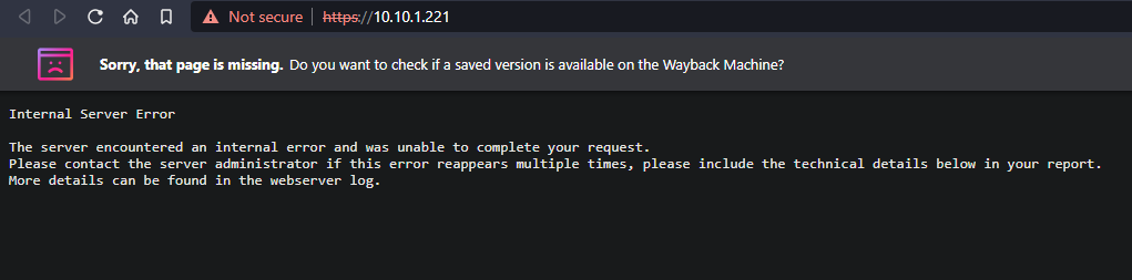

I've been following this guide which I figured out was seriously out of date: https://www.linuxserver.io/blog/2017-05-10-installing-nextcloud-on-unraid-with-letsencrypt-reverse-proxy
Then I also looked at the Linuxserver.io documentation for swag and this other blog https://linuxserver.tips/en/nextcloud-install-on-unraid/
I made this post earlier today: https://www.reddit.com/r/selfhosted/comments/p6a26g/linuxserver_documentation_for_swagnextcloud/
I'm unsure where I went wrong. I'm using cloudflare to get DDNS working, so I'm good there. I HAD a working instance of NextCloud locally, now I get
Internal Server Error The server encountered an internal error and was unable to complete your request. Please contact the server administrator if this error reappears multiple times, please include the technical details below in your report. More details can be found in the webserver log.
if I run
docker logs swag -f
everything looks clean in the logs there now. When I run.
docker logs nextcloud -f
I get this notorious error:
PHP Fatal error: Uncaught Error: Call to a member function getLogger() on null in /config/www/nextcloud/cron.php:162 Stack trace: #0 {main} thrown in /config/www/nextcloud/cron.php on line 162
Looking at ./log/nginx/error.log I see this error:
2021/08/17 17:13:23 [error] 407#407: *2 FastCGI sent in stderr: "PHP message: PHP Parse error:  syntax error, unexpected ''overwritehost'' (T_CONSTANT_ENCAPSED_STRING), expecting ')' in /config/www/nextcloud/config/config.php on line 25" while reading response header from upstream, client: 10.10.1.89, server: _, request: "GET /ocs/v2.php/apps/notifications/api/v2/notifications HTTP/2.0", upstream: "fastcgi://127.0.0.1:9000", host: "10.10.1.221"
If I comment it out I learn I get that same (roughly) error for these three config entries:
'overwrite.cli.url' => 'https://nextcloud.server.com',
'overwritehost' => 'nextcloud.server.com',
'overwriteprotocol' => 'https',
If I comment those out I can get to everything locally but not through my public DNS.
If I leave them in, I can't get to anything locally or externally.
I really want to get this working and I feel like I'm close. I'm just not sure what I'm doing wrong.
I'm using all the linuxserver.io containers (mariadb, nextcloud and swag) to make this work, though I've been testing with the NginxProxyManager just to check my work on the proxy server side. It does not appear thats an issue, so I'd like to switch back to the swag container, in which case I turn one off, the other on and change the port forward rule.
Please help me figure this out, I need a fresh set of eyes on this.
Hello i had a hard week. I will check in setting but overwritehost' => 'nextcloud.howardfarms.net was setup and # was deleted. Going to read some more becouse i see eagle is on another level :). Also got some chat in reddit
Link to comment
if I run
docker logs swag -f

My issue was several things, I needed to change the SSL type from Flexible to Full in cloudflare, I needed to add a trustedproxy flag, I also missed an apostrophe.
I had to add a cname in my dns servers (pihole) for my proxy host (swag) as well. I chose to use a fixed IP, figuring it gave me more flexibility in the long run to lock things down.
