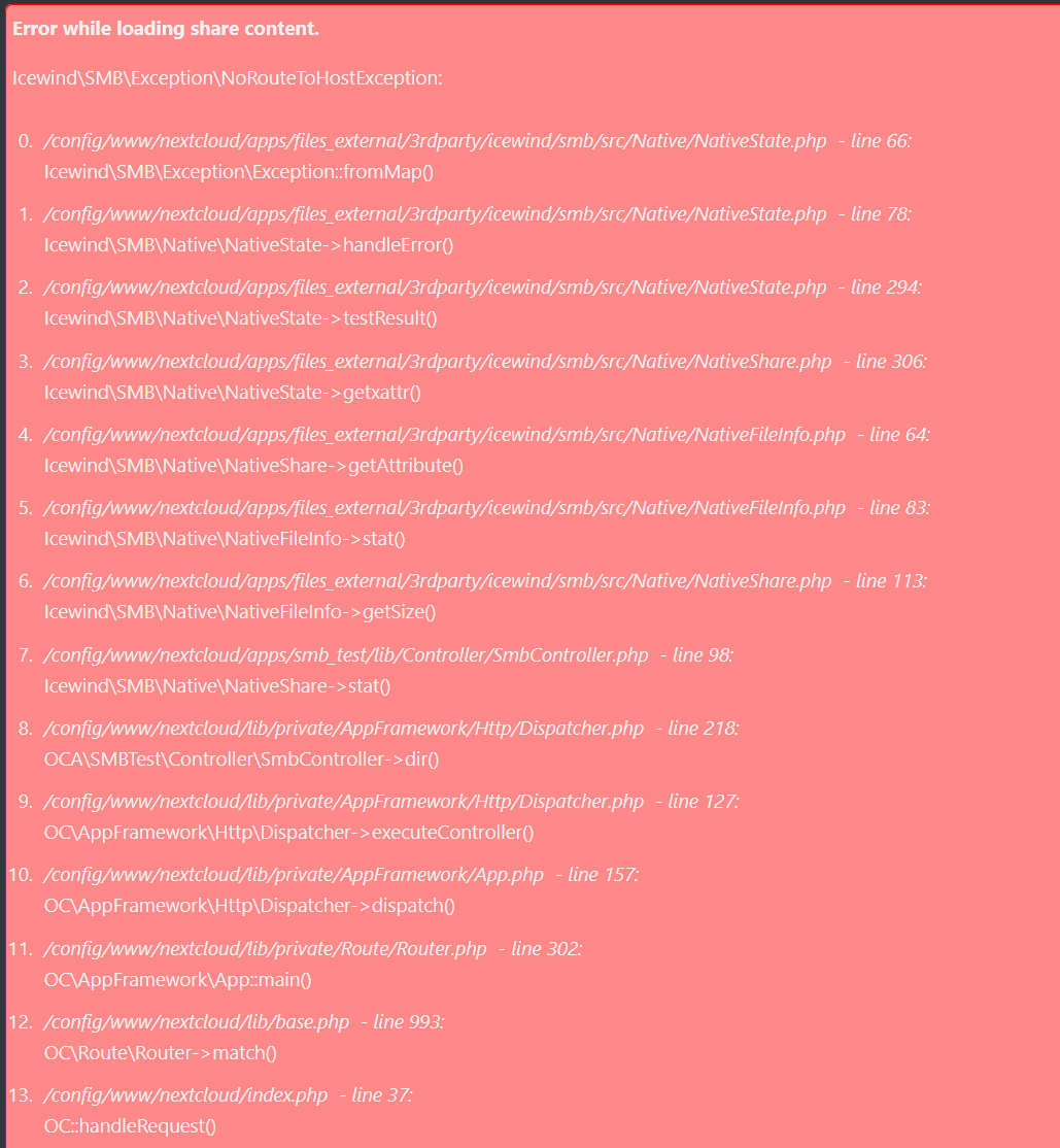

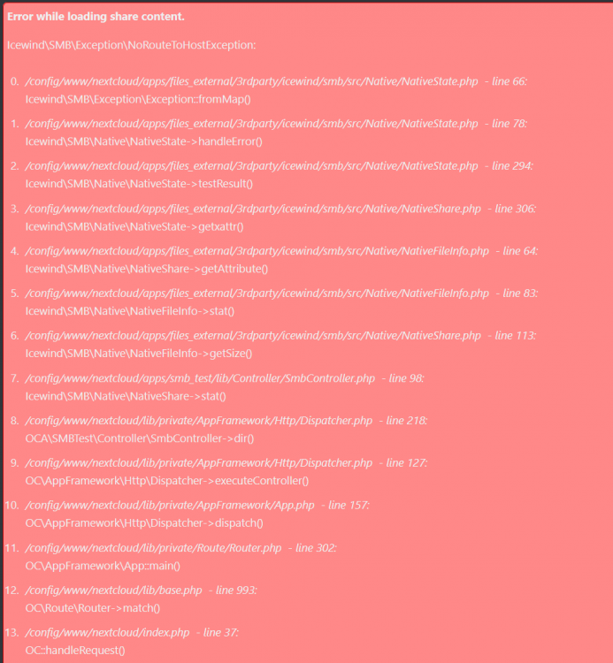

(Old issue, before updating)
Spoiler
Upgraded my UnRaid hardware over the weekend, and noticed that now NextCloud is unable to access SMB shares.
Anyone have any ideas what's up with that?
The shares themselves seem to be fine, as I can access them through network.
I upgraded the motherboard, RAM, and CPU.
With SMB test- app, I'm getting the following errors:
I updated the docker image, but I haven't updated NextCloud itself in a while. The last update broke the SMB shares in such a way, that I had to download the previous version of NextCloud, and import the "icewind" from the older version to the new one, to get it to work again.
EDIT: (Internal server error, fixed in the next edit)
Spoiler
So, I figured I have not much to lose, and tried to update NextCloud, and I'm having the same issue as many others in here.
Internal Server Error.
I've tried to update MariaDB, and tried to delete the ib_logfile0, and tried to change the repository of MariaDB, but nothing seems to work there.
Again, any help would be appreciated.
EDIT2: (Fixing the internal server error, and back to square one)
Spoiler
Reading through the log-file, I noticed something familiar. The files_external was giving me issues again, so I tried to remove the app folder, and ta-dah! I was able to access my NextCloud yet again.
I then tried to do the same trick I did the last time around:
And.. I'm back to square one.
So, I can access the NextCloud, but NextCloud cannot access the SMB shares.
EDIT3:
NextCloud is amazing for what it's trying to achieve, when it works. But it has just given me way too many headaches, and it's pretty much overkill for what I want to do with it (accessing files through the internet) that I've now decided to move to "FileBrowser" docker instead. Setting that up took me 10 minutes without really knowing what to do, and it's been working nicely (knock on wood), and even issues that we previously had (not being able to download files over 1gb) are now gone.
Good luck all of you UnRaider's, who're battling with NextCloud!
Edited by REllU
Link to comment

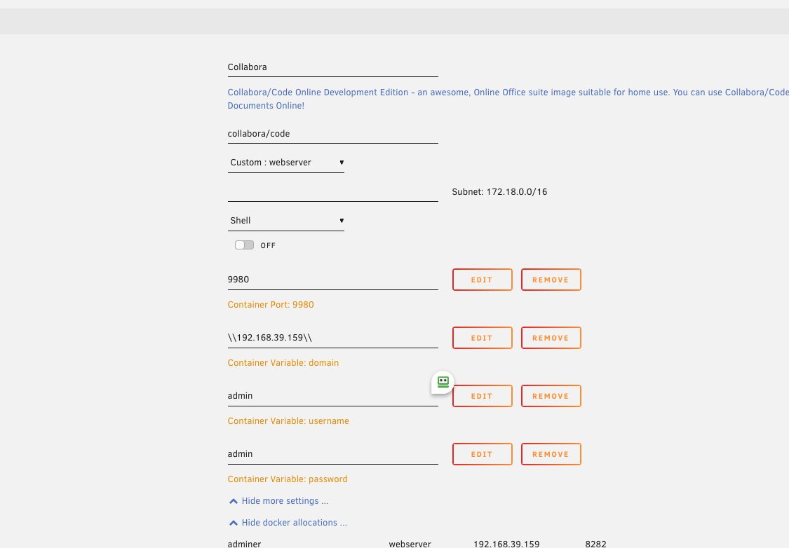

I have previously set up both Nextcloud and Collabora on my personal Unraid server and it has been cranking along fine for quite some time. Recently my boss discovered Nextcloud and wanted it. We initially had it running on a Synology but between the limited resources on the Syno and some behind the scenes networking stuff, we made the move to Unraid.
I was able to successfully move the database and all of the data over to our Unraid server and get it back up and running. Since I had not set Collabora up on the Synology, we were running without it on Unraid. I installed the Collabora docker, followed all of the same steps that I used on my personal server and I have been having all kinds of difficulty with it.
When I try to enter the collabora address into the settings for Collabora Online in Nextcloud, it tells me that it could not establish a connection to the server. Looking at the nextcloud.log file, I found an error referring to the SSL certificate saying that it is a self signed certificate. Seeing as how I have both Nextcloud and Collabora sitting behind SWAG, this error doesn't make much sense to me, but I admit to not being an expert on this.
I can access the Collabora admin page, and it does show that it is a secure connection verfied by LetsEncrypt.

Need some guidance here because I am stumped!! I am trying to do just a basic local network install nothing fancy like reverse proxy. I followed SpacedInvaders tutorial and I am super confused have tried everything and I just can not get it to work.
In NextCloud it says
Collabora Online server is reachable.
With a green icon.
But when I try to open or create a document it times out and says
Failed to load Collabora Online - please try again later✖
I am pretty sure the problem is in the docker setup of the domain pic below:
This is internal and I did change the user and pass to show here before anybody says something lol
Now my nextcloud install is at
https://192.168.39.159
I asume the way I have it is wrong so what do I put in Container Variable: domain
thanks any help is as always really really appreciated.
Vic
Edited by NeoSys
