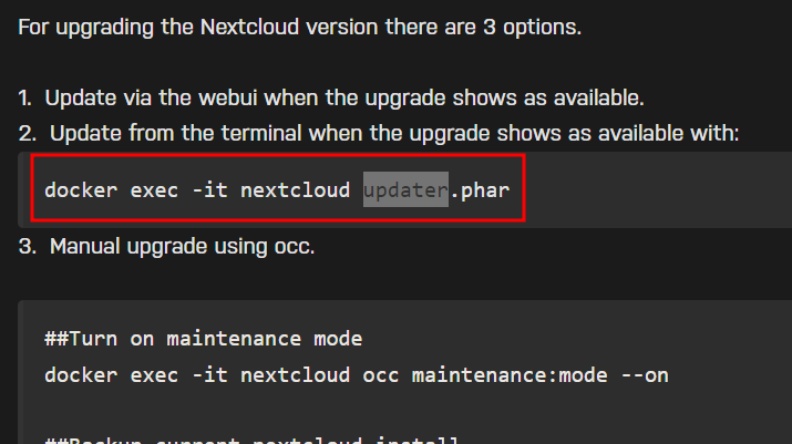

I run into the "update in procress" Problem while the last update.. tried to stop the maintenance via ssh with no succes..i did it bei editing the config.php. i^ve tried do do start tzhe update manual, like on the first page in this thread...but still have problems:
docker exec -it nextcloud updater.phar
sh: docker: not found
docker exec -it nextcloud occ maintenance:mode --on
I guess the best idea would be an backup restore...i've found them but don't know how to do it..totally noob..
Link to comment
Dont go into the docker console to enter those commands. Use Unraid terminal. Also for manual update start at step 3 on the first post.
  • Like 1
Link to comment
I did a restore of an backup. my NExtcloud is running now.. but thank you anyway...just tested the maintenance mode in the terminal and it works!
Link to comment

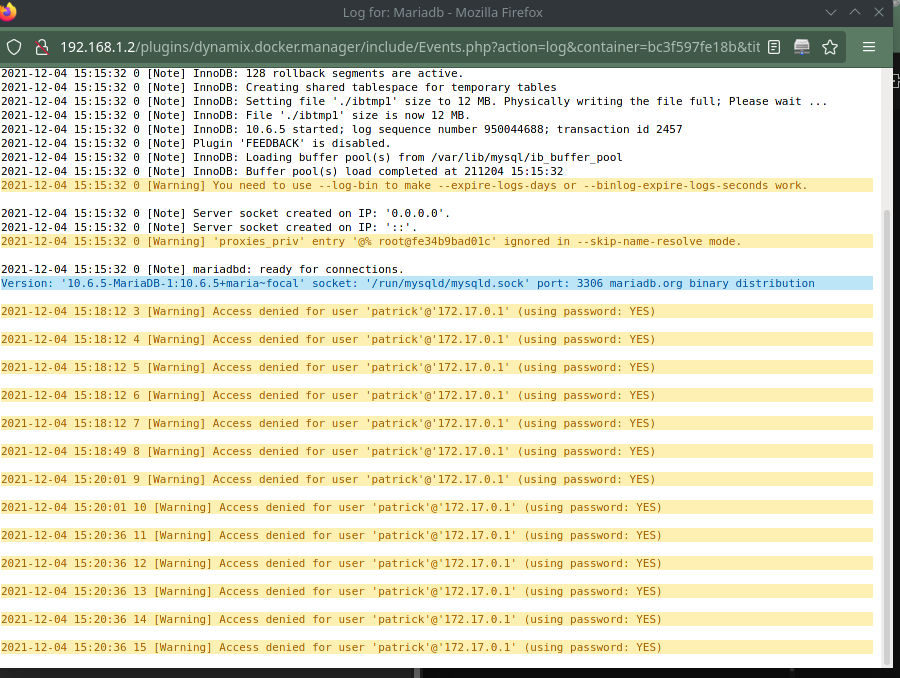

I'll spare the details but essentially I as trying to resolve the cache writing issues to my new cache pools and must have messed something up during mover to my array or back from my array. Now nextcloud's php error log gives me this:
2021/11/21 06:12:48 [error] 1794#1794: *63211 FastCGI sent in stderr: "PHP message: PHP Fatal error:  Uncaught Doctrine\DBAL\Exception: Failed to connect to the database: An exception occurred in the driver: SQLSTATE[HY000] [2006] MySQL server has gone away in /config/www/nextcloud/lib/private/DB/Connection.php:87
Stack trace:
#0 /config/www/nextcloud/3rdparty/doctrine/dbal/src/Connection.php(1486): OC\DB\Connection->connect()
#1 /config/www/nextcloud/3rdparty/doctrine/dbal/src/Connection.php(1014): Doctrine\DBAL\Connection->getWrappedConnection()
#2 /config/www/nextcloud/lib/private/DB/Connection.php(231): Doctrine\DBAL\Connection->executeQuery()
#3 /config/www/nextcloud/3rdparty/doctrine/dbal/src/Query/QueryBuilder.php(210): OC\DB\Connection->executeQuery()
#4 /config/www/nextcloud/lib/private/DB/QueryBuilder/QueryBuilder.php(287): Doctrine\DBAL\Query\QueryBuilder->execute()
#5 /config/www/nextcloud/lib/private/AppConfig.php(344): OC\DB\QueryBuilder\QueryBuilder->execute()
#6 /config/www/nextcloud/lib/private/AppConfig.php(109): OC\AppConfig->loadConfigValues()
#7" while reading response header from upstream, client: 154.3.44.228, server: _, request: "PROPFIND /remote.php/dav/files/TBoneStaek/ HTTP/1.1", upstream: "fastcgi://127.0.0.1:9000", host: "nextcloud.[mydomain].com"
2021/11/21 06:12:48 [error] 1794#1794: *63213 FastCGI sent in stderr: "PHP message: PHP Fatal error:  Uncaught Doctrine\DBAL\Exception: Failed to connect to the database: An exception occurred in the driver: SQLSTATE[HY000] [2006] MySQL server has gone away in /config/www/nextcloud/lib/private/DB/Connection.php:87
Stack trace:
#7" while reading response header from upstream, client: 154.3.44.228, server: _, request: "PROPFIND /remote.php/dav/files/Coaldez341/ HTTP/1.1", upstream: "fastcgi://127.0.0.1:9000", host: "nextcloud.[mydomain].com"
Please ELI5 as I have very very little CLI knowledge (though Nextcloud so far has been changing this...)
I can't access the web gui locally or through reverse proxy.
Edited by TBoneStaek
Link to comment
Stack trace:
Stack trace:
"MySQL server has gone away in /config/www/nextcloud/lib/private/DB/Connection.php:87"
You need to investigate your MariaDB/MySQL Container as the problem lies there, not with nextcloud.
Nextcloud Updater - version: v20.0.0beta4-11-g68fa0d4
Current version is 22.2.0.
Update to Nextcloud 22.2.3 available. (channel: "stable")
Following file will be downloaded automatically: https://download.nextcloud.com/server/releases/nextcloud-22.2.3.zip
Open changelog ↗
Steps that will be executed:
[ ] Check for expected files
[ ] Check for write permissions
[ ] Create backup
[ ] Downloading
[ ] Verify integrity
[ ] Extracting
[ ] Enable maintenance mode
[ ] Replace entry points
[ ] Delete old files
[ ] Move new files in place
[ ] Done
Start update? [y/N] y
Info: Pressing Ctrl-C will finish the currently running step and then stops the updater.
[✔] Check for expected files
[✔] Check for write permissions
[✔] Create backup
[✔] Downloading
[✔] Verify integrity
[ ] Extracting ...PHP Warning:  require(/config/www/nextcloud/updater/../version.php): failed to open stream: No such file or directory in phar:///config/www/nextcloud/updater/updater.phar/lib/Updater.php on line 658
PHP Fatal error:  require(): Failed opening required '/config/www/nextcloud/updater/../version.php' (include_path='.:/usr/share/php7') in phar:///config/www/nextcloud/updater/updater.phar/lib/Updater.php on line 658

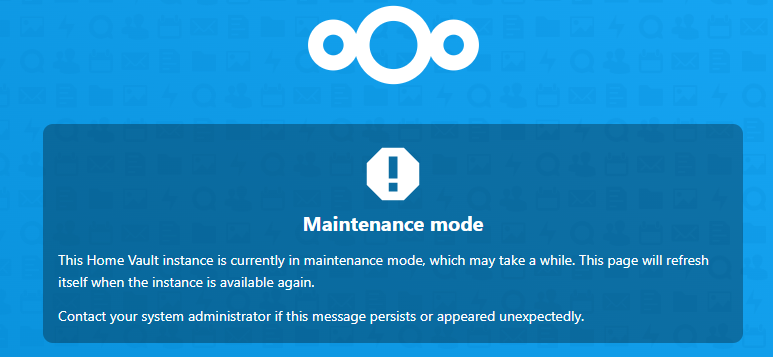

I'm getting a message telling me that my NextCloud is in Maintenance mode. Just a few minutes earlier it was working fine.  I checked for any updates, and found two.  I applied them then when I refreshed the page, I got the message below.  I've restarted the docker image and the log shows no errors.  How do I clear this so I can use the service again?
Update: I did a google search and was able to fix the issue with the following:
cd /config/www/nextcloud
sudo -u abc ./occ maintenance:mode --off
This worked.

I have an issue on Unraid.
I tried to upadte the app from witin nextcloud and it goit stuck in maitance mode. I tried using occ but that gives the following error
root@7dbf3a08b34e:/# sudo -u abc php /config/www/nextcloud/occ maintenance:mode --off
Nextcloud or one of the apps require upgrade - only a limited number of commands are available
You may use your browser or the occ upgrade command to do the upgrade
Maintenance mode disabled
root@7dbf3a08b34e:/# sudo -u abc php /config/www/nextcloud/occ upgrade
Setting log level to debug
Turned on maintenance mode
Updating database schema
Updated database
Updating <mail> ...
An unhandled exception has been thrown:
ArgumentCountError: Too few arguments to function OCA\Mail\Migration\ProvisionAccounts::__construct(), 0 passed in /config/www/nextcloud/lib/private/Repair.php on line 122 and exactly 1 expected in /config/www/nextcloud/apps/mail/lib/Migration/ProvisionAccounts.php:37
Stack trace:
#0 /config/www/nextcloud/lib/private/Repair.php(122): OCA\Mail\Migration\ProvisionAccounts->__construct()
#1 /config/www/nextcloud/lib/private/legacy/OC_App.php(1035): OC\Repair->addStep()
#2 /config/www/nextcloud/lib/private/legacy/OC_App.php(979): OC_App::executeRepairSteps()
#3 /config/www/nextcloud/lib/private/Updater.php(375): OC_App::updateApp()
#4 /config/www/nextcloud/lib/private/Updater.php(254): OC\Updater->doAppUpgrade()
#5 /config/www/nextcloud/lib/private/Updater.php(130): OC\Updater->doUpgrade()
#6 /config/www/nextcloud/core/Command/Upgrade.php(255): OC\Updater->upgrade()
#7 /config/www/nextcloud/3rdparty/symfony/console/Command/Command.php(255): OC\Core\Command\Upgrade->execute()
#8 /config/www/nextcloud/3rdparty/symfony/console/Application.php(1000): Symfony\Component\Console\Command\Command->run()
#9 /config/www/nextcloud/3rdparty/symfony/console/Application.php(271): Symfony\Component\Console\Application->doRunCommand()
#10 /config/www/nextcloud/3rdparty/symfony/console/Application.php(147): Symfony\Component\Console\Application->doRun()
#11 /config/www/nextcloud/lib/private/Console/Application.php(215): Symfony\Component\Console\Application->run()
#12 /config/www/nextcloud/console.php(100): OC\Console\Application->run()
#13 /config/www/nextcloud/occ(11): require_once('/config/www/nex...')
#14 {main}root@7dbf3a08b34e:/#
