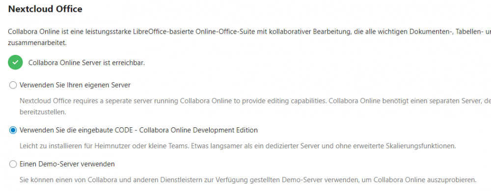

habeme Posted December 2, 2021 Share Posted December 2, 2021 Hello, I was running into the same problems @skois and @blaine07 after a CODE / collabora update. Finding the solution was a pretty frustrating journey and was buried in a forum post somewhere far along the trail. I could not find the solution in here either, but I might have read over it as the search options on this forum are not optimal, so please correct me if this a double post. THIS is what worked for me: post collabora/code:6.4.9.3 versions there have been some changes that need to be adjusted in your nginx collabora config, and in your advanced settings in your docker template. Change in appdata\letsencrypt\nginx\proxy-confs\collabora.subdomain.conf all instances of: "loleaflet" to "browser" "lool" to "cool" Change docker template in advance view: Web UI "https://[IP]:[PORT:9980]/loleaflet/dist/admin/admin.html" to ""https://[IP]:[PORT:9980]/browser/dist/admin/admin.html" 1 Quote Link to comment

ptirmal Posted December 3, 2021 Share Posted December 3, 2021 On 12/2/2021 at 2:54 AM, habeme said: Hello, I was running into the same problems @skois and @blaine07 after a CODE / collabora update. Finding the solution was a pretty frustrating journey and was buried in a forum post somewhere far along the trail. I could not find the solution in here either, but I might have read over it as the search options on this forum are not optimal, so please correct me if this a double post. THIS is what worked for me: post collabora/code:6.4.9.3 versions there have been some changes that need to be adjusted in your nginx collabora config, and in your advanced settings in your docker template. Change in appdata\letsencrypt\nginx\proxy-confs\collabora.subdomain.conf all instances of: "loleaflet" to "browser" "lool" to "cool" Change docker template in advance view: Web UI "https://[IP]:[PORT:9980]/loleaflet/dist/admin/admin.html" to ""https://[IP]:[PORT:9980]/browser/dist/admin/admin.html" Thanks so much for this. Didn't have time to look far into it, appreciate the info! Quote Link to comment
blaine07 Posted December 3, 2021 Share Posted December 3, 2021 Hello, I was running into the same problems @skois and @blaine07 after a CODE / collabora update. Finding the solution was a pretty frustrating journey and was buried in a forum post somewhere far along the trail. I could not find the solution in here either, but I might have read over it as the search options on this forum are not optimal, so please correct me if this a double post. THIS is what worked for me: post collabora/code:6.4.9.3 versions there have been some changes that need to be adjusted in your nginx collabora config, and in your advanced settings in your docker template. Change in appdata\letsencrypt\nginx\proxy-confs\collabora.subdomain.conf all instances of: "loleaflet" to "browser" "lool" to "cool" Change docker template in advance view: Web UI "https://[iP]:[PORT:9980]/loleaflet/dist/admin/admin.html" to ""https://[iP]:[PORT:9980]/browser/dist/admin/admin.html" Somehow just saw this. Will have to give it a whirl this evening!Thanks! Quote Link to comment

NGMK Posted December 3, 2021 Share Posted December 3, 2021 On 12/2/2021 at 2:54 AM, habeme said: Hello, I was running nextcloud for couple of months with minor issues (warnings on the logs) then all of sudden one day I when I used the Unraid web ui to update the docker and then the actual Nextcloud updater inside of the Nextcloud Settings interface its now stuck on: Update in process. I tried running restarting the docker, restarting Unraid, I have also tried the update command within unraid terminal and lastly I tried putting nextcloud in maintenance mode to no avail. On 12/2/2021 at 2:54 AM, habeme said: root@Poseidon:~# docker exec -it nextcloud updater.phar Nextcloud Updater - version: v20.0.0beta4-11-g68fa0d4 Current version is 20.0.9. Update to Nextcloud 20.0.14 available. (channel: "stable") Following file will be downloaded automatically: https://download.nextcloud.com/server/releases/nextcloud-20.0.14.zip Open changelog ↗ Steps that will be executed: [✔] Check for expected files [✔] Check for write permissions [✔] Create backup [✔] Downloading [ ] Verify integrity [ ] Extracting [ ] Enable maintenance mode [ ] Replace entry points [ ] Delete old files [ ] Move new files in place [ ] Done Continue update? [y/N] y Info: Pressing Ctrl-C will finish the currently running step and then stops the updater. [✔] Check for expected files [✔] Check for write permissions [✔] Create backup [✔] Downloading [✘] Verify integrity failed Signature of update is not valid Update failed. To resume or retry just execute the updater again. root@Poseidon:~# docker exec -it nextcloud occ maintenance:mode --on Could not open input file: /config/www/nextcloud/occ root@Poseidon:~# docker exec -it nextcloud occ maintenance:mode --on Could not open input file: /config/www/nextcloud/occ root@Poseidon:~# ^C root@Poseidon:~# On 12/2/2021 at 2:54 AM, habeme said: Quote Link to comment

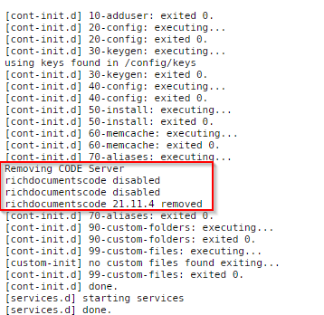

Joggel Posted December 5, 2021 Share Posted December 5, 2021 Hallo, i did a fresh install of the nextcloud docker version 23 to use the built in collabora. But everytime i start up nextcloud the CODE Server gets removed. I can install it in the app menu but it doenst work and gets removed again if i restart the docker. If i try to open a office document after installing it just downloads it. Any idea how to get it working ? Quote Link to comment
alturismo Posted December 5, 2021 Share Posted December 5, 2021 2 hours ago, Joggel said: Any idea how to get it working ? like mentioned several times here, it wont work on any alpine based docker, also not on the official NC alpine based docker. same goes for the OnlyOfiice integration. so in terms you want to use a alpine based NC (like this one) you need to take a sep office docker. 1 Quote Link to comment

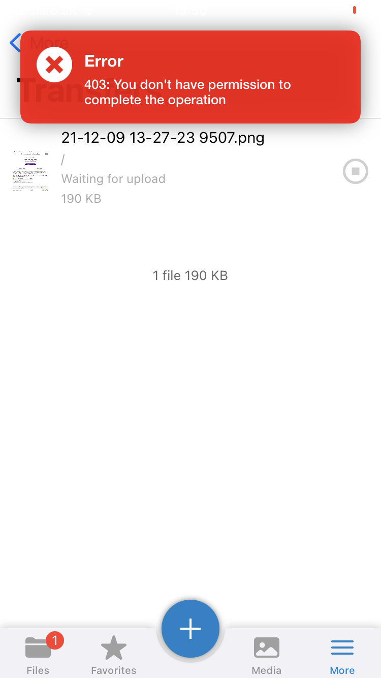

Profezor Posted December 8, 2021 Share Posted December 8, 2021 A user can’t upload any files. any ideas? below is some of the log which may or may not be useful. ‘thanks {"reqId":"BpSLacl3CBQl7th45fnx","level":3,"time":"2021-12-08T06:07:52+00:00","remoteAddr":"172.17.0.1","user":"Manapra","app":"text","method":"PUT","url":"/apps/text/session/create","message":"","userAgent":"Mozilla/5.0 (Macintosh; Intel Mac OS X 10_15_7) AppleWebKit/537.36 (KHTML, like Gecko) Chrome/96.0.4664.93 Safari/537.36","version":"23.0.0.10","exception":{"Exception":"OCP\\Files\\NotFoundException","Message":"","Code":0,"Trace":[{"file":"/config/www/nextcloud/apps/text/lib/Service/ApiService.php","line":81,"function":"getFileById","class":"OCA\\Text\\Service\\DocumentService","type":"->"},{"file":"/config/www/nextcloud/apps/text/lib/Controller/SessionController.php","line":50,"function":"create","class":"OCA\\Text\\Service\\ApiService","type":"->"},{"file":"/config/www/nextcloud/lib/private/AppFramework/Http/Dispatcher.php","line":217,"function":"create","class":"OCA\\Text\\Controller\\SessionController","type":"->"},{"file":"/config/www/nextcloud/lib/private/AppFramework/Http/Dispatcher.php","line":126,"function":"executeController","class":"OC\\AppFramework\\Http\\Dispatcher","type":"->"},{"file":"/config/www/nextcloud/lib/private/AppFramework/App.php","line":157,"function":"dispatch","class":"OC\\AppFramework\\Http\\Dispatcher","type":"->"},{"file":"/config/www/nextcloud/lib/private/Route/Router.php","line":302,"function":"main","class":"OC\\AppFramework\\App","type":"::"},{"file":"/config/www/nextcloud/lib/base.php","line":1006,"function":"match","class":"OC\\Route\\Router","type":"->"},{"file":"/config/www/nextcloud/index.php","line":36,"function":"handleRequest","class":"OC","type":"::"}],"File":"/config/www/nextcloud/apps/text/lib/Service/DocumentService.php","Line":409,"CustomMessage":"--"},"id":"61b12bc906ae7"} Quote Link to comment
