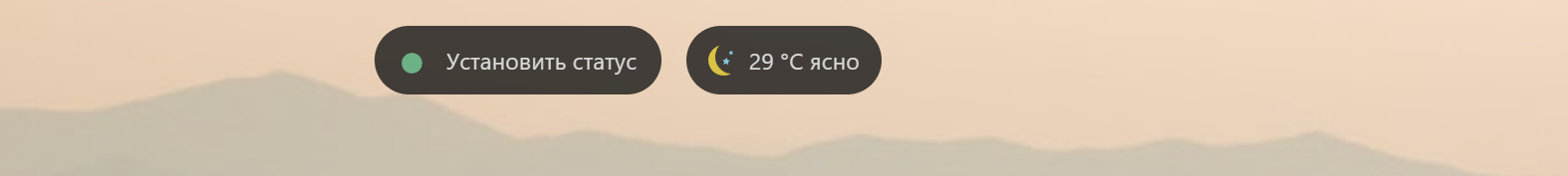

Having no time in dashboard in weather widget , someone know how to fix it ?
