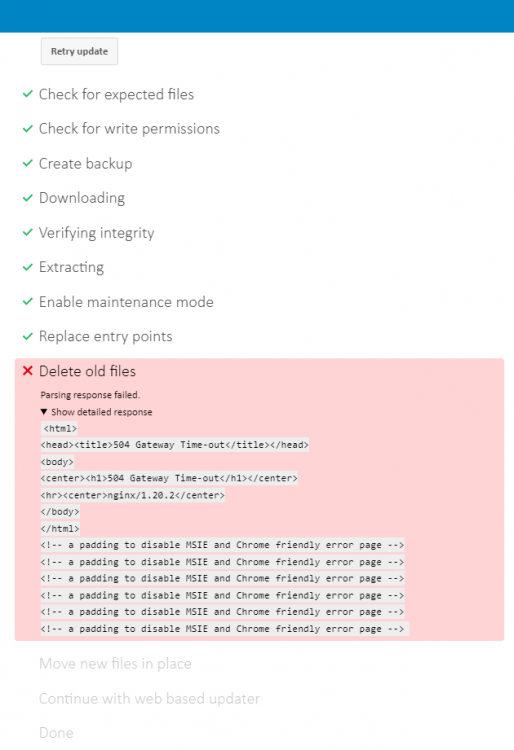

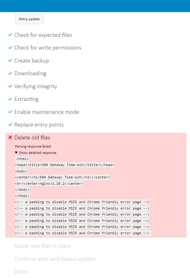

On 8/20/2022 at 3:35 AM, patm95 said:
Tried updating Nextcloud. I am stuck at level 6 and not proceeding.
Log is as follows:
cont-init: info: running /etc/cont-init.d/99-custom-files
cont-init: info: /etc/cont-init.d/99-custom-files exited 0
s6-rc: info: service legacy-cont-init successfully started
s6-rc: info: service init-mods: starting
s6-rc: info: service init-mods successfully started
s6-rc: info: service init-mods-package-install: starting
s6-rc: info: service init-mods-package-install successfully started
s6-rc: info: service init-mods-end: starting
s6-rc: info: service init-mods-end successfully started
s6-rc: info: service init-services: starting
s6-rc: info: service init-services successfully started
s6-rc: info: service legacy-services: starting
services-up: info: copying legacy longrun cron (no readiness notification)
services-up: info: copying legacy longrun nginx (no readiness notification)
services-up: info: copying legacy longrun php-fpm (no readiness notification)
s6-rc: info: service legacy-services successfully started
s6-rc: info: service 99-ci-service-check: starting
s6-rc: info: service 99-ci-service-check successfully started
[custom-init] no custom files found exiting...
[ls.io-init] done.
Could not open input file: /config/www/nextcloud/cron.php
Any ideas on how to proceed?
Thank you.
Have you checked permissions for the files it's specifying issues accessing? Confirmed that the container is running as that expected user account?

When I try to update the Nextcloud container from within the Nextcloud UI, it always errors out at "Delete old files". Is there a way to fix this? This is what it looks like:
Delete old files
Parsing response failed.
Show detailed response
<html>
<head><title>504 Gateway Time-out</title></head>
<body>
<center><h1>504 Gateway Time-out</h1></center>
<hr><center>nginx/1.20.2</center>
</body>
</html>
<!-- a padding to disable MSIE and Chrome friendly error page -->
Simply waiting does not fix it.
By the time this error occurs, it's deleted most of the files inside my nextcloud appdata directory, and I have to retrieve the backup from the nextcloud data share.
To further illustrate, see the attached image.
Delete old files
<html>
<body>
</body>
</html>
Read post number 1; instructions to manually upgraded are provided. Many/Most don’t seem to have luck upgrading with GUI.
With anything more than a tiny number of files, the GUI updater typically eventually will timeout due to hitting php's active worker time limit - use the CLI instead, and you'll likely have a much better experience 👍
You were right, worked just fine through the CLI. Thanks.
The web based updater has given me so many problems in the past. Finally I never have to use it again.
@Stubbs glad to hear it! To me, if you're using anything more than SQlite (and in some cases even if you are), the GUI's not really suitable, but happy you've got it sorted out 👍
