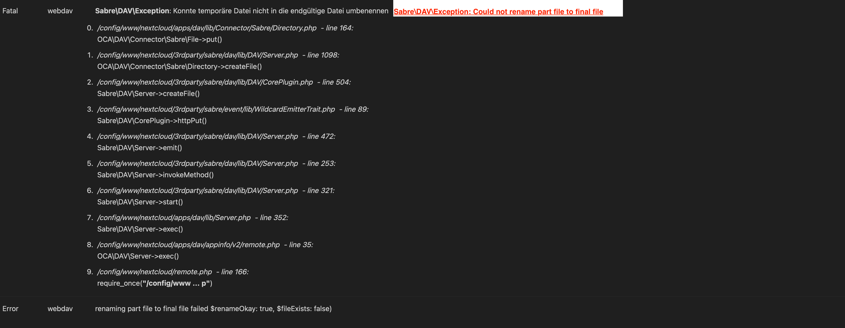

Hello guys!
I am having this error in my log and trying to find a solution to solve it.error.thumb.png.a7f7106f59ff118d809c88094e239ce0.png
This is happening, when people are trying to upload files, but people also had issues to download files.
Unfortunately it's very difficult for me to tell, because over the last weekend a lot of people were uploading and downloading files and a lot of them were reporting, that they had issues. The share that is connect to Nextcloud is a SMB-Share.
I am also using NginxProxyManager, MaridDB and Redis.
Nextcloud Version: 24.0.3
I would be grateful, if anybody could help me, because i didn't find a solution yet.
Thank you!

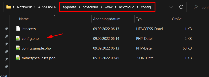

I friends, i need a litle help.
Recently i move my unraid server to a new network (before 192.168.1.x, now 10.10.10.x)
The problem is that my mariadb server is in 10.10.10.x and Nextcloud db config is in the old 192.168.1.x
How can i change this setting? The container doesnt start. Where is the file with the config?
Edited by trosma
/config/www/nextcloud/config/config.php
look for the following entriy
'dbhost' => 'mariadb',
and may also check if your NC db user is allowed from an 10.x ip range (in case its limited there)

my Nextcloud was working previously. However  the current update breaks it in a way where I cant access my Files right now - which is an issue. Nextcloud runs on the Domain https://nextcloud.domain.tld/updater/
I'm running the mentioned docker and tried to update nextcloud withing the UI. However It won't do the job. I'm stuck at
Step 6 is currently in process. Please reload this page later.
So I I tried to searh a bit on how to fix it. It's also mentioned in this thread here, however the only suggestion was "give it a little time" - which doesnt work for me because this message appeard for like a week. Generally it seems like deleting the File within the docker /data/updater-xxxxxx/.step will bring you back to the Updater - which is a step backwards, but it is working.
Than set in in the appdater/nextcloud/www/nextcloud/config/config.php the parameter
'maintenance' => false,
However, If I make a request to to nextcloud dashboard I still see the message Update in progress.
So all I can do is to head over https://nextcloud.domain.tld/updater/ and start the process again - which I did multiple times. I even ssh into the docker and renamed the /data/updater-xxxxxx to a different name. The Folder was than created successfull when I entered the /updater URL and ran the process.
