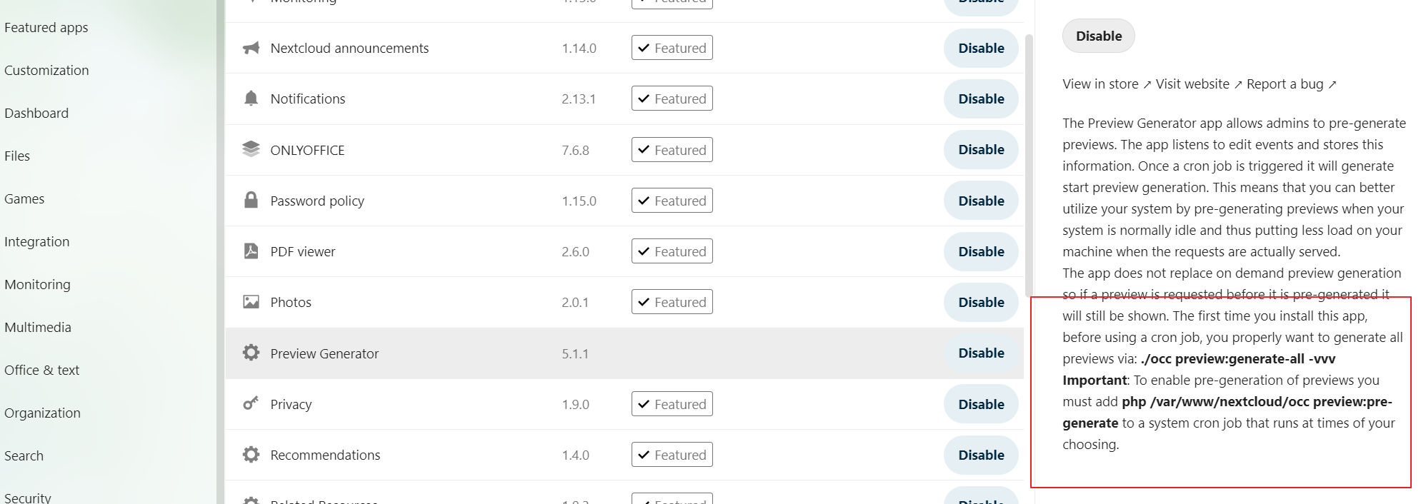

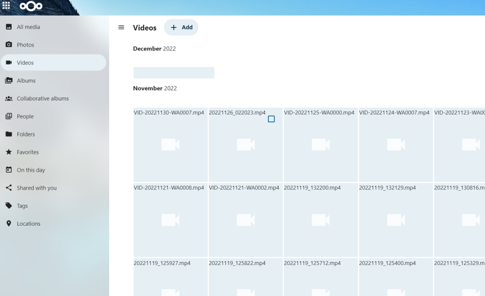

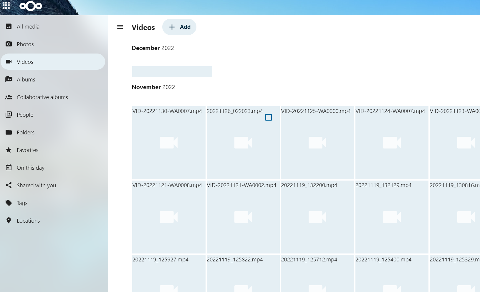

pls see the attached screen shots - they say you need to run commands and create a cron job for preview generator to create previews for the videos:
The first is the instructions in nextcloud when installing preview generatot
The second is a screenshot of how I see the videos previews in my Nextcloud...
Thanks
1043695831_2022-12-27093531.thumb.png.cfb01b5fd4d71540030589dd8473dd69.png1044843323_2022-12-27093820.thumb.png.250a2184b7ba2f2efab6374ecff0af59.png
Edited by guyola
You don't need preview generator at all, this is for generating them in advance but that's not necessary, they'll just be done as required when browsing to where the files are.
