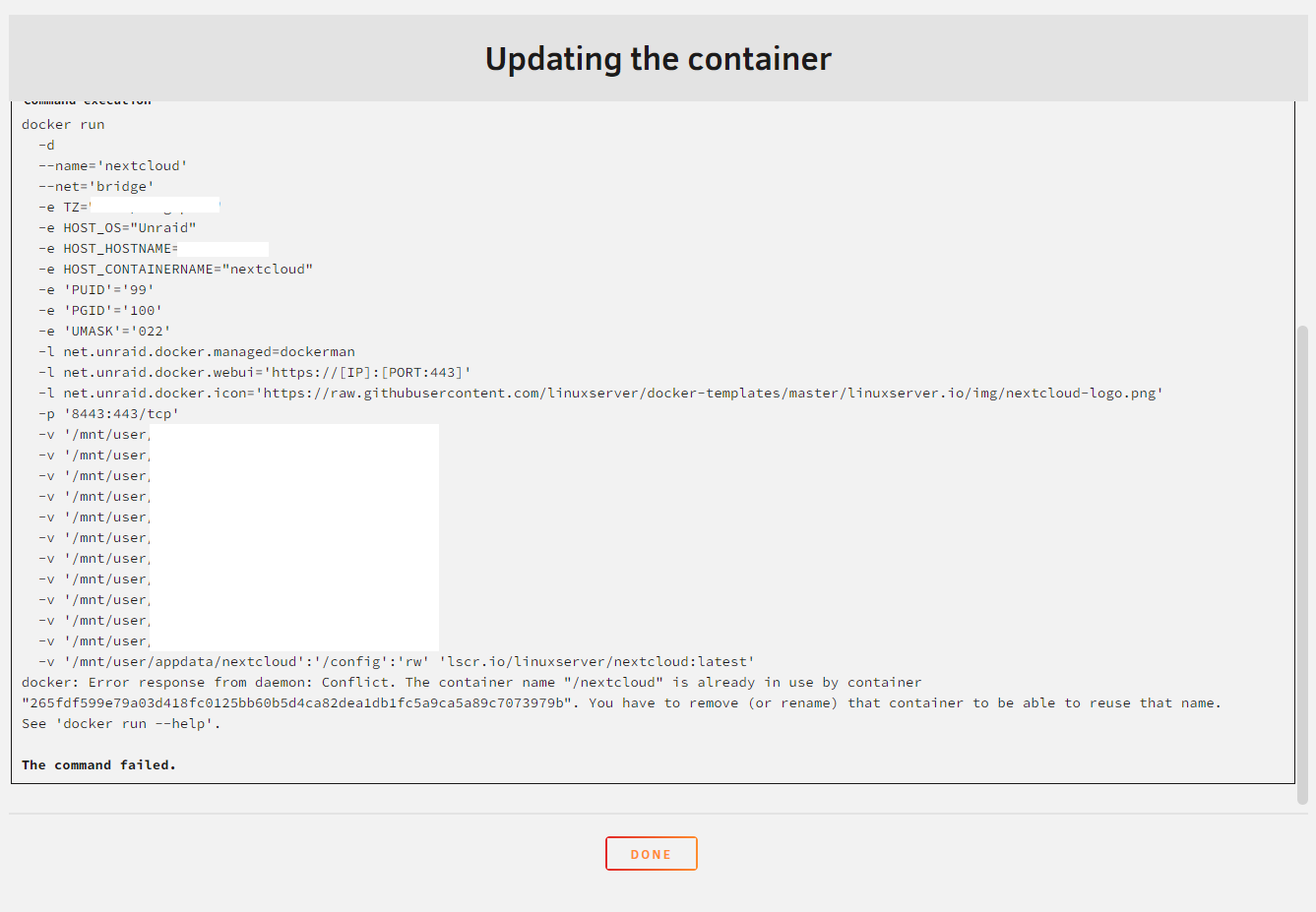

I can't stop nor restart the container. So I tried to "force upgrade" just to see what it output and I got this:
Tried "docker ps" but the docker ID is only 12 characters, not that long like in the picture. Then I tried to downgrade to 25.0.2 and it works fine again. But after an hour, the container is unreachable and I get the execution error again.
What to do?

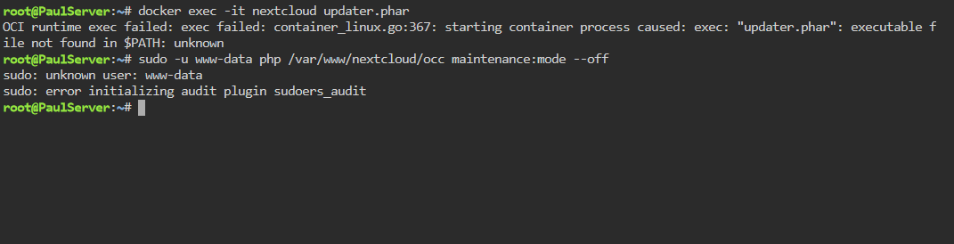

Hello, I also had problems updating nextcloud and the only thing that worked was by running
updater.phar.  via console.
I managed to go up to 25.0.3

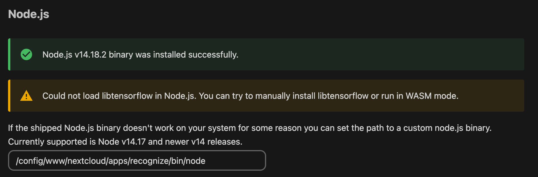

Hi everyone, I am trying to install the Recognize app (for face recognition) and I am getting the following error:
Any idea how I could fix this?
Thanks!
Thanks!
Hi i am also interested. Although it shows this error it seems to work and i get some faces organized and tagged but it goes slow.
And when i click in a tagged foto oft a person it won't show up large. Just this rolling circle all the time.

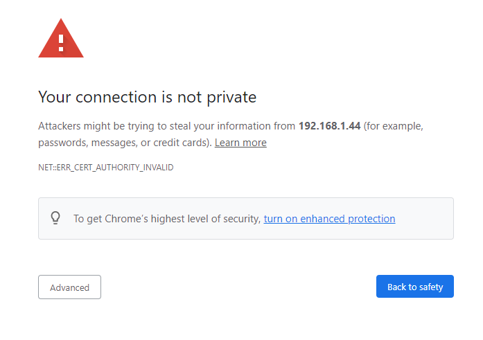

I updated my Nextcloud docker container today, and now I am not able to connect to it.  This is the error I get:
Where should I look in order to try to diagnose this problem? I don't see any errors in the log file.
Any help would be greatly appreciated.
Edited by dius
Do you always connect to your nextcloud via IP adress vor do you use a domain?
It seems there is a ssl certificate error. If you hit advanced you should be able to click in something like go to IP adress unsecure...
Gesendet von meinem Pixel 6 Pro mit Tapatalk
Thanks @Archonw for your help.
In answer to your question, I always use a domain.
If I click on Advanced and try to go to the site I get this error and can't go any further.
Edited by dius

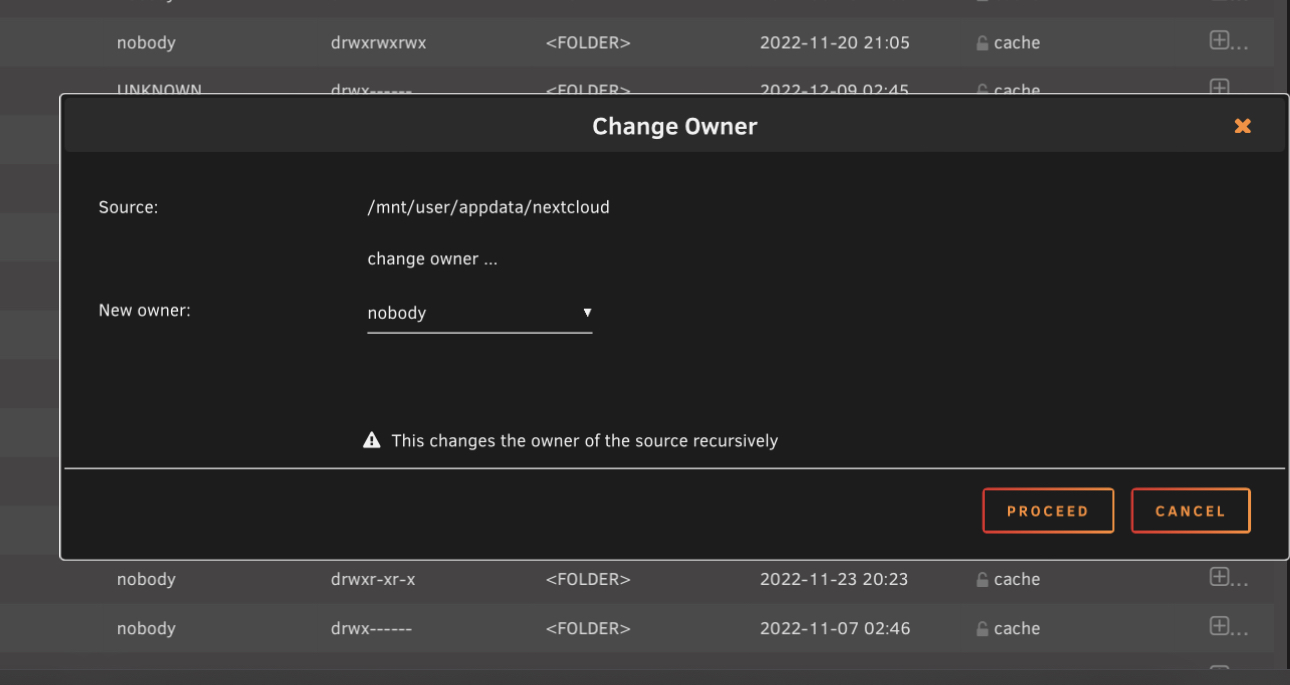

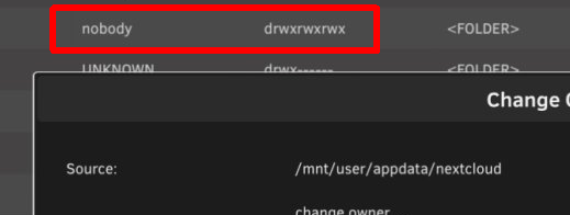

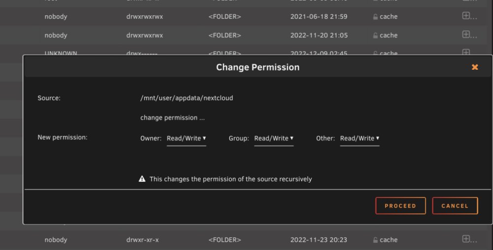

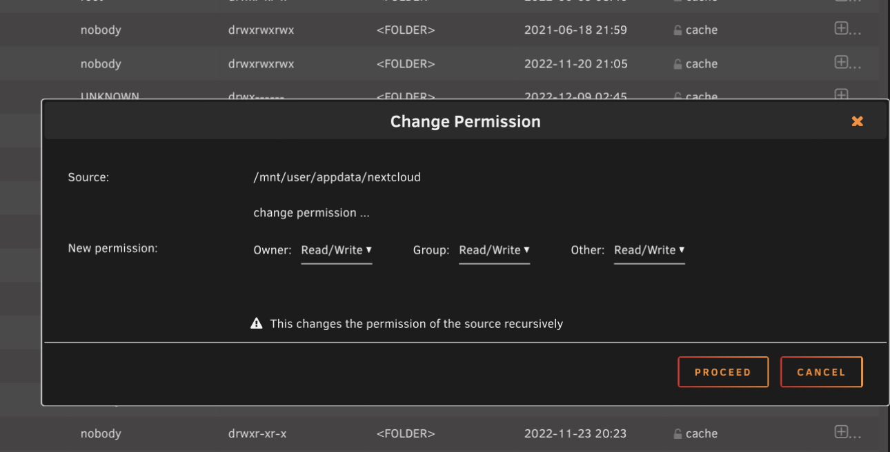

On 12/9/2022 at 11:12 PM, blaine07 said:
In Unraid file manager who does it show has ownership of Nextcloud app data? What is its read write rules?
how do you get it to show you the permissions? mine doesnt show folder permissions. do i have to enable it somewhere?
They are there but the change dialog hides them...
Since there doesn't seem to be any way to fix what has broken on my Nextcloud installation, I was wondering if I could simply remove it, then add it again.  Would that solve my problem?
For the benefit of anyone reading this, my Nextcloud service was working fine.  I always accessed it using a domain.  Just a couple of days ago, I was notified that there was an update to my Nextcloud docker so I went ahead and updated it.  Nextcloud starts just fine.  There are no errors in the log, however I can no longer access it.  It doesn't  matter if I use the domain or the IP address.  The result is the same. It appears that there may be some kind of certificate issue but I have no idea how to debug it it and fix it.  My thinking is that I may just remove it entirely from my Unraid server, then download and install a new one.  I may lose all of my configurations, and may have to figure out how to get Collabora working again, but that may get me back up and running.
Any other recommendations?
