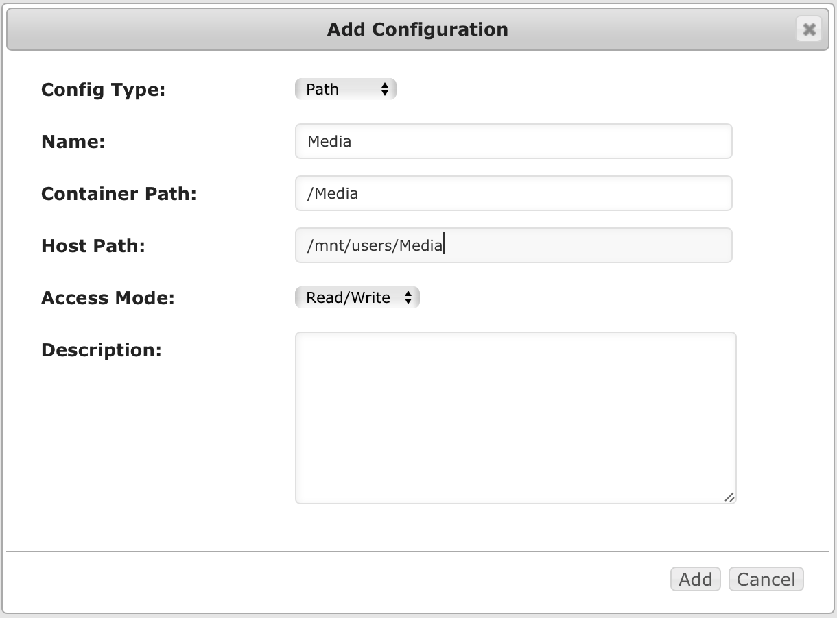

I am trying to add existing shares into the Nextcloud system. I believe I have installed Nextcloud correctly but when I go to add external storage I do not see what to fill in on this places.
I have basically 2 shares in my Unraid, Media, and Home Media, that I want Nextcloud to point to. I don't want to start moving my existing files to a new Nextcloud folder. I just want to open Nextcloud and see my files. Maybe I can't do this with this software but I am really sure I can. I want to use Nextcloud as a personal small scale Google Photo's.

Check out the attached picture. This is done under the Nexcloud Docker. Hit edit and click Add another path at the bottom. Follow the picture below. Then enable External Storage in Nextcloud and add "Local" storage. Under Folder Name you name it anything like "Media" and under Configuration type /Media. It should turn green.
I am posting this to show both tries, my best guess and yours.

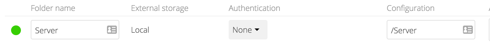

2 minutes ago, blahblah0385 said:
Try not to use spaces under Configuration
Oh crap I think it worked! I figured it was a symantics type issue. I tried the no space thing and it wasn't working and then I restarted Nextcloud to see what would happen and bingo. Thank you.
