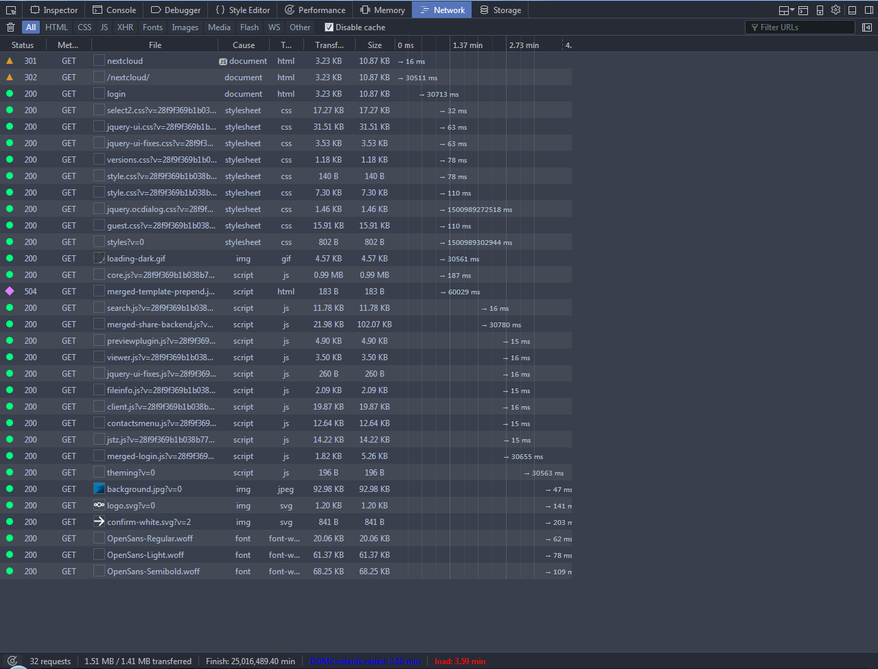

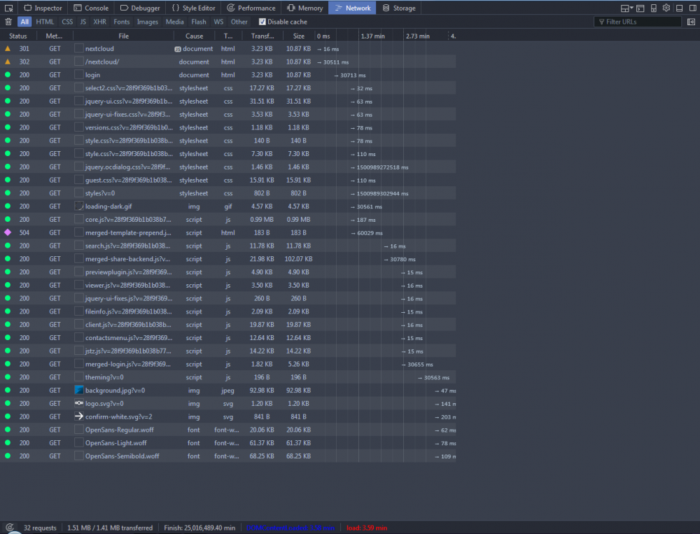

I'm still having slow logon issues getting into nextcloud.
I've just discovered if I use edge to logon, it logs straight in.  Everything is fast.
If I use firefox, it takes 10 minutes just to get to the login screen.
What's going on??
Share this post
Link to post
What's going on??
Take a look at the logs /mnt/user/appdata/nextcloud/log/nginx/error.log and /mnt/user/appdata/nextcloud/log/php/error.log
