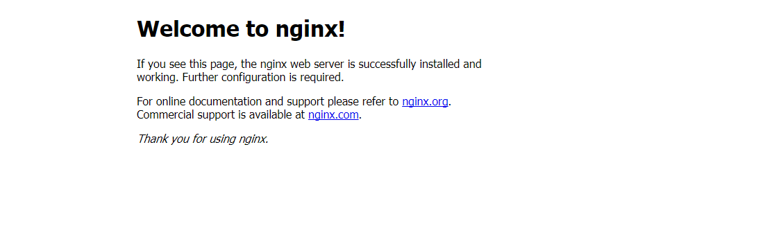

ok, I tried doing this via Let's Encrypt.  I did a bit of googling and I found a config file that 'works' - I can edit docs in Nextcloud, but I can't access the collabora docker at office.mydomain.com although I can via the docker url.  Happy as I can meet the primary objective, but if anyone can explain why config file for office is wrong please I'll be even happier:
server {
	listen 443 ssl;
	server_name office.mydomain.com;
# SSL settings
	ssl_certificate /config/keys/letsencrypt/fullchain.pem;
	ssl_certificate_key /config/keys/letsencrypt/privkey.pem;
	ssl_dhparam /config/nginx/dhparams.pem;
	ssl_protocols TLSv1.2;
	ssl_ciphers 'ECDHE-RSA-AES128-GCM-SHA256:ECDHE-ECDSA-AES128-GCM-SHA256:ECDHE-RSA-AES256-GCM-SHA384:ECDHE-ECDSA-AES256-GCM-SHA384:DHE-RSA-AES128-GCM-SHA256:DHE-DSS-AES128-GCM-SHA256:kEDH+AESGCM:ECDHE-RSA-AES128-SHA256:ECDHE-ECDSA-AES128-SHA256:ECDHE-RSA-AES128-SHA:ECDHE-ECDSA-AES128-SHA:ECDHE-RSA-AES256-SHA384:ECDHE-ECDSA-AES256-SHA384:ECDHE-RSA-AES256-SHA:ECDHE-ECDSA-AES256-SHA:DHE-RSA-AES128-SHA256:DHE-RSA-AES128-SHA:DHE-DSS-AES128-SHA256:DHE-RSA-AES256-SHA256:DHE-DSS-AES256-SHA:DHE-RSA-AES256-SHA:AES128-GCM-SHA256:AES256-GCM-SHA384:AES128-SHA256:AES256-SHA256:AES128-SHA:AES256-SHA:AES:CAMELLIA:DES-CBC3-SHA:!aNULL:!eNULL:!EXPORT:!DES:!RC4:!MD5:!PSK:!aECDH:!EDH-DSS-DES-CBC3-SHA:!EDH-RSA-DES-CBC3-SHA:!KRB5-DES-CBC3-SHA';
	ssl_prefer_server_ciphers on;
	client_max_body_size 0;
# static files
	location ^~ /loleaflet {
		proxy_pass https://192.168.50.74:9980;
		proxy_set_header Host $http_host;
# WOPI discovery URL
	location ^~ /hosting/discovery {
# main websocket
	location ~ ^/lool/(.*)/ws$ {
		proxy_set_header Upgrade $http_upgrade;
		proxy_set_header Connection "Upgrade";
		proxy_read_timeout 36000s;
# download, presentation and image upload
	location ~ ^/lool {
# Admin Console websocket
	location ^~ /lool/adminws {
5a7053ce141d4_FireShotCapture52-Welcometonginx!-https___office.the-shepherds.com_.thumb.png.196a86875c1aa900d3482eaa52c824b2.png
Link to comment
