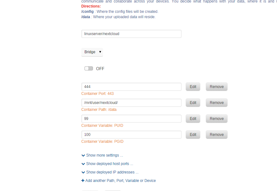

I have been trying to follow the nextcloud setup guide found here:
https://www.linuxserver.io/2016/07/28/installing-nextcloud-on-unraid/
I'm not able to get past the nextcloud install portion.
The log shows this:
[cont-init.d] 10-adduser: exited 0.
[cont-init.d] 20-config: executing...
[cont-init.d] 20-config: exited 0.
[cont-init.d] 30-keygen: executing...
using keys found in /config/keys
[cont-init.d] 30-keygen: exited 0.
[cont-init.d] 40-config: executing...
[cont-init.d] 40-config: exited 0.
[cont-init.d] 50-install: executing...
% Total % Received % Xferd Average Speed Time Time Time Current
Dload Upload Total Spent Left Speed
tar: /tmp/nextcloud.tar.bz2: Cannot open: No such file or directory
tar: Error is not recoverable: exiting now
[cont-init.d] 50-install: exited 0.
[cont-init.d] 60-memcache: executing...
cp: cannot create regular file '/config/www/nextcloud/config/config.php': No such file or directory
chown: cannot access '/config/www/nextcloud/config/config.php': No such file or directory
[cont-init.d] 60-memcache: exited 1.
[cont-init.d] done.
[services.d] done.
Could not open input file: /config/www/nextcloud/cron.php
Config files are not getting generated.
nginx error log shows this:
2018/02/11 22:08:25 [error] 317#317: *2 directory index of "/config/www/nextcloud/" is forbidden, client: 192.168.1.53, server: _, request: "GET / HTTP/1.1", host: "192.168.1.238:444", referrer: "http://unraid01.local/Docker"
2018/02/11 22:08:25 [error] 317#317: *2 FastCGI sent in stderr: "Primary script unknown" while reading response header from upstream, client: 192.168.1.53, server: _, request: "GET / HTTP/1.1", upstream: "fastcgi://127.0.0.1:9000", host: "192.168.1.238:444", referrer: "http://unraid01.local/Docker"
2018/02/11 22:08:25 [error] 317#317: *2 open() "/config/www/nextcloud/favicon.ico" failed (2: No such file or directory), client: 192.168.1.53, server: _, request: "GET /favicon.ico HTTP/1.1", host: "192.168.1.238:444", referrer: "https://192.168.1.238:444/"
2018/02/11 22:08:25 [error] 317#317: *2 FastCGI sent in stderr: "Primary script unknown" while reading response header from upstream, client: 192.168.1.53, server: _, request: "GET /favicon.ico HTTP/1.1", upstream: "fastcgi://127.0.0.1:9000", host: "192.168.1.238:444", referrer: "https://192.168.1.238:444/"
2018/02/11 22:08:28 [error] 317#317: *2 directory index of "/config/www/nextcloud/" is forbidden, client: 192.168.1.53, server: _, request: "GET / HTTP/1.1", host: "192.168.1.238:444", referrer: "http://unraid01.local/Docker"
2018/02/11 22:08:28 [error] 317#317: *2 FastCGI sent in stderr: "Primary script unknown" while reading response header from upstream, client: 192.168.1.53, server: _, request: "GET / HTTP/1.1", upstream: "fastcgi://127.0.0.1:9000", host: "192.168.1.238:444", referrer: "http://unraid01.local/Docker"
2018/02/11 22:09:43 [error] 317#317: *7 directory index of "/config/www/nextcloud/" is forbidden, client: 192.168.1.53, server: _, request: "GET / HTTP/1.1", host: "192.168.1.238:444", referrer: "http://unraid01.local/Docker"
2018/02/11 22:09:43 [error] 317#317: *7 FastCGI sent in stderr: "Primary script unknown" while reading response header from upstream, client: 192.168.1.53, server: _, request: "GET / HTTP/1.1", upstream: "fastcgi://127.0.0.1:9000", host: "192.168.1.238:444", referrer: "http://unraid01.local/Docker"
2018/02/11 22:17:51 [error] 317#317: *19 directory index of "/config/www/nextcloud/" is forbidden, client: 192.168.1.53, server: _, request: "GET / HTTP/1.1", host: "192.168.1.238:444", referrer: "http://unraid01.local/Docker"
2018/02/11 22:17:51 [error] 317#317: *19 FastCGI sent in stderr: "Primary script unknown" while reading response header from upstream, client: 192.168.1.53, server: _, request: "GET / HTTP/1.1", upstream: "fastcgi://127.0.0.1:9000", host: "192.168.1.238:444", referrer: "http://unraid01.local/Docker"
2018/02/11 22:25:47 [error] 316#316: *3 directory index of "/config/www/nextcloud/" is forbidden, client: 172.17.0.1, server: _, request: "GET /nextcloud/ HTTP/1.1", host: "192.168.1.238:443"
2018/02/11 22:25:47 [error] 316#316: *3 FastCGI sent in stderr: "Primary script unknown" while reading response header from upstream, client: 172.17.0.1, server: _, request: "GET /nextcloud/ HTTP/1.1", upstream: "fastcgi://127.0.0.1:9000", host: "192.168.1.238:443"
2018/02/11 22:26:02 [error] 316#316: *5 directory index of "/config/www/nextcloud/" is forbidden, client: 172.17.0.1, server: _, request: "GET /nextcloud/ HTTP/1.1", host: "192.168.1.238:443"
2018/02/11 22:26:02 [error] 316#316: *5 FastCGI sent in stderr: "Primary script unknown" while reading response header from upstream, client: 172.17.0.1, server: _, request: "GET /nextcloud/ HTTP/1.1", upstream: "fastcgi://127.0.0.1:9000", host: "192.168.1.238:443"
2018/02/11 22:39:03 [error] 314#314: *2 directory index of "/config/www/" is forbidden, client: 192.168.1.53, server: _, request: "GET / HTTP/1.1", host: "192.168.1.238:444", referrer: "http://unraid01.local/Docker"
2018/02/11 22:39:03 [error] 314#314: *2 FastCGI sent in stderr: "Primary script unknown" while reading response header from upstream, client: 192.168.1.53, server: _, request: "GET / HTTP/1.1", upstream: "fastcgi://127.0.0.1:9000", host: "192.168.1.238:444", referrer: "http://unraid01.local/Docker"
2018/02/11 22:39:14 [error] 313#313: *4 directory index of "/config/www/nextcloud/" is forbidden, client: 172.17.0.1, server: _, request: "GET /nextcloud/ HTTP/1.1", host: "192.168.1.238:443"
2018/02/11 22:39:14 [error] 313#313: *4 FastCGI sent in stderr: "Primary script unknown" while reading response header from upstream, client: 172.17.0.1, server: _, request: "GET /nextcloud/ HTTP/1.1", upstream: "fastcgi://127.0.0.1:9000", host: "192.168.1.238:443"
2018/02/11 22:40:00 [error] 314#314: *2 directory index of "/config/www/" is forbidden, client: 192.168.1.53, server: _, request: "GET / HTTP/1.1", host: "192.168.1.238:444", referrer: "http://unraid01.local/Docker"
2018/02/11 22:40:00 [error] 314#314: *2 FastCGI sent in stderr: "Primary script unknown" while reading response header from upstream, client: 192.168.1.53, server: _, request: "GET / HTTP/1.1", upstream: "fastcgi://127.0.0.1:9000", host: "192.168.1.238:444", referrer: "http://unraid01.local/Docker"
I tried uninstalling the docker app and reinstalling it, but the results are the same.
I'm not sure what I'm missing.
The log shows this:
Based on the post time, I think Snipe3000 and I had this issue at about exactly the same time - finally gave up and went to bed. My Nextcloud log looks identical. I didn't check the nginx logs, but I did take a look in the Unraid filesystem and the /appdata/nextcloud/config folder never got created. This is also a brand new install, for whatever that's worth.
