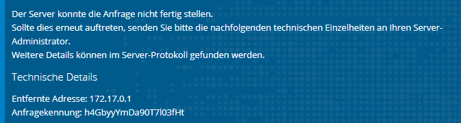

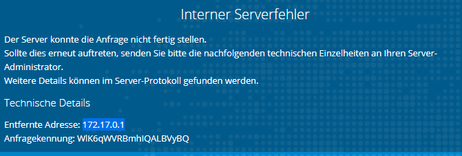

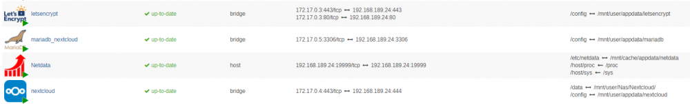

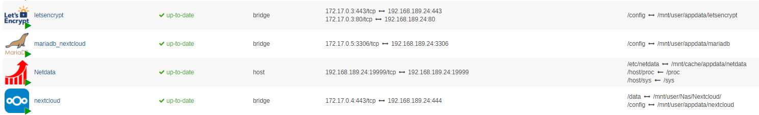

Hello together,
Today i decided to install a secound Maria DB Docker for Wordpress. Therefore i renamed my docker from mariadb to mariadb_nextcloud
After That i get this error message:
And now im confused because i dont find anything that leads me to the Problem.
Maybe the MariaDB switched from     172.17.0.1 to 172.17.0.5 but im not sure. Where does this ipadress even come from?
Furthermore i found this:
2018/04/13 20:09:57 [error] 379#379: *452 connect() failed (111: Connection refused) while connecting to upstream, client: 86.9.5.68, server: _, request: "GET /nextcloud/ HTTP/1.1", upstream: "https://192.168.189.24:444/nextcloud/", host: "ben-home.duckdns.org"
Regards
Bengele
PS.: Thank you for all you armazing work :)

3 hours ago, bengele said:
Hello together,
Regards
Bengele
Nextcloud config: config.php
Maria config: custom.cnf
letsencrypt config: default

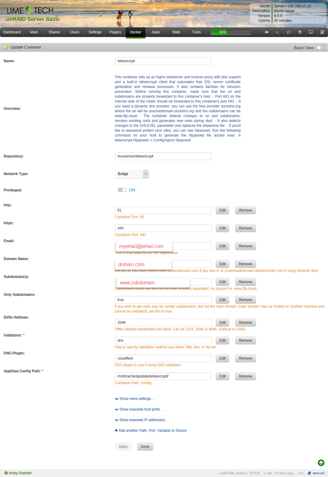

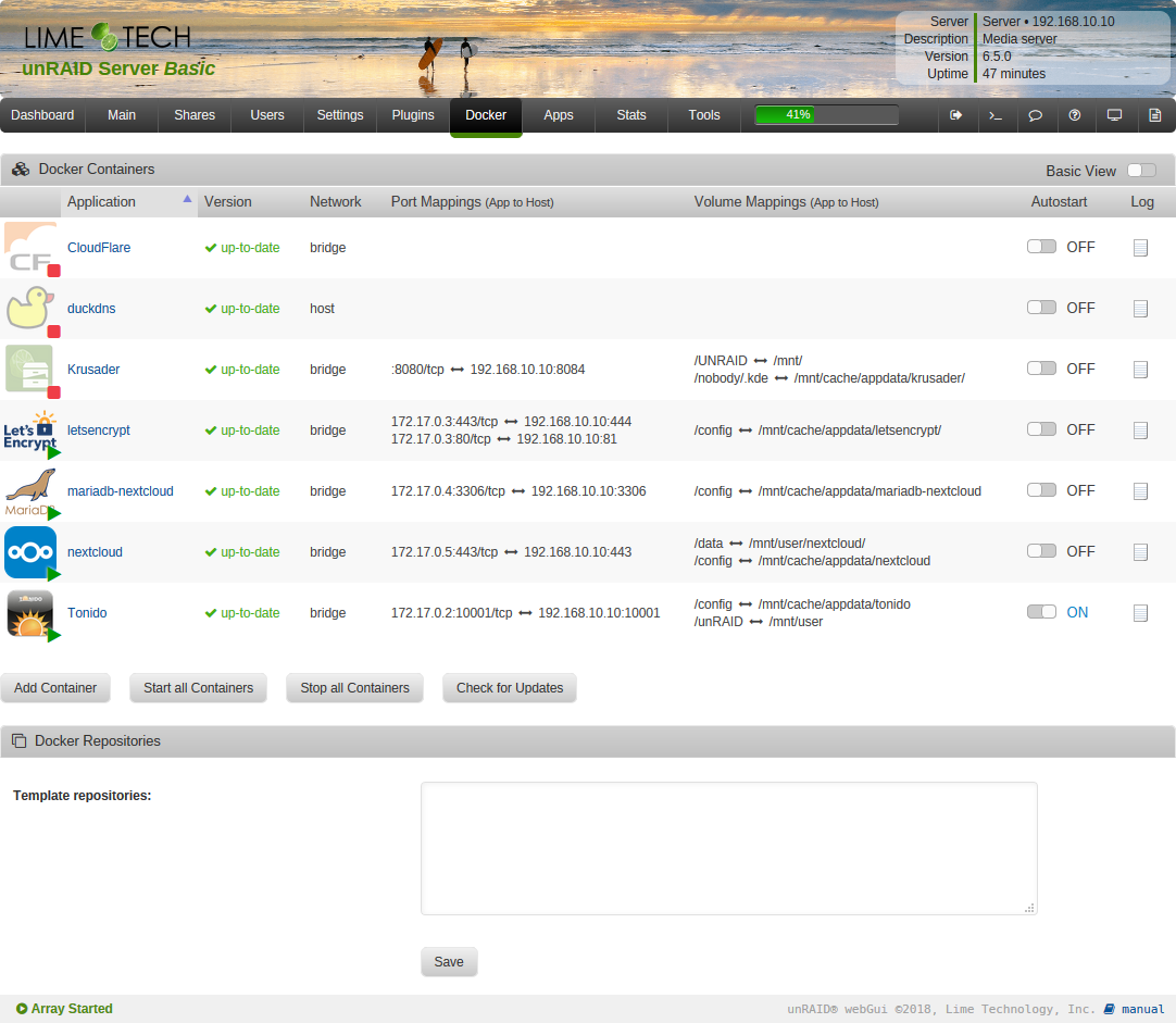

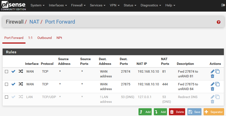

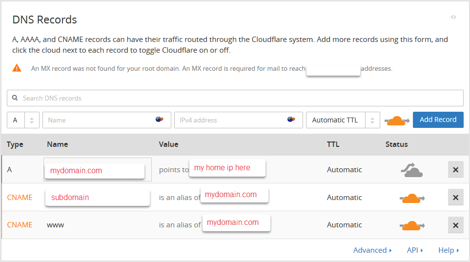

Thank you for the above posts -- there's a lot to read and sort through.
I have not been able to get Nextcloud to work by accessing it from the WAN on a subdomain.
I've been trying to get this to work today with limited success because my home unRAID server is on a COX residential internet connection that blocks incoming connections to ports 80 and 443.
So I scanned 76 pages of posts here
https://lime-technology.com/forums/topic/51808-support-linuxserverio-letsencrypt-nginx/?page=76
and found that, to remedy the ports being blocked by my ISP, I had to purchase a domain name, make a cloudflare account, and point the DNS servers in the domain name registrar to cloudflare.
Then I worked on LetsEncrypt. Some notes that were helpful to me in this process:
Try changing /mnt/user/appdata/letsencrypt/ to /mnt/cache/appdata/letsencrypt/
set cloudflare to "dns only".
In the letsencrypt docker settings, choose dns validation and then put 'cloudflare' in dns-plugin field
In the letsencrypt dns-conf config folder, edit the cloudflare.ini file and enter your cloudflare email and the global api key you can grab from their site. DNS validation will take care of everything automatically.
Then some port forwarding at home: I set up my pfSense router update cloudflare with my dynamic IP. Then in pfSense forwarded ports from the WAN to the LAN unRAID box. As COX blocks 80 and 443, I chose to replace 80 with 27874 and forwarded to unRAID box on 81 and replace 443 with 27875 and forward to unRAID box on 444.
Then I followed the guide at https://cyanlabs.net/tutorials/the-complete-unraid-reverse-proxy-duck-dns-dynamic-dns-and-letsencrypt-guide/
to set up letsencrypt and ngnix (ignoring duckdns as I can't use that due to COX and use cloudflare instead)
After this, I am able to view the ngnix default page if I point a browser (from outside my network) to https://mydomain.com:27875
Then the guide at https://blog.linuxserver.io/2017/05/10/installing-nextcloud-on-unraid-with-letsencrypt-reverse-proxy/
to set up nextcloud. At this point, if I don't follow the steps for "Setting Up A Letsencrypt Reverse Proxy" then I can access nextcloud from its UI from the unRAID Docker page. However, after following the "Setting Up A Letsencrypt Reverse Proxy" instructions then I lose that ability and the ability to access nextcloud from the WAN.
So, at this point I am not sure how to get subdomain.mydomain.com to resolve to NextCloud on my unRAID box.
I've posted screen grabs of the pfSense router NAT forwarding, the cloudflare setup, the LetsEncrypt docker setup, the NextCloud docker setup, and the dockers page.
I've also posted the logs from LetsEncrypt and NextCloud.
nextcloud-log.txt
letsencrypt-log.txt
19 hours ago, Seige said:
I am not an expert, but is the second MariaDB container running on a separate port, or also 3306? Maybe also change the db host to your unraid ip instead of going through your internet domain. You can edit that in the config.php.
The 172.x.x.x ips are the “internal” ips unraid uses if you use a bridged network connection, e.g. if you want to forward a container port to a different external port.
out of curiosity, do you access the unraid web interface unencrypted? Cause port 80 is exposed and that is usually reserved for that. To be fair you intercept that with let’s Encrypt.
Hello Seige,
the 2. maria db is not installed yet. I just renamed my maria db and then i checked if everything still works.
The biggest Question is why Nextlcoud is refering to a internal ip which isnt listed anywhere.
I used grep -ri -l "172.17.0.1" in my appdata location to find anything about this ipadress, but the error log wich i posted above.
I moved my unraid port to 81 and 444
Regards
Bengele
Edited by bengele

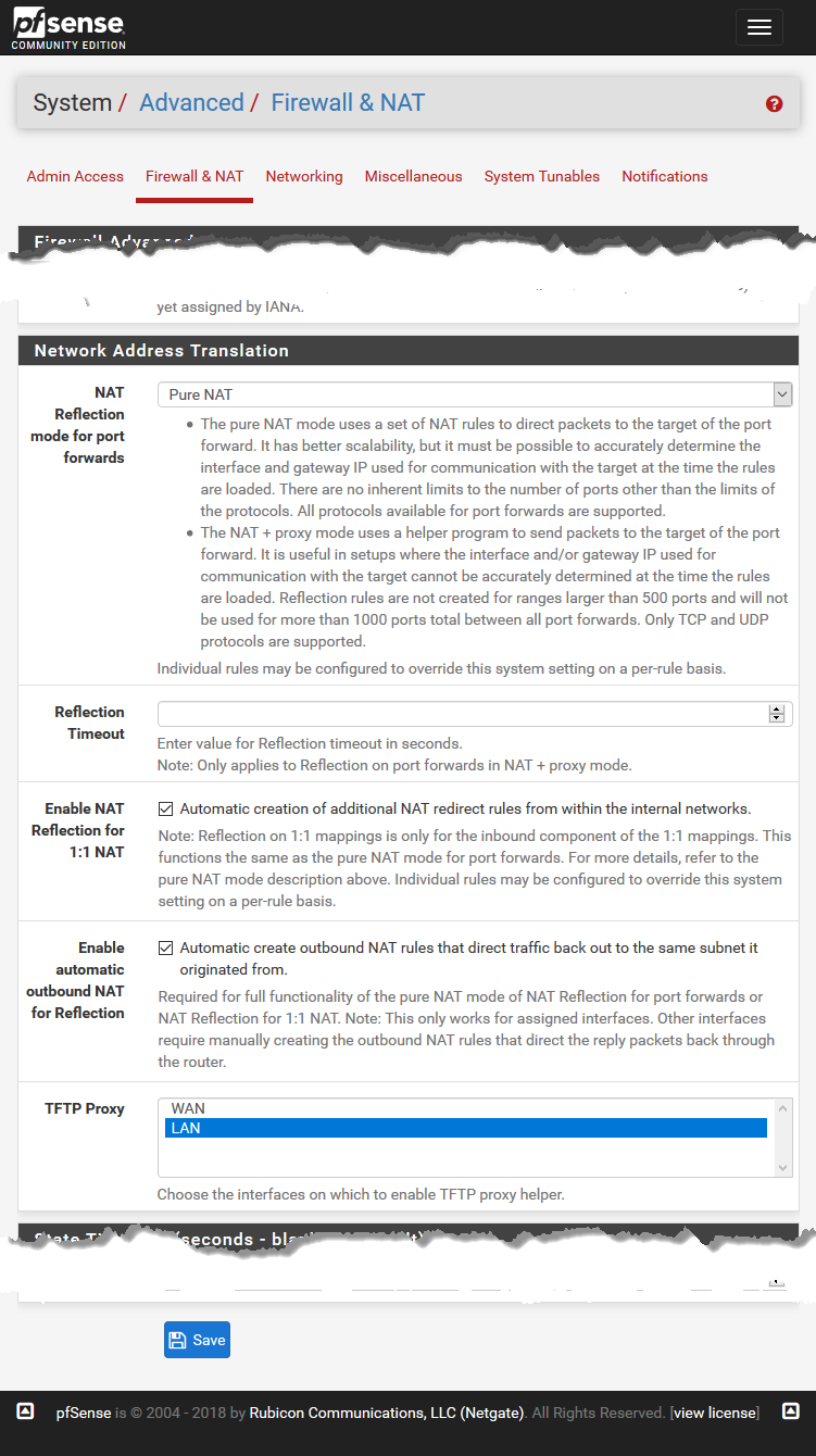

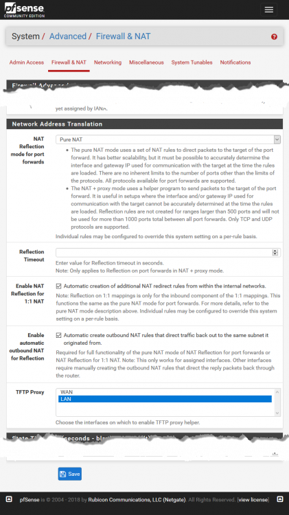

16 minutes ago, CHBMB said:
You need to setup NAT reflection on your pfsense box.
Thank you for suggesting that. I believe I have already set that up:
I think there must be something going wrong in the path to get from WAN to my NextCloud instance. As I understand it, this should go from WAN --> DNS --> CloudFlare --> subdomain --> My IP --> pfSense --> unRAID --> LetsEncrypt --> NextCloud
I'm not sure how to make sure traffic is flowing 1) to the subdomain, 2) to the port I've specified for pfSense to forward to the unRAID box (WAN 27875 to LAN unRAID 444), 3) from port 444 on the unRAID box through LetsEncrypt to the NextCloud instance.
My thinking on this may be wrong though. I am admittedly a layman and this seems a little complex...

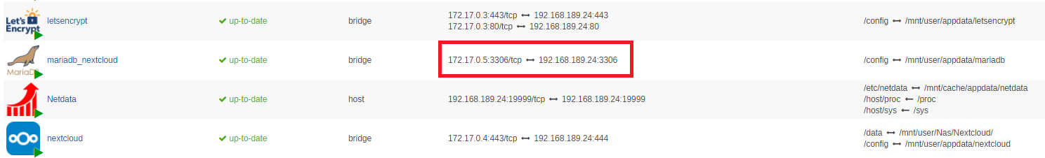

You can see the internal ips in your Docker overview. This is how network bridges are handled in unRaid. I highlighted the one of MariaDB:
image.png.c15f656e87118c51a11bdba68c0407ec.thumb.png.8f31f7414e7bba8fe2879126f10f1444.png
Please try to edit your config.php as suggested and replace the line of:
 'dbhost' => 'ben-server',
with
 'dbhost' => '192.168.189.24',
This at least avoids any issues with Nextcloud having to resolve your domain. If it does not work you can try to add the port also and remove the port from the subsequent line, which leads to:
'dbhost' => '192.168.189.24:3306',
'dbport' => '',
Please try this and let me know if it works.
P.S.: If unRaid's webinterface is on 444 then, according to your docker overview, Nextcloud is using the same port. If this is so, you have to change one of either.
with
'dbport' => '',
