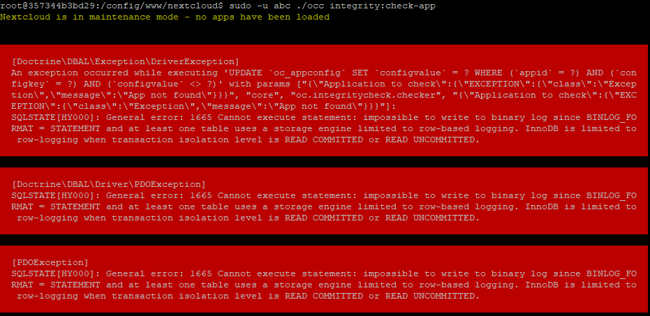

also this is my list of addons:
but on a integry check i got this:
It seems he cant connect to my db anymore
After googling the sql error it seems that my mariadb ignores the config:
Then i tryed to lo into the docker and check the table
Now the Question is why he ignores it
Thaks for the help so far
Regards Bengele
Edited by bengele
Regards Bengele
And now comes the solution:
docker exec -it mariadb_nextcloud bash
root@39e01f2500e2:/config# ls -l custom.cnf
-rw-rw-rw- 1 abc users 3753 Mar 29 02:17 custom.cnf
root@39e01f2500e2:/config# sudo chmod 644 custom.cnf
Im still wondering what messed up my permissions and that was a hell of searching for solutions
Thanks for you help Seige
Regards
Bengele
