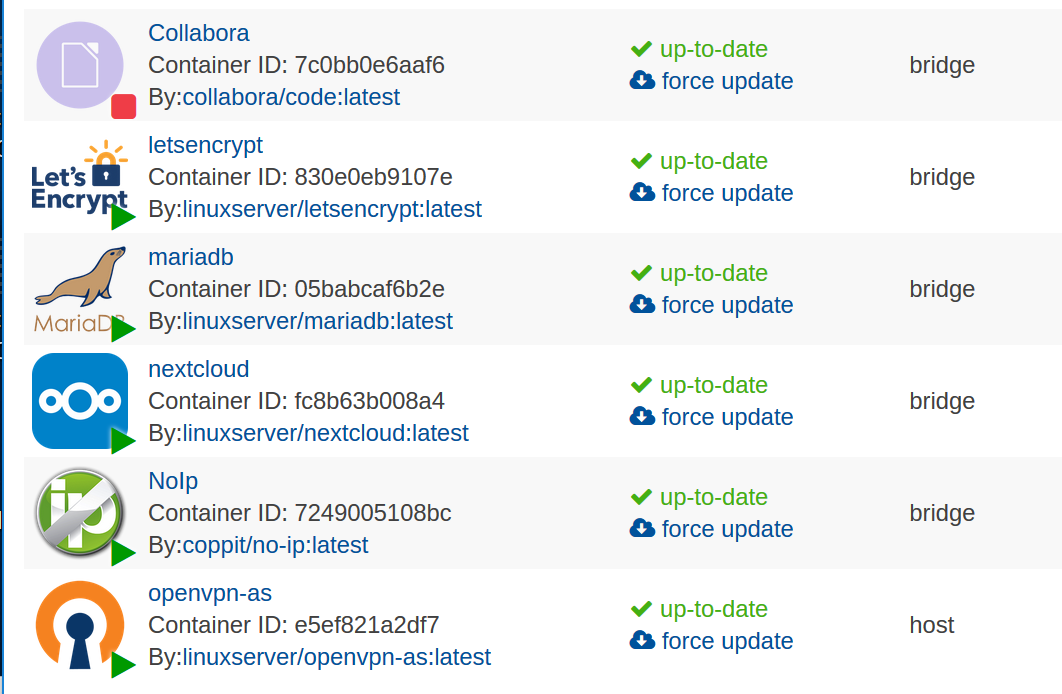

Figured out my problem, now I got it working but with a tiny bug which is annoying. When i try to connect but type I type www. first it does not work?
On 5/1/2018 at 3:32 PM, M4ST3R-OWNER said:
Ok after messing more around with it I found more problems. My main use for this is on my iPhone's for just backup of photos and videos to help clear space and still have access on the go. I use a vpn for everything on my unraid server so like my apps all work without having to port forward everything. But for some reason i'm getting a connection error when I try to connect using my vpn. I'm guess maybe I need add something in openVPN network settings? Anyone got a clue?
Anyone else with same problem? It worked just fine with my vpn setup on openvpn but now for some reason its not letting me connect to nextcloud. I can use all my other apps just fine.

40 minutes ago, CHBMB said:
You sure that's our container?  It says owncloud rather a lot.
I know it's weird!
I'm sure it's from your repository because these are the only docker I have installed on that server
5 minutes ago, byographic said:
I know it's weird!
I got no idea to be honest.  I've been running this since before we released it and not encountered that issue.  Tried a trusty google of the error messages?
I’ve tried google it without any luck for now.
The only idea I have is:
lately I`m syncing large files 3+ gb each so either the server has to little RAM (only 4GB) but I will expand it to 12 GB next week or the php memory is to low (512mb)
Or something happened after I’ve updated to 13.0.2
