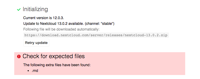

Has anyone had this problem before?
it won't let me update.

    After tinkering with this for a while, it seems the solution is much simpler than I thought. For some reason, the only step required is to modify the config.php file. No need to install ffmp
ah ok.
sorry where would these be found?

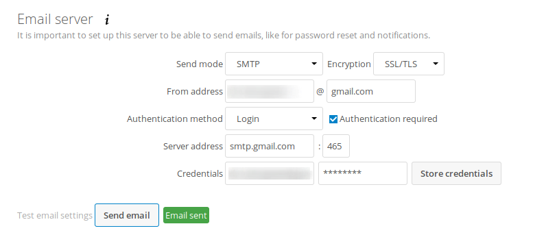

I'm trying to setup sending notifications via email and I'm having some trouble. When I try setting it up using 'PHP' as the send mode I get the following error:
A problem occurred while sending the email. Please revise your settings. (Error: Email could not be sent. Check your mail server log)
Then when I try using SMTP with credentials I know are working with unraid I get this error:
A problem occurred while sending the email. Please revise your settings. (Error: Connection could not be established with host smtp.office365.com [ #0])
Also when I go into the command line of the nextcloud container and execute sendmail - I get the following error:
root@9a505c8431e9:/$ sendmail -
sendmail: can't connect to remote host (127.0.0.1): Connection refused
This is also true if I try sending an email via php:
root@9a505c8431e9:/$ php -a
Interactive shell
php > mail('[email protected]', 'test', 'test 123');
The nexcloud log files did not contain any additional information even after adding 'mail_smtpdebug' => true, in the config.php file. I'm kind of stuck and hoping someone here can point me in the right direction.

Works out the box for me....
On 5/22/2018 at 5:56 PM, gareth_iowc said:
ah ok.
Depends on where you keep your app directory but for me it is
/mnt/user/appdata/nextcloud/www/nextcloud

Is there anywhere else I can loog for log files? I've tried /var/log/nginx/error.log, /config/log/nginx/error.log, /config/log/php/error.log and none of them seem to have any output. Maybe you have some suggested ideas for debugging? I tried telnet, but noticed it's not installed. The only thing I've changed from the inital setup is the port mapping (goes from 443 to 5050 on the host).
Try using it with a different email provider to check. I know Gmail you have to turn off secure settings to enable things like Nextcloud to utilise the SMTP servers and wondering if it's a similar issue
I tried also with MS Office 365 and I got the following error:
The weird thing is that I can ping it just fine from inside the nextcloud container. Also when I try to run sendmail from the container I immediately see the error:
which is leading me to believe that there some kind of configuration issue in the container. I'm able to use sendmail from the unraid command line just fine though.

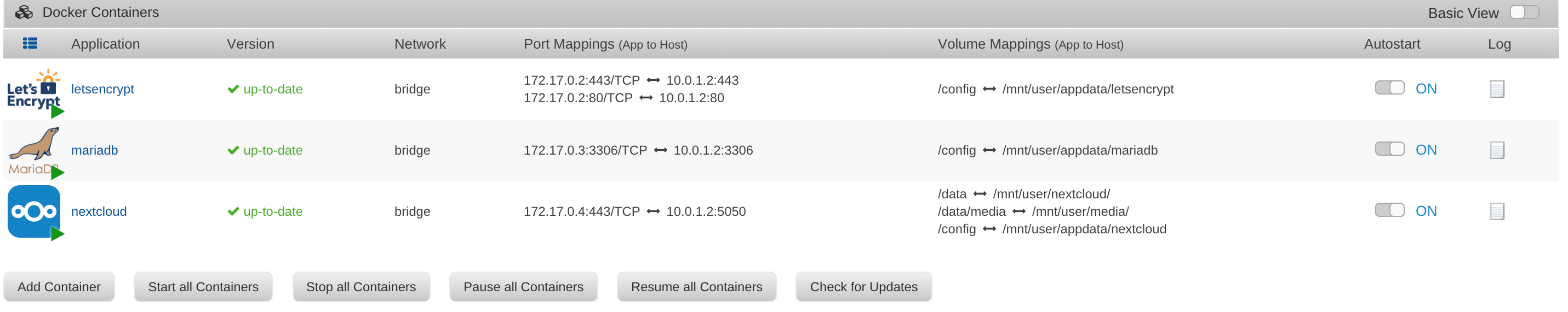

Here's the docker run command:
root@localhost:# /usr/local/emhttp/plugins/dynamix.docker.manager/scripts/docker run -d --name='nextcloud' --net='bridge' -e TZ="America/Chicago" -e HOST_OS="unRAID" -e 'PUID'='99' -e 'PGID'='100' -p '5050:443/tcp' -v '/mnt/user/nextcloud/':'/data':'rw' -v '/mnt/user/media/':'/data/media':'rw' -v '/mnt/user/appdata/nextcloud':'/config':'rw' 'linuxserver/nextcloud'
250329965a71ed8d09b073e5cee8915dbc0e3dc8d54f77d14e10bcc00767dc2f
I'll also try switching to the cache path and see if that helps and report back.

So after days of trying to figure out why email isn't working I found that the issue is actually the fact that SSL/TLS are grouped into the same dropdown in nextcloud. MS Office uses tls on port 587, but when you select SSL/TLS it writes 'ssl' in the config file. Changing to STARTTLS fixes this. It's a little unintuitive since all the smtp info for Office says to use TLS for port 587 (not STARTTLS, TBH not sure of the difference).
I still cannot get just the plain php mail option to work...but we'll be using smtp anyways...so not a big deal.
@CHBMB thanks for your help trying to debug this!
