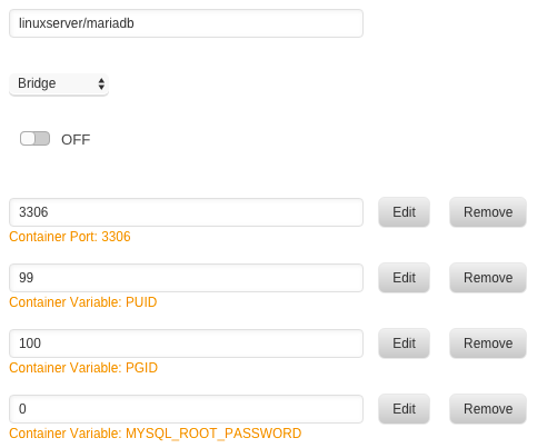

exactly, I placed a password that's very familiar to me, and it didn't work when I execute mysql -uroot -p.  I then tried to change the password on the mariadb docker container, then restarted mariadb docker container, and used the new password with mysql -uroot -p, still, it doesn't work.
Will there be a problem if I delete the mariadb docker container totally, and recreated it, and assign a new password instead?

I think deleting and setting up from scratch is best. I think you can only set the password at first boot of the container if I remember correctly. Be sure to use /mnt/cache for the appdata.

I newly created a mariadb container, leaving the default root password at 0.  Tried to execute mysql -uroot -p, and entering the password 0 gives me ERROR 1045 (28000): Access denied for user 'root'@'localhost' (using password: YES)
if the password is less than 4 characters it defaults to no password as per the docker logs on 1st startup
use
mysql -uroot
i strongly suggest setting a password
you can't do it by changing the variable in an existing container use the mysqladmin tool as per the readme and the logs
https://github.com/linuxserver/docker-mariadb#setting-up-the-application
i also suggest you read the logs and the readme for any container as a matter of course and save yourself a lot of needless troubles

@sparklyballs, thanks for pointing me to the log file, and pointing out that any password less than 4 characters is considered none.
@saarg, thanks for the patience.  So to change the password, mysqladmin is the way to go.  Furthermore, after changing the password, mariadb docker container has to be restarted once again.  I overlooked this.
Thanks to you!  Will setup the next few steps ?

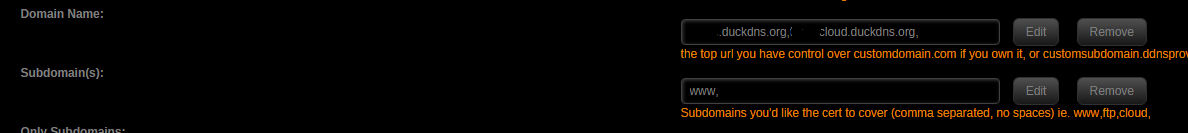

Ok looking for a little bit of help. I started trying to get this all working again using the directions. I started from scratch with it all and got nextcloud and the db up and running without a problem. I had my letsencrypt up and running before hand as i was using it for other containers like ombi etc. I then put in the suggested file with my updated server info and now im getting the following error in the logs
Requested domain is not a FQDN because it contains an empty label.
ERROR: Cert does not exist! Please see the validation error above. The issue may be due to incorrect dns or port forwarding settings. Please fix your settings and recreate the container

I own my domain so not a pro with duckdns but I think the "Domain name" should be "tazire.duckdns.org" and "Subdomain(s)" should be "www,nextcloud"

to access nextcloud, are you trying to use mynextcloud.duckdns.org or nextcloud.tazire.duckdns.org ?
nextcloud.tazire.duckdns.org would be a subdomain.
mynextcloud.duckdns.org would be a different domain and I think you need a separate letsencrypt instance for that.

i tried it both ways. ideally i wanted mynextcloud.duckdns.org but i also want to use tazire.duckdns.org/container for my other dockers
Pick one :)
I suggest nextcloud.tazire.duckdns.org because I don't know how to setup two letsencrypt on the same unraid :P
you'll need to doublecheck config.php and nextcloud to make sure the domain is correct everwhere.
I think the error ERROR: Cert does not exist! Please see the validation error above. The issue may be due to incorrect dns or port forwarding settings. Please fix your settings and recreate the container
is because you are using a domain letsencrypt is not able to generate a key for but with the subdomain settings in letsncrypt, that should go away.

Ok well i guess the issue has to be in the nextcloud file because it was running fine without it. So ill just go back and start from scratch with that..
EDIT
Just went back to all the settings that up until i started trying to get nextcloud to work had worked just fine.... broken... same issue as mentioned above. No idea whats going on now
2nd EDIT..
Completely baffled now. I just did a fresh install of letsencrypt with no new config files what so ever and i am getting the above error. no idea whats going on atm...
