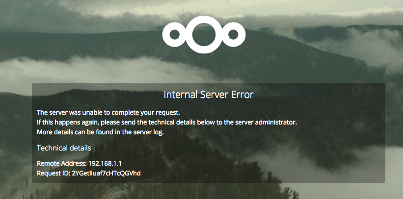

EDIT: Fixed it, saw a post by bengele. I had to sudo chmod 644 custom.cnf and it started working again. Grrr. thanks bengele!
This was working fine forever but just noticed that I'm getting an Internal server error now.
the only thing i may have done is joined my unraid to a domain. I also went to tools/new permissions and fixed permissions after. Any help? Log is clean, I don't
have a clue what to even look for. I was able to initially get the login screen up, so I put in user/pass and then that's when I got the internal error page.
ls -lah /mnt/user
drwxrwxrwx+  1 nobody users  140 Nov  4  2017 Nextcloud/
Heres the error I get when going to nextcloud
Internal Server Error
The server was unable to complete your request.
If this happens again, please send the technical details below to the server administrator.
More details can be found in the server log.
From the docker LOG
Brought to you by linuxserver.io
We gratefully accept donations at:
https://www.linuxserver.io/donate/
GID/UID
User uid: 99
User gid: 100
[cont-init.d] 10-adduser: exited 0.
[cont-init.d] 20-config: executing...
[cont-init.d] 20-config: exited 0.
[cont-init.d] 30-keygen: executing...
using keys found in /config/keys
[cont-init.d] 30-keygen: exited 0.
[cont-init.d] 40-config: executing...
[cont-init.d] 40-config: exited 0.
[cont-init.d] 50-install: executing...
[cont-init.d] 50-install: exited 0.
[cont-init.d] 60-memcache: executing...
[cont-init.d] 60-memcache: exited 0.
[cont-init.d] done.
[services.d] done.
[cont-finish.d] executing container finish scripts...
[cont-finish.d] done.
[s6-finish] syncing disks.
[s6-finish] sending all processes the TERM signal.
[s6-finish] sending all processes the KILL signal and exiting.
[fix-attrs.d] done.
[cont-init.d] 10-adduser: executing...
usermod: no changes
Edited by ffhelllskjdje

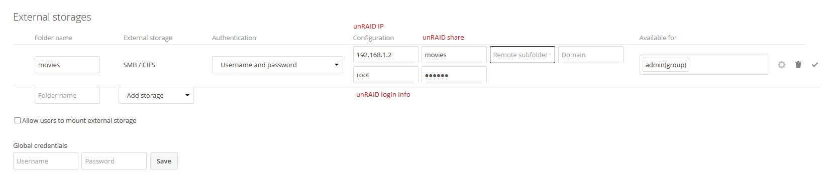

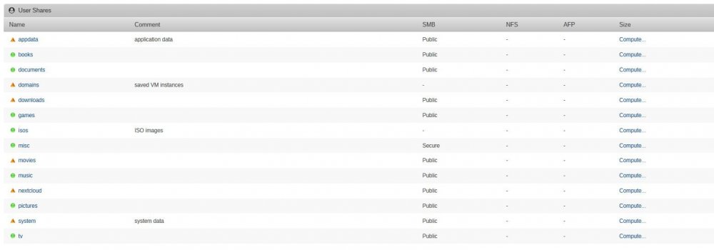

I'm having a hard time adding my unRAID shares to nextcloud.  All of this is on my LAN.  I haven't attempted anything with reverse proxy yet.  I've enabled the 'external storage support' app. I just want to add my 'movies' share to nextcloud.
I get the error:
External mount error
There was an error with message: Empty response from the server. Do you want to review mount point config in admin settings page?
Can anyone please point me in the right direction?
Thank you.
Share this post
Link to post
Hi @DingHo,
I recall from having problems adding external SMB/CIFS shares a while back, that the "Domain" field is, or was, required.
From your screenshot you don't appear to have anything set there.
If you don't have an actual domain, use the Workgroup name used by windows on your network. Defaults to "WORKGROUP".
/Alan.
Edited by aleary
Share this post
Link to post
I get the error:
Thank you.
You can't use root as the user.
Share this post
Link to post
I get the error:
Thank you.
You can add a path /movies to /mnt/user/movies in your nextcloud docker config.
Then in your external storage config, set it up as a local storage with the path of /movies
Share this post
Link to post
@Gog
@aleary
@saarg
Thanks for you kind help.  I was able to get it working.  The 'WORKGROUP' was the key part for me, as I had tried multiple non-root users and mounted /movies in docker previously to no avail.
Thanks again.
Share this post
