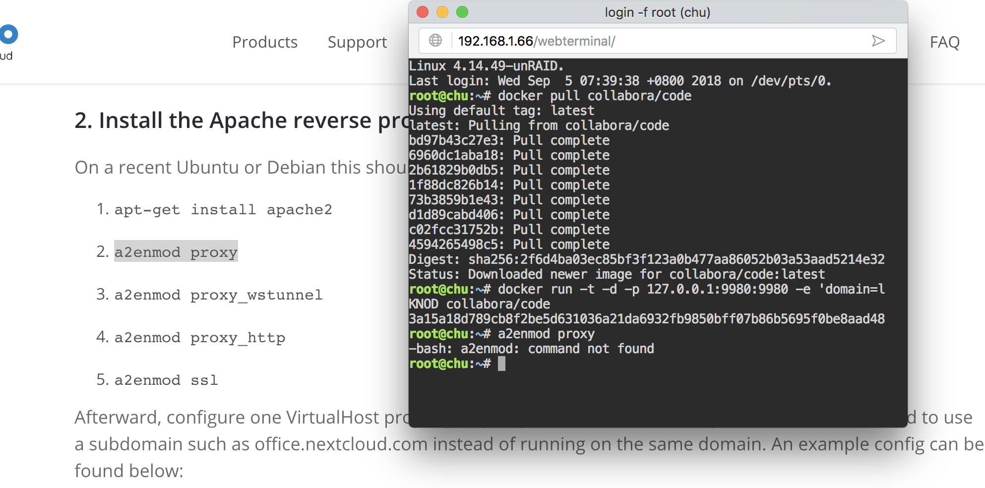

Hi.  Trying to get Collabora working with Nextcloud.  Encountered some error.  Maybe someone got it working?
Don't know what the error's about.
Share this post
Link to post
The error is kind of self explanatory, isn't it? You don't have a2enmod installed.
are you running these commands on unRAID Host? i think, this is wrong, you need to run them with your Apache. Do you have an Apache Docker container?
Share this post
Link to post
Hi.  I opened terminal, and did those commands earlier 🙂  Was a risk for me.  Now I'm thinking if it broke my Unraid, I won't be able to fix it.  I don't have Apache Docker.  I do have letsencrypt docker.  I thought that will have an Apache server.  So I followed instructions from Collabora website, https://nextcloud.com/collaboraonline/, and followed the Video.  It says he has Apache, so he skipped that step.  I thought I have it too.  So I guess I don't.  How did you guys got Collabora working with your Nextcloud?  What's the best way to proceed?
@uldise, I saw on another post that you got Collabora installed by enabling docker-hub search.  I do not see Collabora by CA.
Edited by jang430

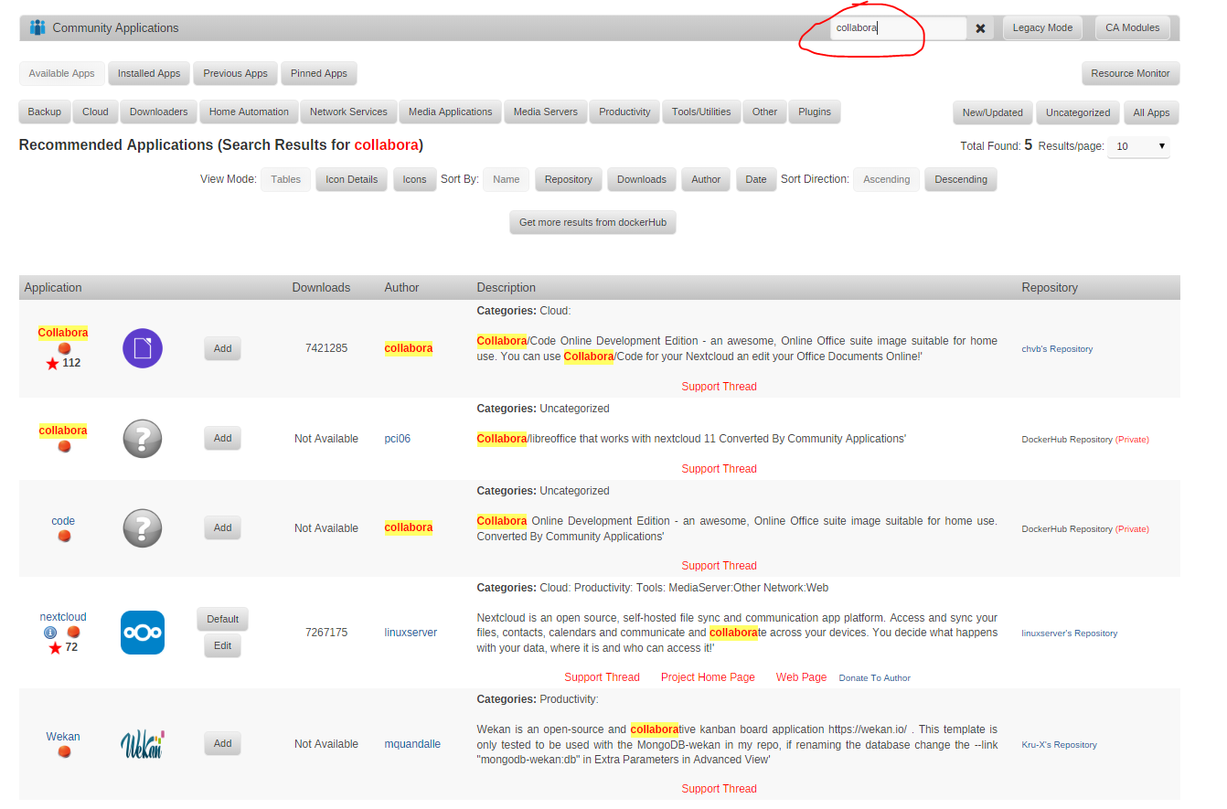

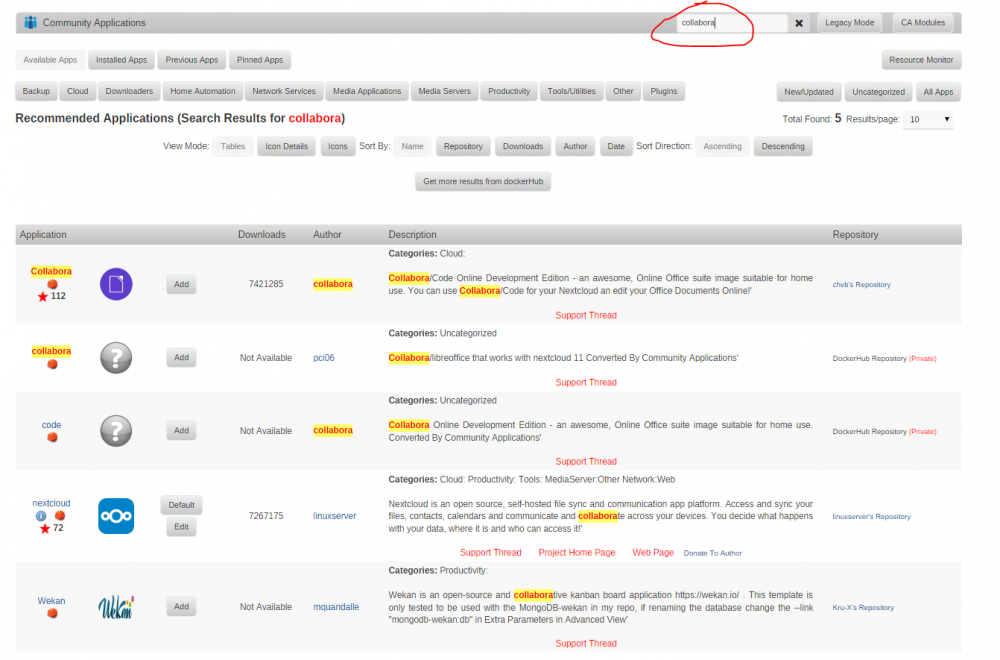

look at image, if you wanna more results, then click "Get more results from Dockerhub" in the middle, but i think you don't wanna that..
Share this post
Link to post
I only see it after clicking get more results from docker-hub.  Will install now.  Don't know next step though.  I followed gridrunner's instructions, and created proxynet as Network Type for the docker.  Shall I also put this on proxynet So they all see each other?

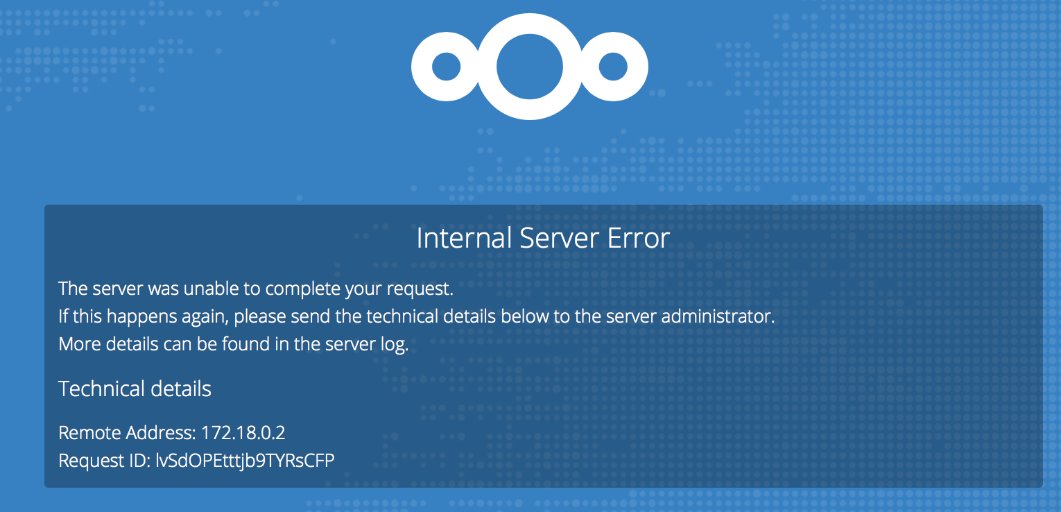

updated Docker and now I am getting this when attempting to log into the WebUI, I have already removed and reinstalled the Docker as 1st step. I am attempting to connect through a VPN currently so i am not sure if that has anything to do with it. It used to work previously but its been a while since i  have needed to log in for anything.
I am not sure which logs i should be looking for to troubleshoot this.
edit: also logged into a machine on my local network (no vpn) and tried from there, same error.

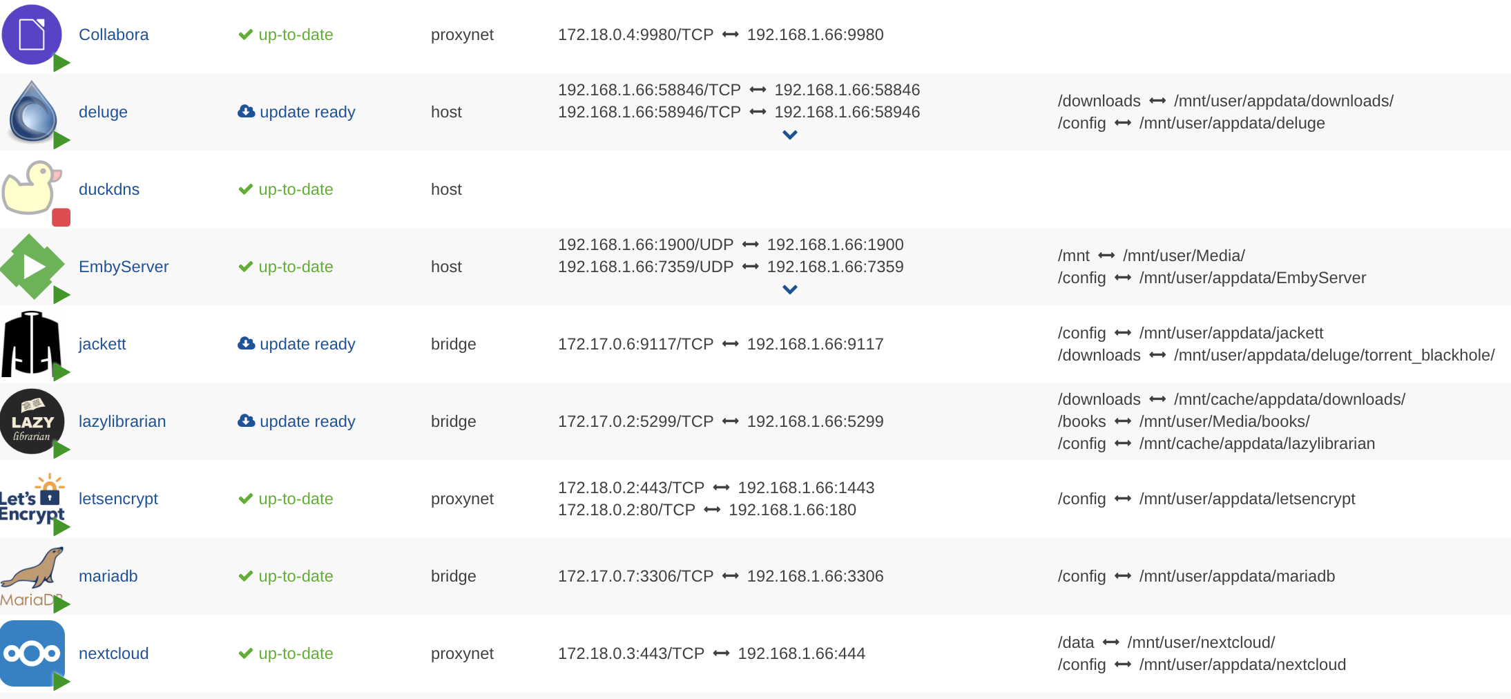

This is how my Docker tab currently looks.  Maybe you can help shed some light how to get Collabora working.
What port settings should be set?
I also went into nextcloud, In settings, collabora online, I had https://xxxoffice.duckdns.org in Collabora Online Server.
I'm running linuxserver.io's letsencrypt and nextcloud docker.  To be able to use letsencrypt with nextcloud, I had to go change some conf files from linuxserver.io.  Do I need to do this here?  Thanks.
i think your port settings is just fine.
first - if you access Nextcloud over https, then Collabora must be on https too.
second - can you sucessfully open https://xxxoffice.duckdns.org from outside? for me, it opens just a blank page, but no error. if no, you should set your reverse proxy to do so.

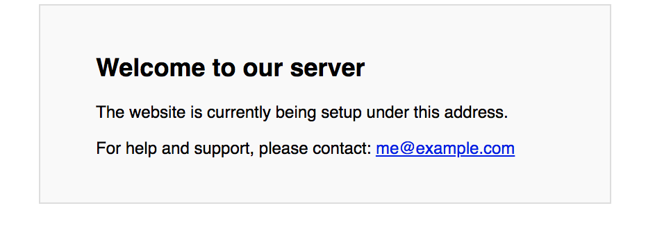

I access nextcloud from outside via https.  I don't know how to get Collabora on https.  I've prepared a subdomain for it, named, xxxoffice.duckdns.org (example only).
When I go to https://xxxoffice.duckdns.org, I reach the following page.  It's supposed to be page from nginx, I think?  Don't know what to do next.
Share this post
Link to post
if you inside your LAN open https://192.168.1.66:9980, what do you get?
as i wrote, i get blank page with small text "OK" in the left upper corner.

4 hours ago, jang430 said:
What does that mean?
i mean, collabora is ok then..
and you have problem with you ngix reverse proxy, cos if you enter https://xxxoffice.duckdns.org, you should see this the same "OK".
sorry, i have no ngix experience at all, i have an Apache as main webserver.
