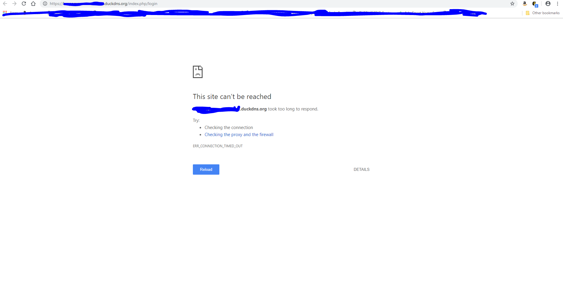

Hi, i have letsencrypt running, server ready.  When i click on webui under docker i get redirected to my subdomain, but it times out. I get this:
my nextcloud config is:
<?php
$CONFIG = array (
  'instanceid' => 'oc2r526nrw27',
  'passwordsalt' => 'jahrU20+WU1udvy0TZpnKPrZhRnNC2',
  'secret' => 'l4iHAz1Fz0pCfZ44QhzzqGwy9gbpKrc8DEsz2uxjZer/+85E',
  'trusted_domains' =>
  array (
    0 => '192.168.7.60:444',
    1 => 'xxx.duckdns.org',
  'datadirectory' => '/data',
  'dbtype' => 'mysql',
  'version' => '14.0.0.19',
  'trusted_proxies' => ['letsencrypt'],
  'overwrite.cli.url' => 'https://xxx.duckdns.org',
  'overwritehost' => 'xxx.duckdns.org',
  'overwriteprotocol' => 'https',
  'dbname' => 'nextcloud',
  'dbhost' => '192.168.7.60',
  'dbport' => '',
  'dbtableprefix' => 'oc_',
  'mysql.utf8mb4' => true,
  'dbuser' => 'glenn',
  'dbpassword' => 'Titan001',
  'installed' => true,
my letsencrypt nextcloud.subdomain.conf file looks like this:
# make sure that your dns has a cname set for nextcloud
# assuming this container is called "letsencrypt", edit your nextcloud container's config
# located at /config/www/nextcloud/config/config.php and add the following lines before the ");":
#  'trusted_proxies' => ['letsencrypt'],
#  'overwrite.cli.url' => 'https://nextcloud.your-domain.com/',
#  'overwritehost' => 'nextcloud.your-domain.com',
#  'overwriteprotocol' => 'https',
# Also don't forget to add your domain name to the trusted domains array. It should look somewhat like this:
#  array (
#    0 => '192.168.0.1:444', # This line may look different on your setup, don't modify it.
#    1 => 'nextcloud.your-domain.com',
server {
    listen 443 ssl;
    server_name nextcloud.*;
    include /config/nginx/ssl.conf;
    client_max_body_size 0;
    location / {
        include /config/nginx/proxy.conf;
        resolver 127.0.0.11 valid=30s;
        set $upstream_nextcloud nextcloud;
        proxy_max_temp_file_size 2048m;
        proxy_pass https://$upstream_nextcloud:443;
Edited by Glenn

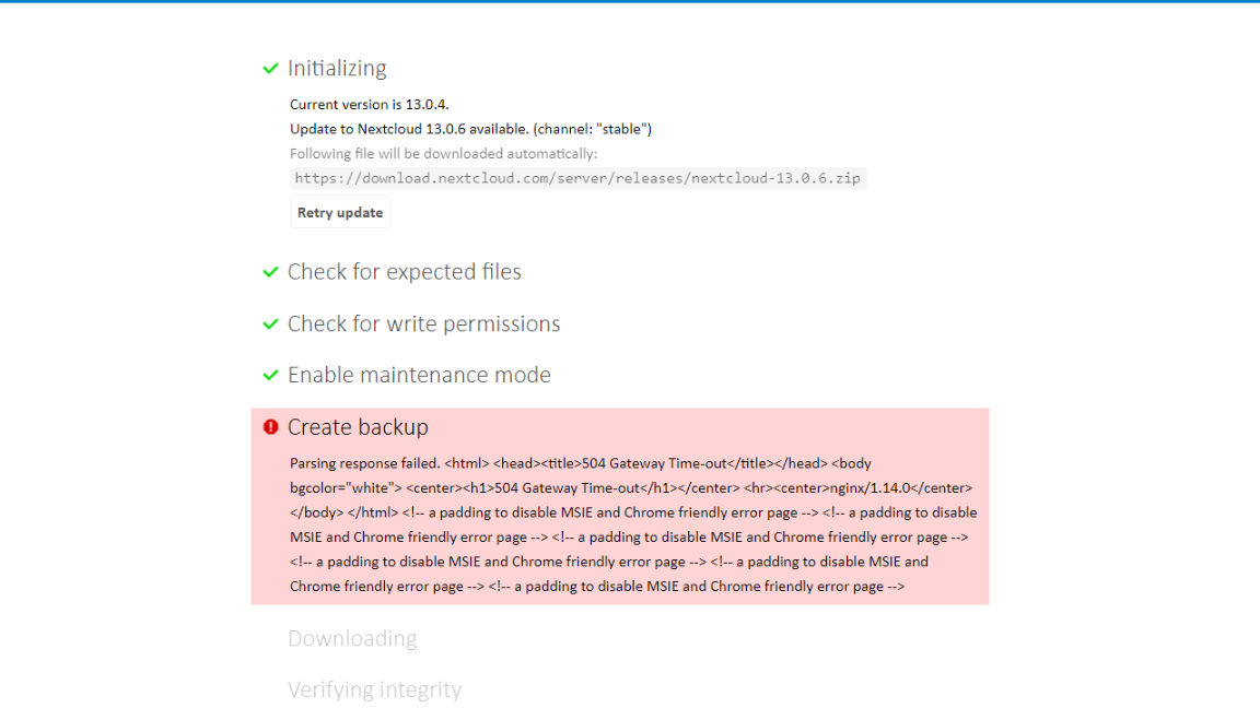

Hi guys!
Haven't been able to update Nextcloud in a while due to this error, any ideas why it appears?
At first, I wasn't able to even see the upgrade screen since I got the "Step 4 is currently in process. Please reload this page later" error.
I found a site that recommends removing the "nextcloud-data/updater-randomstring/.step"-file wich I did and then could proceed. But then this error comes up!
Worth mentioning is that the data folder (including "nextcloud-data/updater-randomstring/.step" ) is on a FreeNAS server. The share is mounted in unRAID (NFS) with the "unassigned drives"-plug in and there's no problem storing and accessing data there otherwise (got all my sh*t there).
Any thoughts?
Link to post
On 9/17/2018 at 8:23 PM, iamnypz said:
Hi guys!
Any thoughts?
imageproxy.php?img=&key=00b562fcac28e727imageproxy.php?img=&key=00b562fcac28e727nextcloud_upgrade_fail.thumb.png.378a34515ceda68bee1a9602c6dfd727.png
Yeah, mount that folder locally to test.
<?php
$CONFIG = array (
  array (
  'dbport' => '',
#  array (
server {
    listen 443 ssl;
    location / {
I'd take a look at the LetsEncrypt log first to see if that's working.
