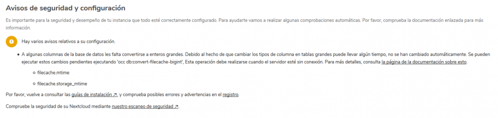

Hi, I just upgrade from 13.x to 14.x to 15.x using the commands in this thread.  Worked great, except for 1 thing.  Now, If I go to parameters, I see those warning, any ideas on how I can fix this ??  Thanks !
There are some warnings regarding your setup.
Some app directories are owned by a different user than the web server one. This may be the case if apps have been installed manually. Check the permissions of the following app directories:
        /config/www/nextcloud/apps/accessibility
        /config/www/nextcloud/apps/activity
        /config/www/nextcloud/apps/admin_audit
        /config/www/nextcloud/apps/cloud_federation_api
        /config/www/nextcloud/apps/comments
        /config/www/nextcloud/apps/dav
        /config/www/nextcloud/apps/encryption
        /config/www/nextcloud/apps/federatedfilesharing
        /config/www/nextcloud/apps/federation
        /config/www/nextcloud/apps/files
        /config/www/nextcloud/apps/files_external
        /config/www/nextcloud/apps/files_pdfviewer
        /config/www/nextcloud/apps/files_sharing
        /config/www/nextcloud/apps/files_texteditor
        /config/www/nextcloud/apps/files_trashbin
        /config/www/nextcloud/apps/files_versions
        /config/www/nextcloud/apps/files_videoplayer
        /config/www/nextcloud/apps/firstrunwizard
        /config/www/nextcloud/apps/gallery
        /config/www/nextcloud/apps/logreader
        /config/www/nextcloud/apps/lookup_server_connector
        /config/www/nextcloud/apps/nextcloud_announcements
        /config/www/nextcloud/apps/notifications
        /config/www/nextcloud/apps/oauth2
        /config/www/nextcloud/apps/password_policy
        /config/www/nextcloud/apps/provisioning_api
        /config/www/nextcloud/apps/serverinfo
        /config/www/nextcloud/apps/sharebymail
        /config/www/nextcloud/apps/support
        /config/www/nextcloud/apps/survey_client
        /config/www/nextcloud/apps/systemtags
        /config/www/nextcloud/apps/theming
        /config/www/nextcloud/apps/twofactor_backupcodes
        /config/www/nextcloud/apps/updatenotification
        /config/www/nextcloud/apps/user_external
        /config/www/nextcloud/apps/user_ldap
        /config/www/nextcloud/apps/workflowengine
The "X-Frame-Options" HTTP header is not set to "SAMEORIGIN". This is a potential security or privacy risk, as it is recommended to adjust this setting accordingly.
The database is missing some indexes. Due to the fact that adding indexes on big tables could take some time they were not added automatically. By running "occ db:add-missing-indices" those missing indexes could be added manually while the instance keeps running. Once the indexes are added queries to those tables are usually much faster.
        Missing index "share_with_index" in table "oc_share".
        Missing index "parent_index" in table "oc_share".
        Missing index "owner_index" in table "oc_share".
        Missing index "initiator_index" in table "oc_share".
        Missing index "fs_mtime" in table "oc_filecache".
This instance is missing some recommended PHP modules. For improved performance and better compatibility it is highly recommended to install them.
        imagick
Some columns in the database are missing a conversion to big int. Due to the fact that changing column types on big tables could take some time they were not changed automatically. By running 'occ db:convert-filecache-bigint' those pending changes could be applied manually. This operation needs to be made while the instance is offline. For further details read the documentation page about this.
        activity.activity_id
        activity.object_id
        activity_mq.mail_id
        filecache.fileid
        filecache.storage
        filecache.parent
        filecache.mimetype
        filecache.mimepart
        filecache.mtime
        filecache.storage_mtime
        mimetypes.id
        storages.numeric_id
The "Referrer-Policy" HTTP header is not set to "no-referrer", "no-referrer-when-downgrade", "strict-origin", "strict-origin-when-cross-origin" or "same-origin". This can leak referer information. See the W3C Recommendation ↗.
Share this post

I have done a fresh install following spaceinvaders video and I get the following error
how can I apply this fix in the docker container? occ db:convert-filecache-bigint
