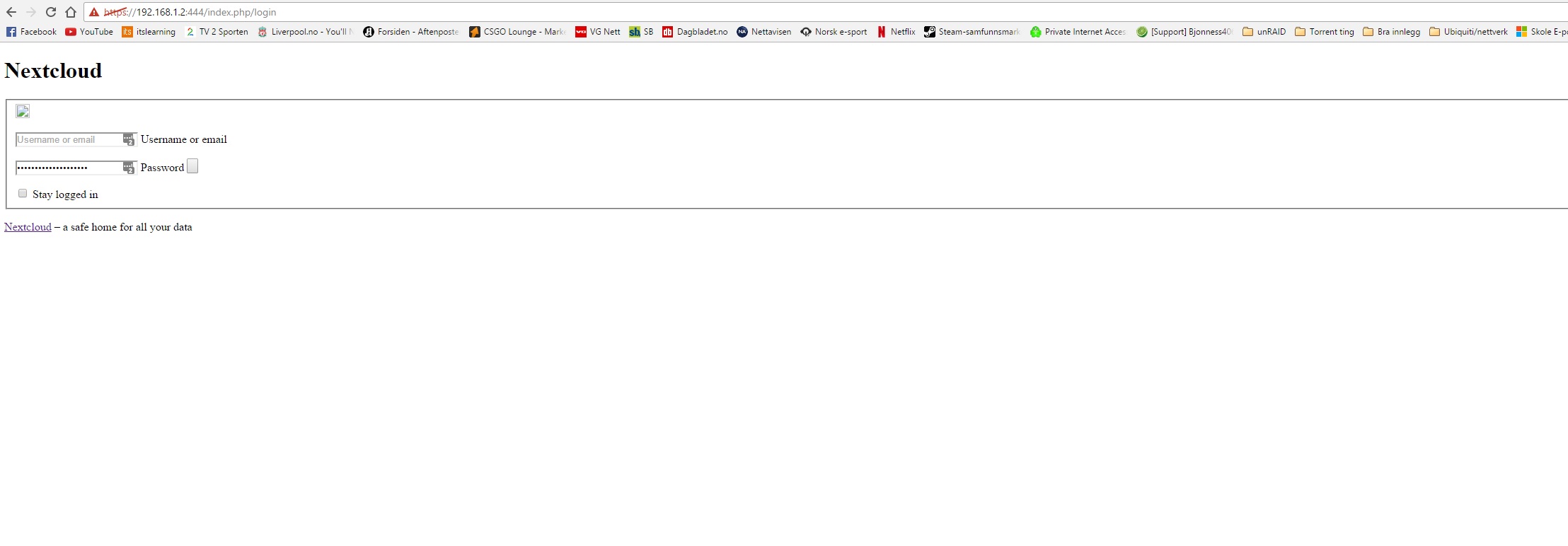

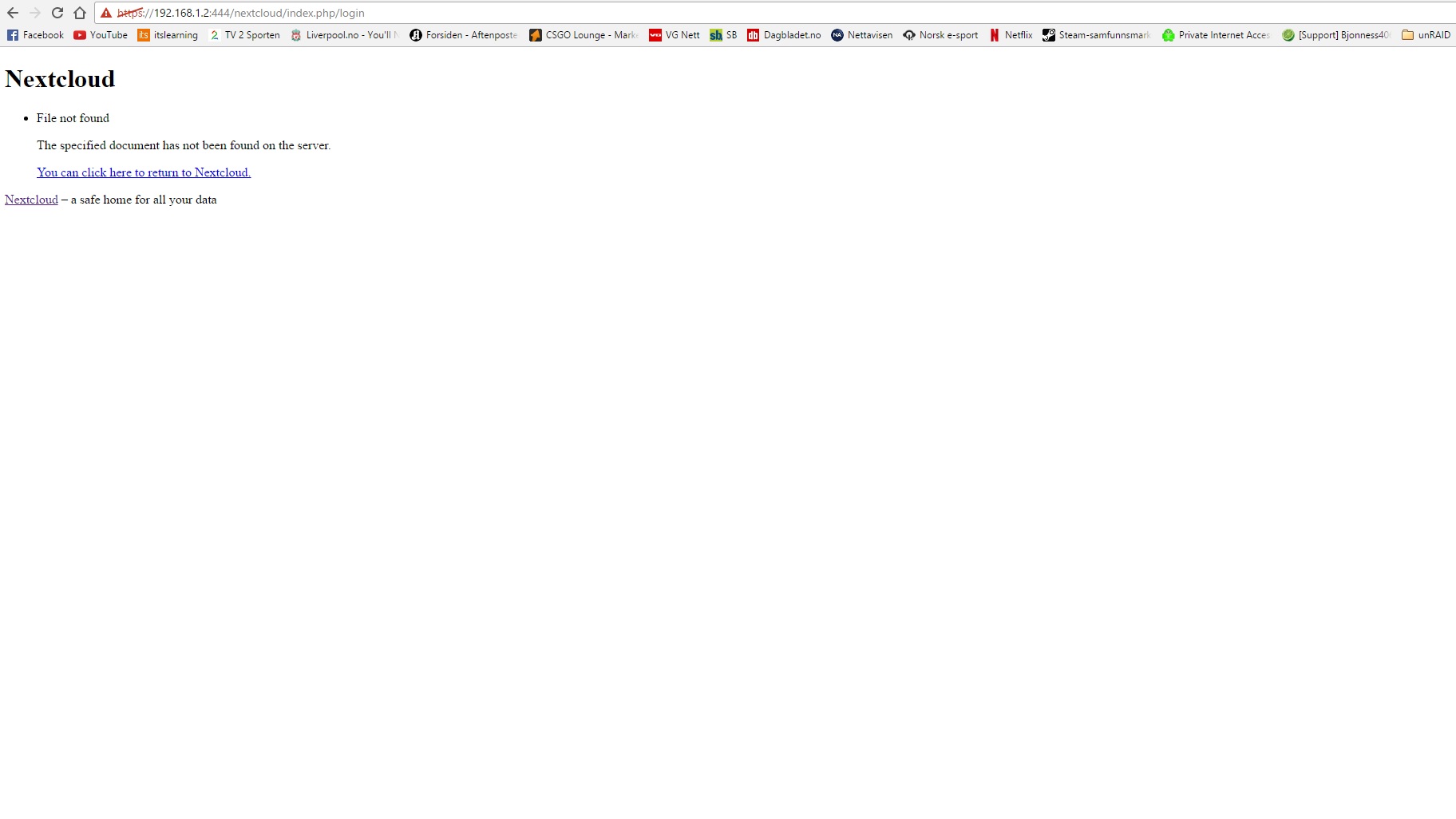

Bjonness406, well something ain't quite right.  Unfortunately that screenshot isn't terribly helpful in working out where you've gone wrong, especially as you haven't posted your config.php....
Sorry!
Sorry!

Can you access the webui from https://192.168.1.2:444/index.php/login
And can you clarify which "version" of the reverse proxy you're using?
Getting somewhere longer, but not loading entirely.
Accessing it from the reverse proxy is working fine.

OK, that's cleared it up.  The problem isn't anything to do with the reverse proxy, more to do with the fact that config.php doesn't "match" the way the container is setup via it's internal nginx config.
Essentially getting all this working there are three variables:
[*]nginx:  /config/www/nextcloud/config/config.php
[*]nginx:  /config/nginx/site-confs/default (I left this well alone during my write up
[*]Apache: /config/apache/site-confs/default.conf
Quick bit of testing and I found this worked for me, change line 30 of /config/nginx/site-confs/default  from
root/config/www/nextcloud/;
to
root /config/www;

After all of this, I'm able to get access on the Nextcloud android app with my server set to "https://cloud.example.com"
Thanks for sharing the config, but I want to have "mydomain.com/nextcloud" since I am not able to get "cloud.domain.com" (I am using a free address from No-IP).
Android app working fine for me via my Apache reverse proxy using SSL.  I have my own domain name and am using ddclient as a dynamic DNS updater.
Hmm.. Do you use domain.com/nextcloud or nextcloud.domain.com?
nextcloud.server.com
Yeah, but I posted two versions of config.php,
One for https://server.com/nextcloud
one for https://nextcloud.server.com
And you appear to have bits of both in yours.....
I think you misunderstand.
My server address is "myserver.ddns.net", then I want to have nextcloud at "myserver.ddns.net/nextcloud".
The reason I don't have "myserver.net" is because this is a free dns name I got from no-ip, and then is adds the "ddns.net" part after my server name.
If there is anything I have missed, please tell me ;)
to
root /config/www;
