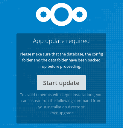

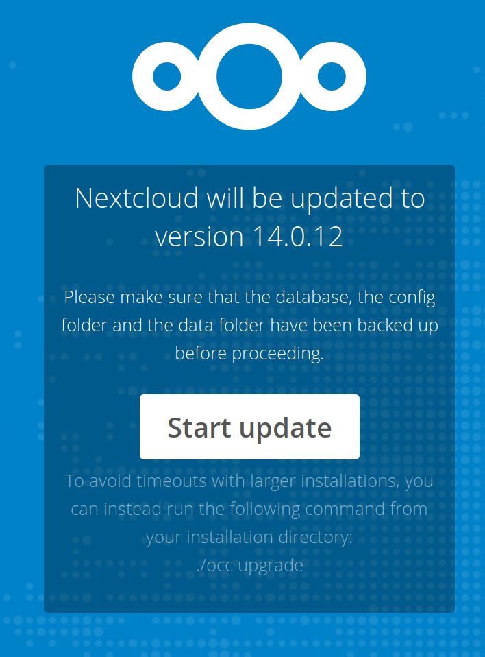

I tried to delete the nextcloud folder in the appdata and reinstall nextcloud, but I keep getting this update request.
I tried to use the appdata from last week and still the same. Even the tag linuxserver/nextcloud:16.0.1-ls22 does work anymore.
EDIT:
Here is the output if I tried to upgrade:
root@eb3e790334f8:/# sudo -u abc php7 /config/www/nextcloud/occ upgrade
Nextcloud or one of the apps require upgrade - only a limited number of commands are available
You may use your browser or the occ upgrade command to do the upgrade

13 hours ago, antindragonslayer said:
Go to settings for your Nextcloud docker. Change repository from "linuxserver/nextcloud" to "linuxserver/nextcloud:16.0.1-ls22"
That downgrades your docker.
Next step would be to update Nextcloud from the nextcloud admin GUI. Do it step by step. Worked great for me!
I tried that but it fails so any anything else
Set log level to debug
Turned on maintenance mode
Updating database schema
Updated database
Updating <federatedfilesharing> ...
Doctrine\DBAL\Exception\TableNotFoundException: An exception occurred while executing 'SELECT `class` FROM `oc_admin_settings` WHERE `class` = ? LIMIT 1' with params ["OCA\\FederatedFileSharing\\Settings\\Admin"]:
SQLSTATE[42S02]: Base table or view not found: 1146 Table 'nextcloud.oc_admin_settings' doesn't exist
Update failed
Maintenance mode is kept active
Reset log level
Deleting your appdata wasn't a smart move. Unless you have a backup, there is no return now.
I would just start fresh.
Did you try updating through command line?
Yes, I tried updating through cli then UI with the same error.
