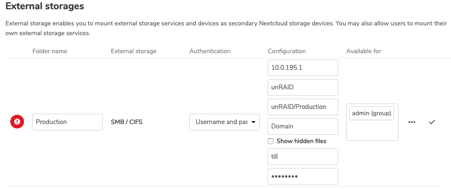

Ok, since I didn't get any responses to my question above, I ended up deleting and re-installing the Nextcloud Docker into its own subfolder, and it all seems to work as intended so far, so that part of my question is now solved.
But even after following along to various instructions given in  online videos and forum threads, what I am still stuck on is properly configuring the "External storage" feature to point to my unRAID user share (or any of its sub-folders)...I have tried "Local", and "SMB/CIFS" unsuccessfully...after clicking the checkmark on the right, the icon to the left of the folder name field spins, initially, but always results in the red exclamation mark icon.
What am I doing wrong?
you wanna just attach your Local unraid folder to nextcloud? then first, you need to map you unraid folder to docker path in your Nextcloud docker settings. Second, use "Local" storage and point it to mapped path inside docker container.
Thanks for that instruction, uldise, but as easy as that may be for you, I still struggle very much with the correct syntax of how (and where exactly) paths like that are added and referenced...

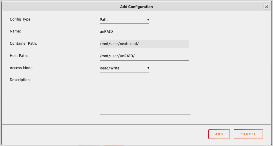

So, as for "map you unraid folder to docker path in your Nextcloud docker settings.", I would need to use the "+Add another Path..." link at the bottom and add it there? I have been there before and tried my luck, but was confused about the difference between the "Container Path" and "Host Path" fields...my unRAID user share lives at /mnt/user/unRAID, so that goes into the "Host Path" field, I take it, since one can actually select  it with the shown directory structure that pops up? if that is correct, then what goes into the "Container Path"? The Nextcloud container path? (which would be /mnt/user/nextcloud/)
Once I filled that in correctly, I can move on to the second part of your instructions, which I am also somewhat confused about.
To add to my confusion, when I last tried these instructions, which I also found somewhere else, on reddit maybe, and I added those paths (probably incorrectly) and hit "Add", the Docker showed me some verbose feedback of restarting  itself with these new settings, and then disappeared entirely...gone, even from the Dashboard, leading me to having to re-install it from scratch.
Edited by tillkrueger
addition - syntax correction
Before I hit "Add" and lose my Docker again, would this be correct?
Host path is correct, but Container path not. set container path for example /data2
and then on second part of previous instruction, add Local storage and choose /data2 as Location.
Ok, I used /Data in the Container path field, hit "Add", and verbose mode announced the successful addition.
Then, in the "External storage" settings, I entered "Data" into the "Folder name" field, set "External storage" to "Local", "Authentication" to "None", "Configuration" to "/Data", and "Available for" to allow only "admins" for now,  since I am the only user of this system, for now.
I also enabled "Allow users to mount external storage", the clicked the checkmark, and...got a green checkmark for the first time!! 😄
And lo and behold, inside of my Nextcloud "All files" section, I now see "Data" and all of my unRAID folders inside of it.
Brilliant, uldise, you just made my week!
