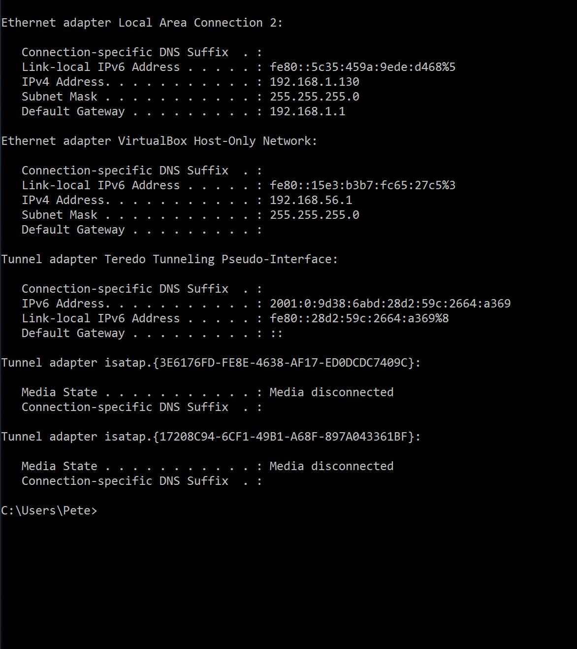

I booted up the machine on 6.1.3  all the drives LEDS came up and I ran IPCONFIG to ascertain the address  and it said not connected ? all the drive LEDS then go out except the parity drive. I have attached screen shot of IPCONFIG. I can here the beep from the box.
I dont know why i cant get the Ip adddress why would it say offline when its clearly plugged in. Im not to great with this stuff so am I going to be better to bite the bullit here and completely reinstall 6.1.9 if thats the case some guidence in that would be really very welcome.

This does state that it is connected to the network and has a local IP address of 192.168.1.130
That's ipconfig his windows box. Dunno why he posted that. What we need is the ifconfig from the local console of the unraid box.
