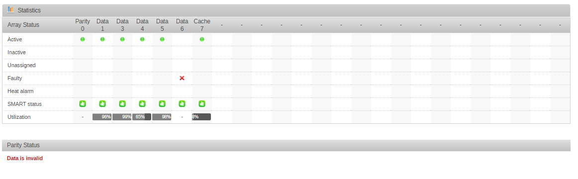

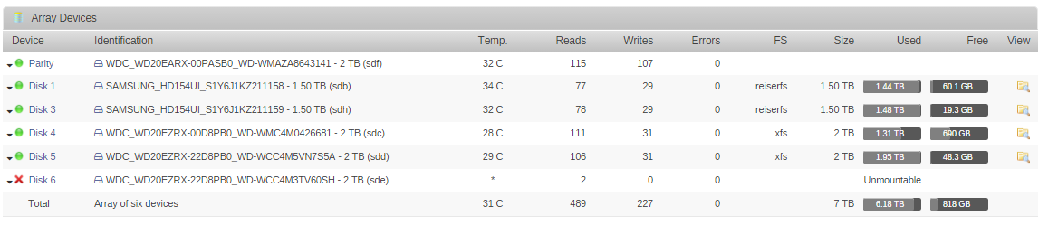

After i removed a disk from the array and created a new config (whiles following the steps provided by unraid) I saw that one of my drives had the status "Unmountable". After a bit of googling I ran into a post (here on the unraid forum) suggesting to run xfs_repair -v. Xfs_repair didnt work sadly enough and now i dont really know the best way to resolve this issue.
The disk that is currently having issues is disk 6.

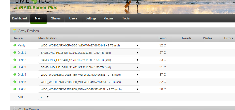

Yes i am sure, i took a screenshot of the disk layout before creating the new config.

Disk 6 became disabled after setting up the new config. I could assign all the disk with no problem and it was still up then but after setting the new config up the disk became disabled. I will try the steps you provided and report back once it is done.
