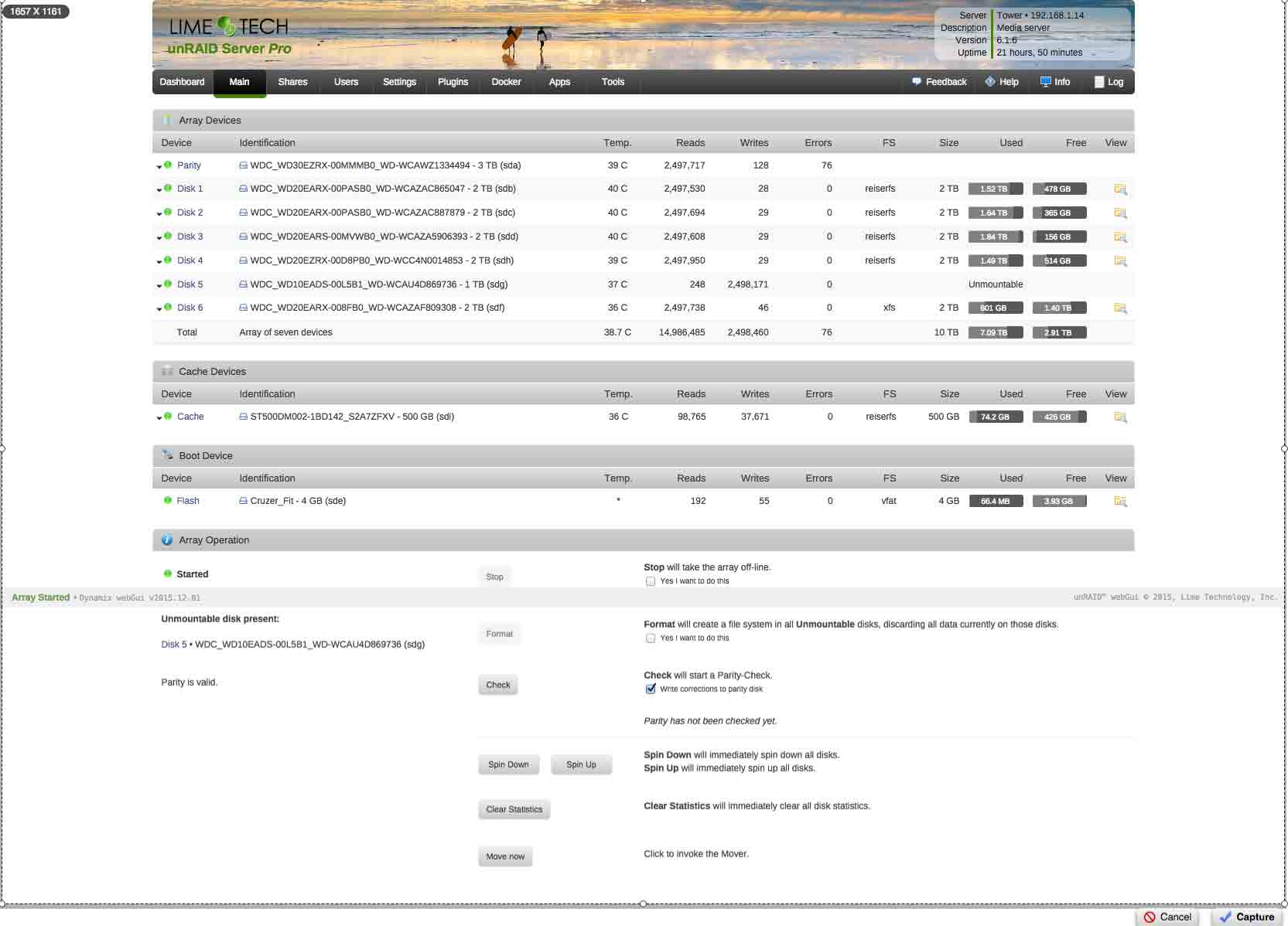

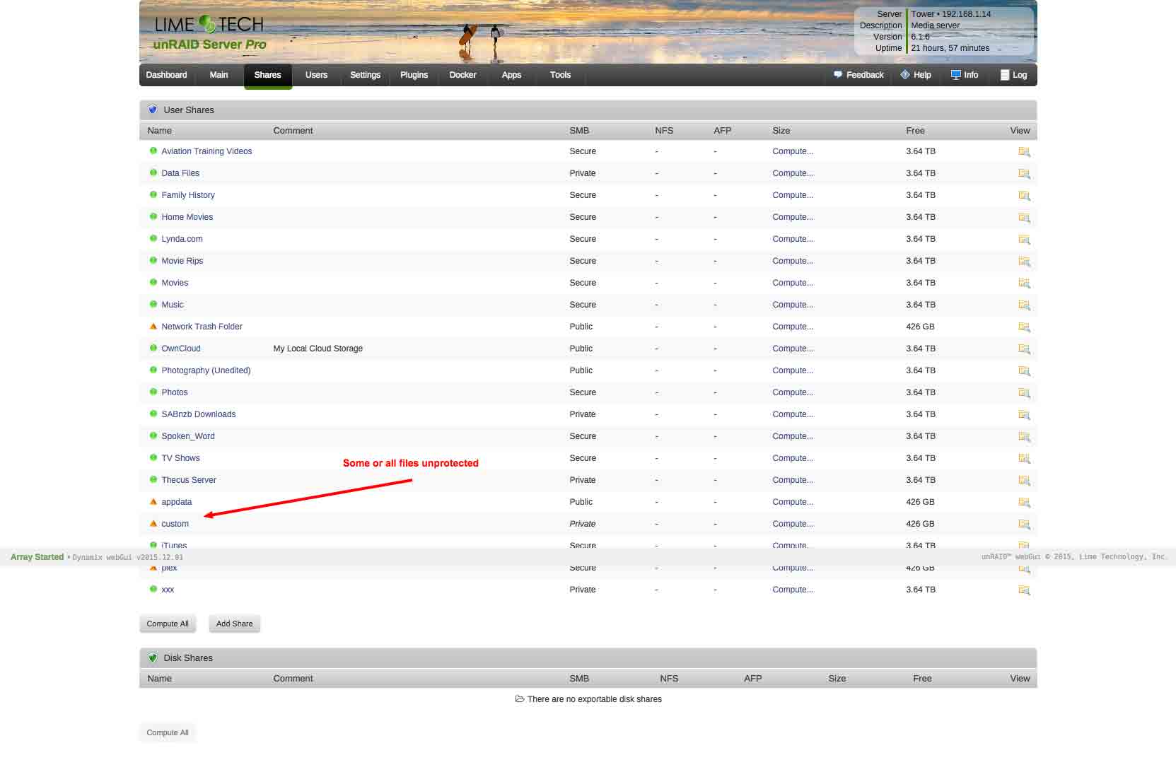

July 7, 201610 yr Hi I may have a similar problem. My disk 5 is showing as unmountable. I changed it to another (non blank) disk from a redundant Thecus NAS but it still came up as unmountable. I then precleared the disk overnight and tried again this morning. It is still showing as unmountable. However, the disk is showing up green on the Main page (see attached image) but I am getting warnings on the Shares page that some files are unprotected. Other issues I am up against are that I cannot stop the array. I have to run the powerdown script. Also I cannot format the unmountable drive. Both this option and the stop array option are ignored. Given that this is the second disk that has the same problem in the same slot, do you think it could be a hardware issue? I am at a loss as to what to do next. Any help would be much appreciated. Syslog_Jul_06.txt

July 8, 201610 yr Author Thanks This is all I am getting now. To be clear I just clicked the check button with no optional switches.

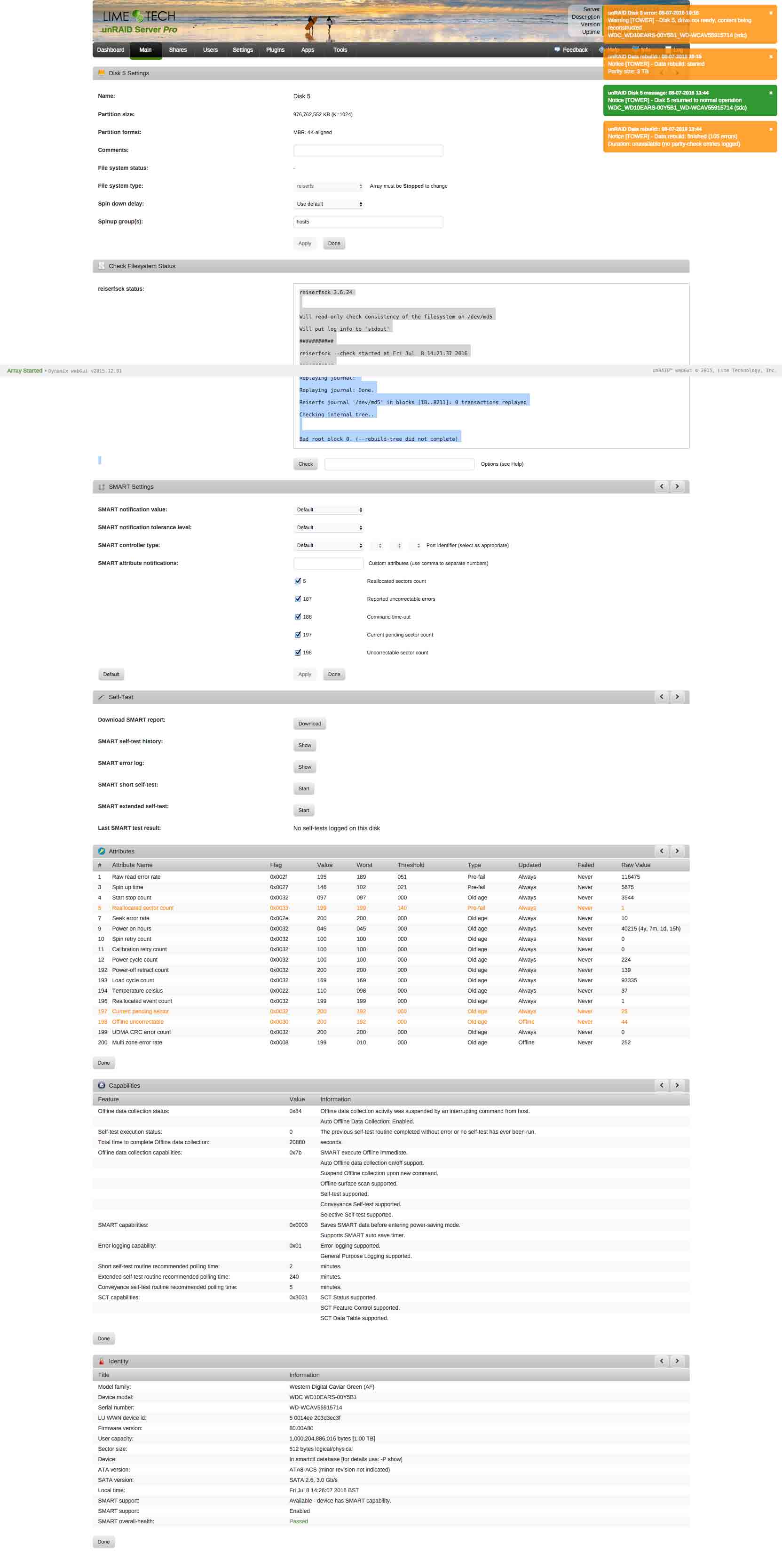

July 8, 201610 yr Your current Disk 5 has 2 serious problems, file system corruption and bad sectors. File system issues can't be dealt with if there are sector issues, so those have to be cleaned up first. I noticed that this Disk 5 (WD10EARS...5714) is not the same as the first Disk 5 (WD10EADS...9736). This Disk 5 has at least 25 questionable sectors, so it must not be the drive you Precleared (I assume the Preclear was successful?). You have a choice - unassign this one and Preclear it 2 or 3 times then reassign it, or grab another that you know is good (check its SMART report to make sure its clean) and assign it instead. The next problem is that Parity has issues, so it may need repair, AND it may not be sufficiently valid for rebuilding Disk 5. Please provide its SMART report. Once the Parity drive is as good as we'll be able to get it (and assuming it's still valid), then you can rebuild Disk 5. Once it's rebuilt, then you will need to check its file system, and proceed accordingly. Are you sure it's formatted as ReiserFS? I see another drive formatted as XFS. Using the wrong repair tool can make things worse. Is there any chance you have the original Disk 5, untouched, even if it has issues? It's possible we may need to go back to it for data recovery, if parity can't be used.
July 8, 201610 yr Author Hi Rob Phew, you don't miss much do you! I have fiddled with three disks and the one I precleared was one I didn't mind losing data on. In fact I am currently using it to copy my most sensitive data to in case things go seriously Tom Tit. The original Disk 5 is WD10EARS...5714 and is currently back in the array but is, of course, unmountable. I have been trying to protect the data on this disk as much as possible. I was hoping that if I pre-cleared a fresh disk and assigned it, then parity would do its job and rebuild the data but, for reasons I still don't understand, I cannot mount any disk in slot 5. I will choose a fresh disk and preclear it overnight and tomorrow. (Unfortunately I have to go to Hong Kong for a few days tomorrow evening, so will have to pause if it cannot be fixed in time). With regards to the Parity drive, I attach it's SMART Report If I use a fresh disk, I can format it with reiserfs, can't I. I don't 100% know the original disk 5's file system but the indication is that it is reiserfs. Can we interrogate it later, to find out? Very many thanks for all your help. tower-smart-report-parity-disk.zip
