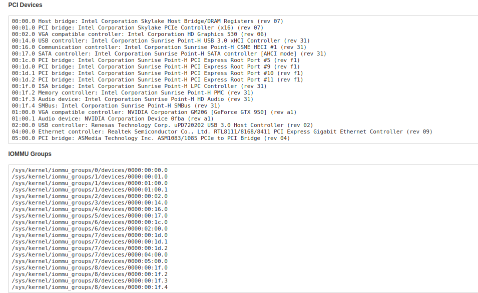

As you can see from the attached screenshots, both xHCI controllers are now listed under the system devices and they are in separate IOMMU groups. Sounds like everything should work this time.
Unfortunately in the webGUI dialog to create a new VM there is no entry for any USB controller anymore. Previously I could select either the EHCI or XCHI controller (both being the onboard one).

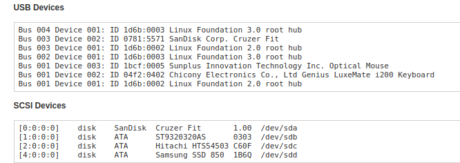

Reading the announcement post for 6.2 beta 18 I tried to stub the PCIe USB controller.
Unfortunately there is no vendor/product ID in brackets in the lines under system devices (see Screenshot).
I ended up using the ID found under USB devices (1d6b:0003) to identify the PCIe USB controller and made the entry for the boot menu.
Nothing changed. I still don't get any entries for any of the two xHCI controllers in the create VM dialog.

Please find screenshots of system devices attached.

6.1.9 doesn't list them.  From command line issue "lspci -nn" and you will get a similar display to 6.2 does and then you can stub your device.
